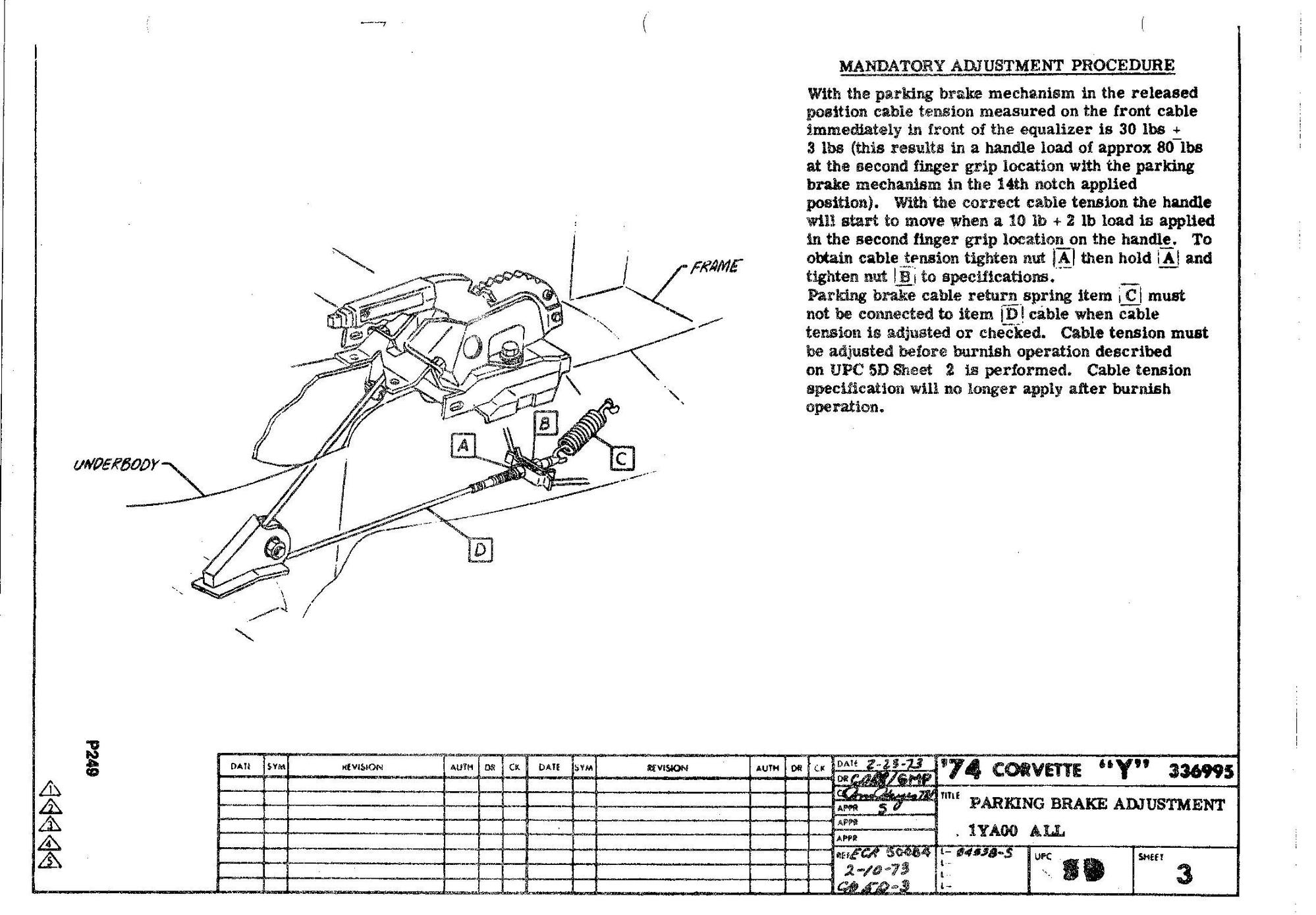

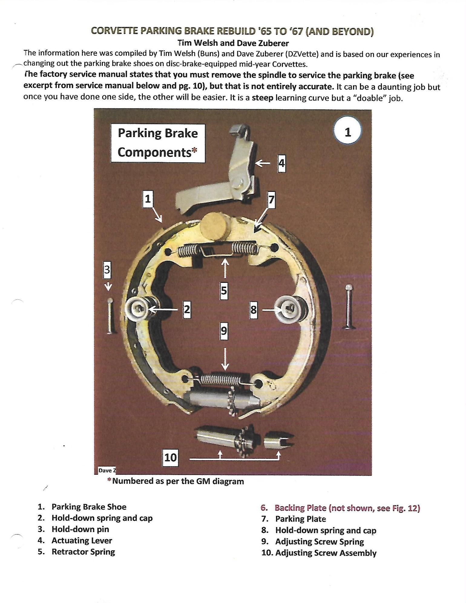

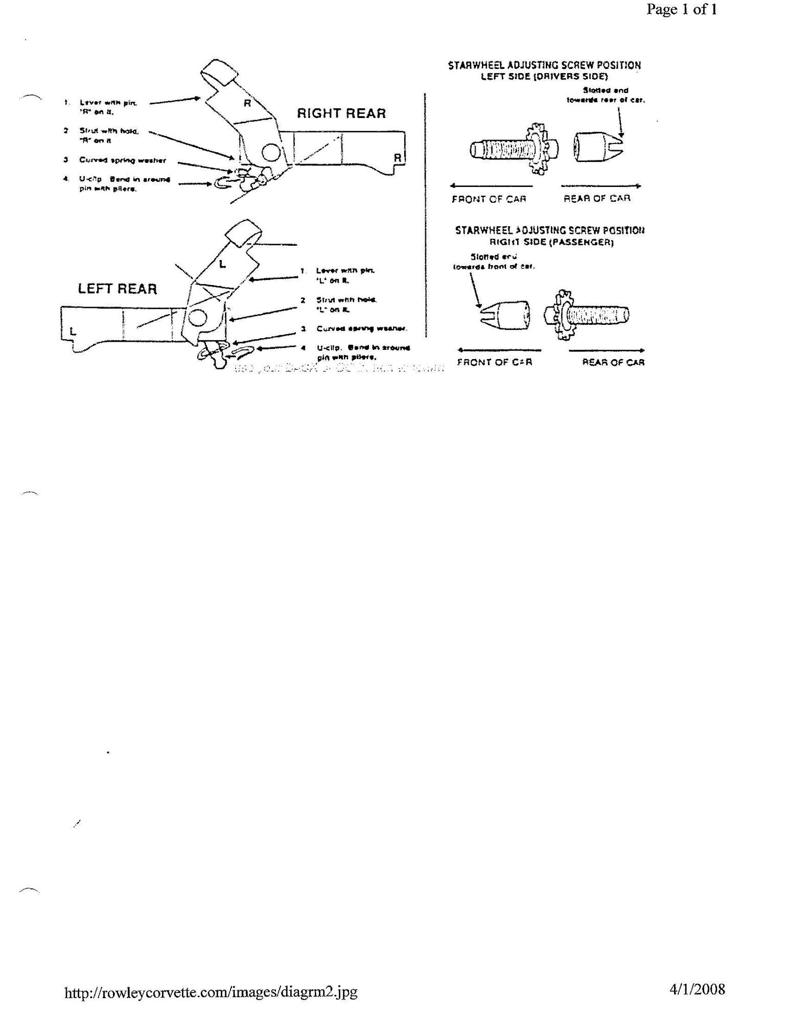

Remove the caliper and rotor and compare what you see to the pictures.
Final adjustment is at the parking brake handle.
