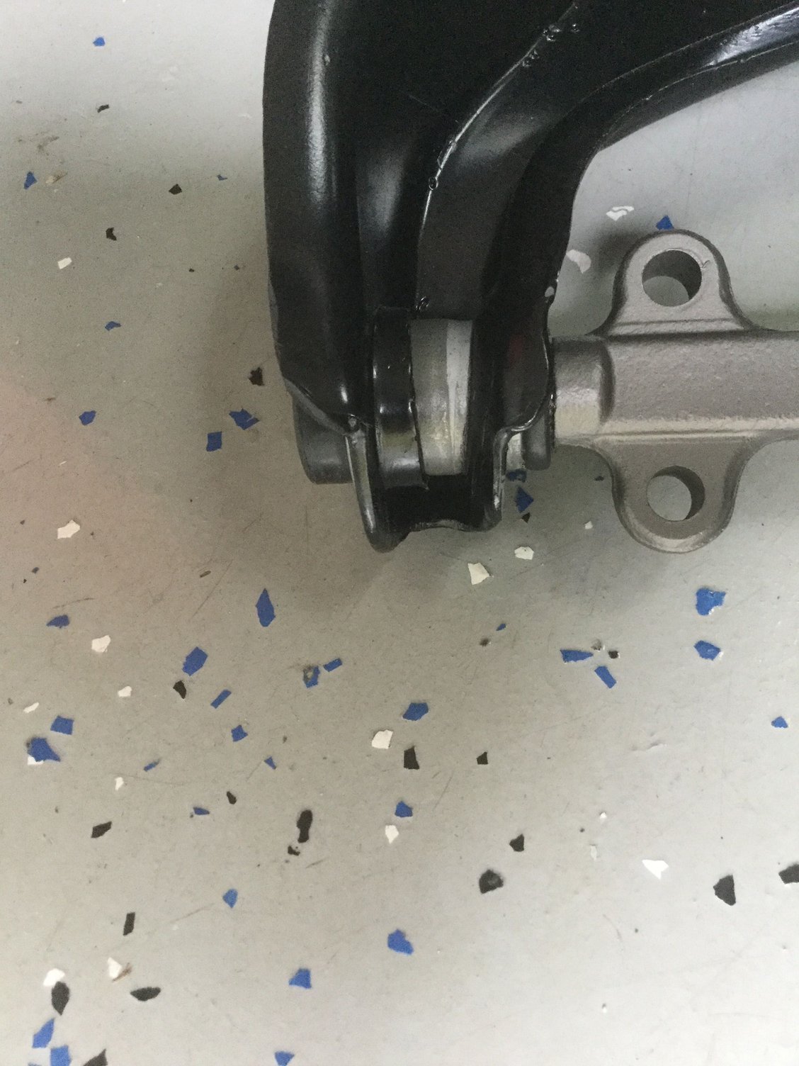

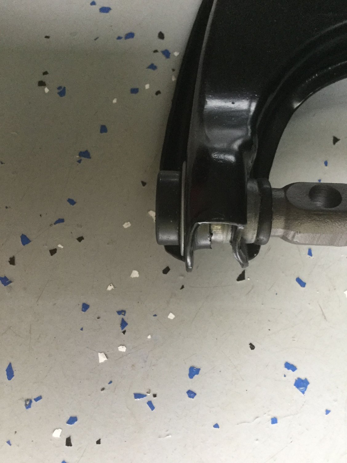

Took lower control arm to local shop to have them pressed in. Rubber replacement - not poly.
Anyway, they are not fully flush with the control arm. The outside flange on both sides is bent to #$@&. The inside bushing is barely showing in the lip of the inside of the control arm.
Question is if they are seated well enough, or am I looking at a potential problem?
Hard to see, the the lip of the bushing is just on the inside of the lip of the inner control arm.
Shows the suspect bushing. Note how the flange of the bushing sleeve is caved in.
This one seems OK, even though it isn't fully seated.

It looks like the shop allowed an amateur to do this job. The most difficult part of pressing out the old and in the new bushing, is to not damage the control arms. It takes practice or experience with using a press to do it without damaging them.
Since you're in Tampa, I'd take them to Vansteel (12285 West Street, Clearwater) and ask their opinion. Best case they will tell you they are okay, worst case they recommend redoing them. The good news is they're some of the best in the industry and they're pretty close to you. They're great folks to work with and if you haven't met and talked with them yet, I think you'll want to get to know them.
Good luck... GUSTO

Crappy job. arms look bent to me as well.

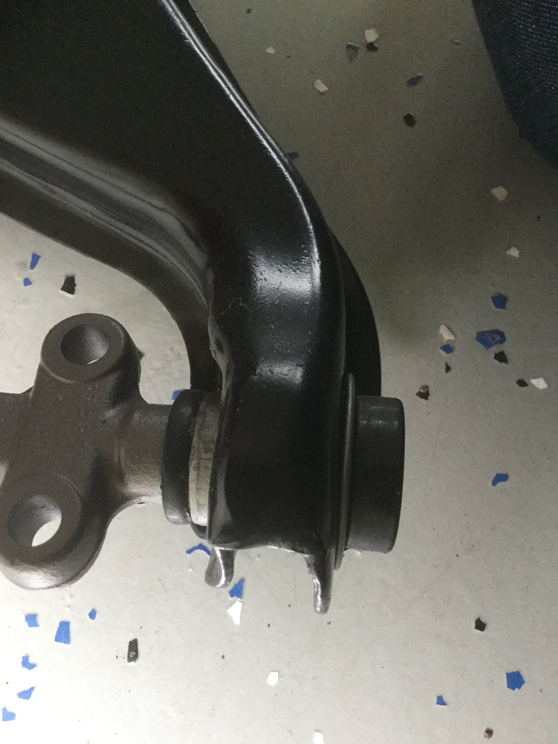

I would say those are not properly installed. I did my own, Moog rubber bushings.
Bushing flange should be flush against control arm.

Well pretty much ruined those. Does the shaft still turn? it should be fairly snug but not tight enough that you can't turn it

Yes shaft does turn.

The installer should have proper jigs/tools to fit the outside properly while not pressing directly on the arms, and should be using spacers in the center of the arms to keep from bending the basic shape of the arms. I agree they are not correct, and if the flanges are bent you shouldn't have expected to pay for them or accept them as usable. Pretty critical part of the front end. It appears they may have supported the inside of each end of the arm and forced or hammered them in. I would take them in somewhere else and get their opinion / have them fixed or reworked. They should look like the photos posted by aerofix.

That is the exact tool I used ronarndt. And as Joe Minnesota pointed out, I fabricated and used spacers between the flanges to prevent them from being bent.

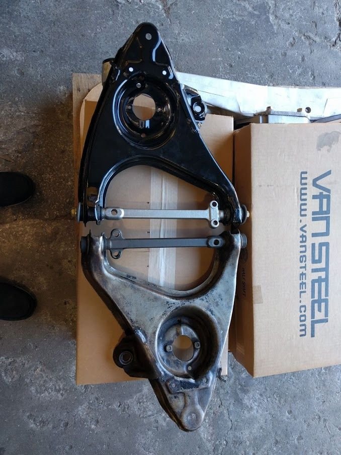

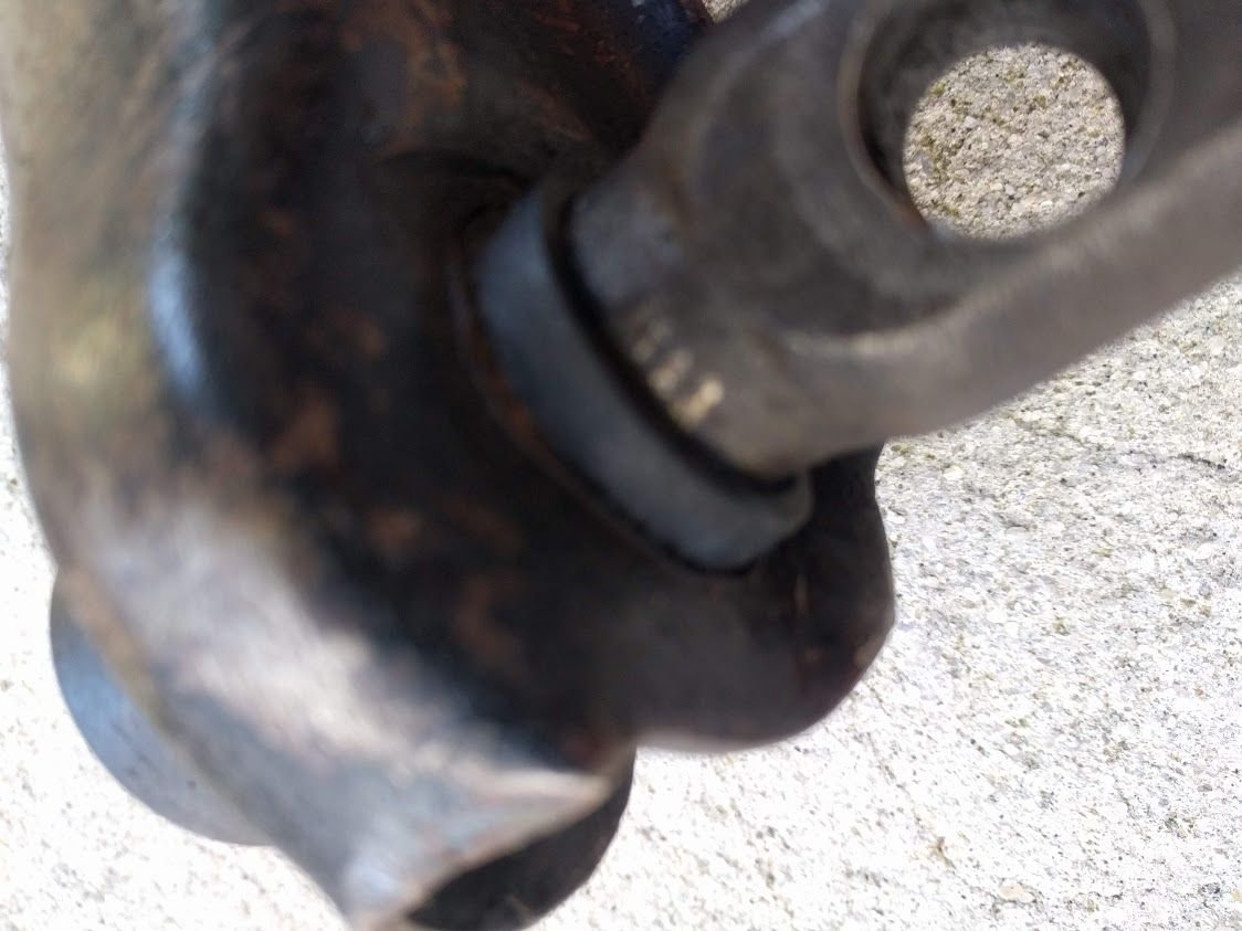

Went to Vansteel. Just an FYI, the lower arms very often are bent just from hitting stuff while driving. In my case, the arm was at least a quarter inch bent in, most likely from some PO hitting a curb stop or something like a rock, etc.
Dan has a template he uses to measure the arm gaps, etc. I had him make me a copy that I can use when I get around to removing the other side.
In any event, it is possible that the thing was bent before I took it in, or maybe the shop bent it during the process, that point is rather moot. As far as the tool and pressing them out / in, Vansteel hammers them in. They don't use a press or tool at all. Been doing it that way for many years.
Here's a picture of my bent arm lined up (sort of) with the replacement from Vansteel.
I haven't dropped the right side yet. So I don't yet know what I'm in for. At least I have some aid now that will let me know if my other arm is bent or not before I start working on it.

Default picture old vs new

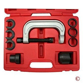

I bought this and it's so easy!!!!!!!
Hope this helps
Russ
Old Feb 15, 2020 | 08:12 PM
Rob Via's Avatar
Rob Via
Joined: Feb 2020
Posts: 723
Likes: 71
From: Kannapolis NC
Looking at this tool, I don't see how it work for the lower control arm on the side with 2 bolts instead of 1. I also saw somewhere a list of cars it was for and it listed chevelles and camaros but not corvettes. Did you use this tool on the lower control arm? I have everything off the car and am replacing all the rubber. This is stumping me. I got the tool from advance and it worked for the upper, but not the lower.
