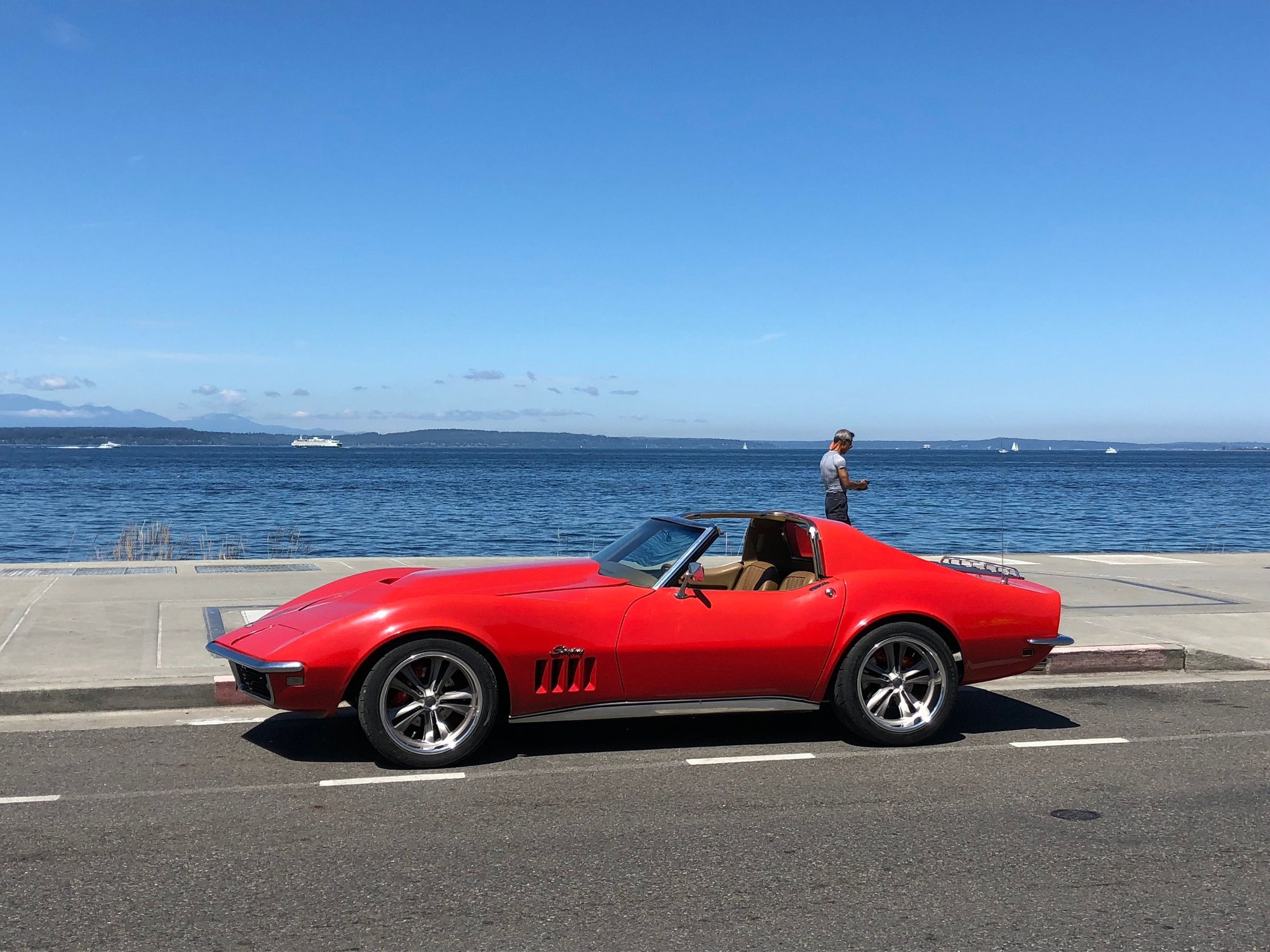

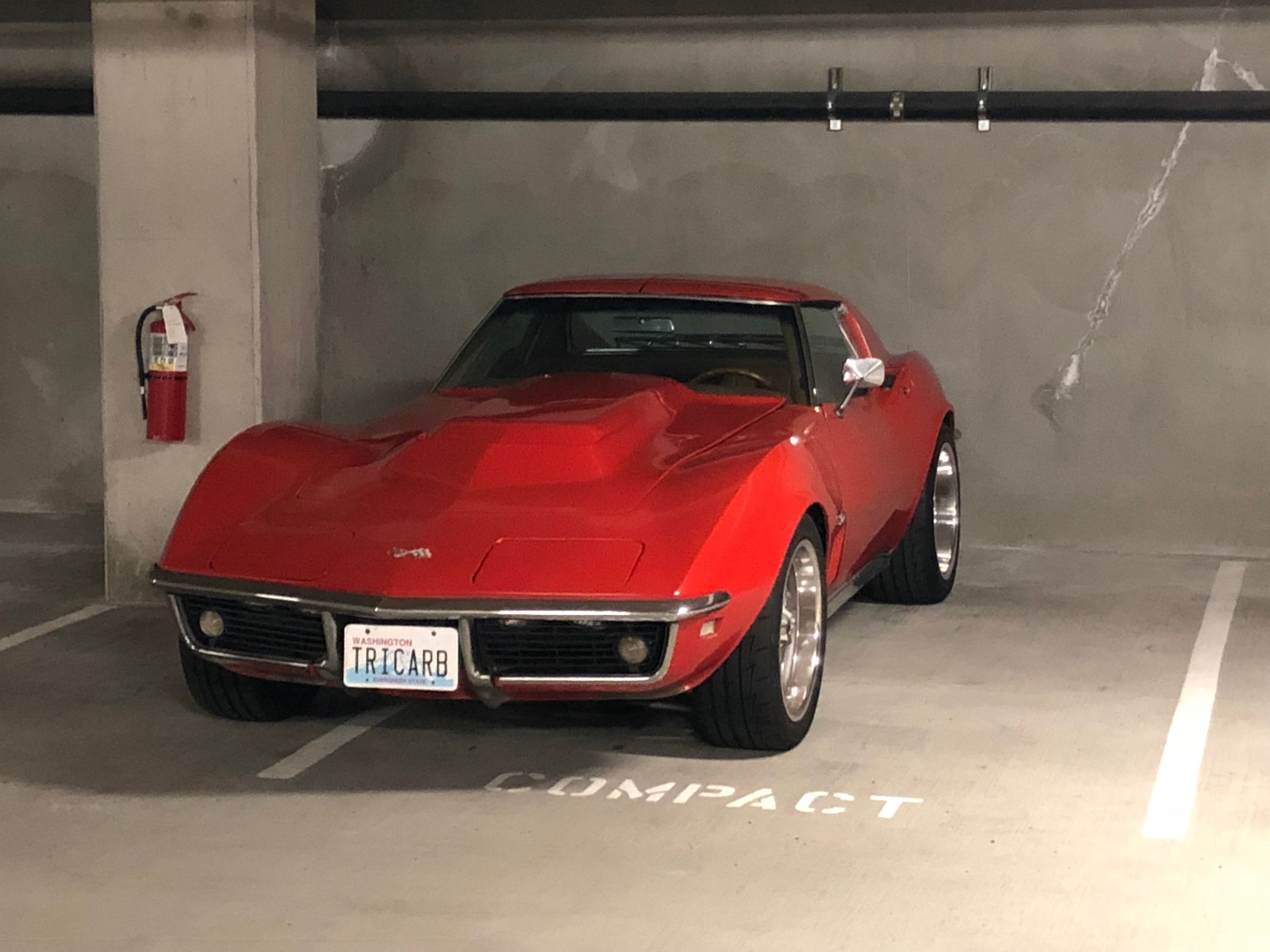

I love my 18s.
Wheels: Foose Knuckle Gun Metal Gray
Tires: Firestone Firehawk Indy 500
Front: 18x8 4.5" backspace wheels with 245/45x18 tires
Back: 18x9.5 with 5.25" backspace with 275/40x18 tires
I used a 1/4" spacer in the back to clear my oversized anti-sway bar. No spacer in front. I DID have to cut off and relocate the parking brake mount.
Here are a few angles for you to see.
