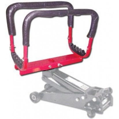

I need a source and cost for that door jack naramlee.
Craig
steck door hanger, ebay $65.00

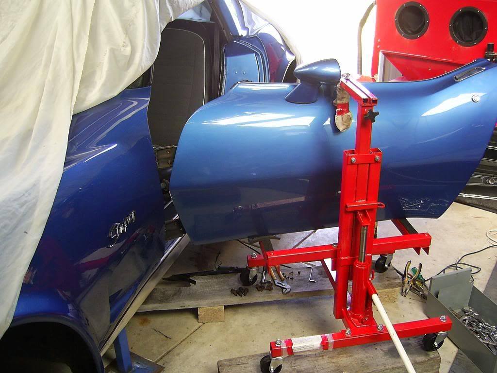

Old Nov 9, 2018 | 05:52 PM
bazza77's Avatar
bazza77
Joined: Jul 2010
Posts: 3,174
Likes: 631
From: perth western australia
Old Nov 9, 2018 | 06:08 PM

Nice jack!
I ordered a door dolly today. The kind that fits on a jack
I have the pins and bushings. I have the refurbished hinges also.
I'm going to pull the door of and get a look at the hinges first. If I can keep from changing the hinges that would great.
