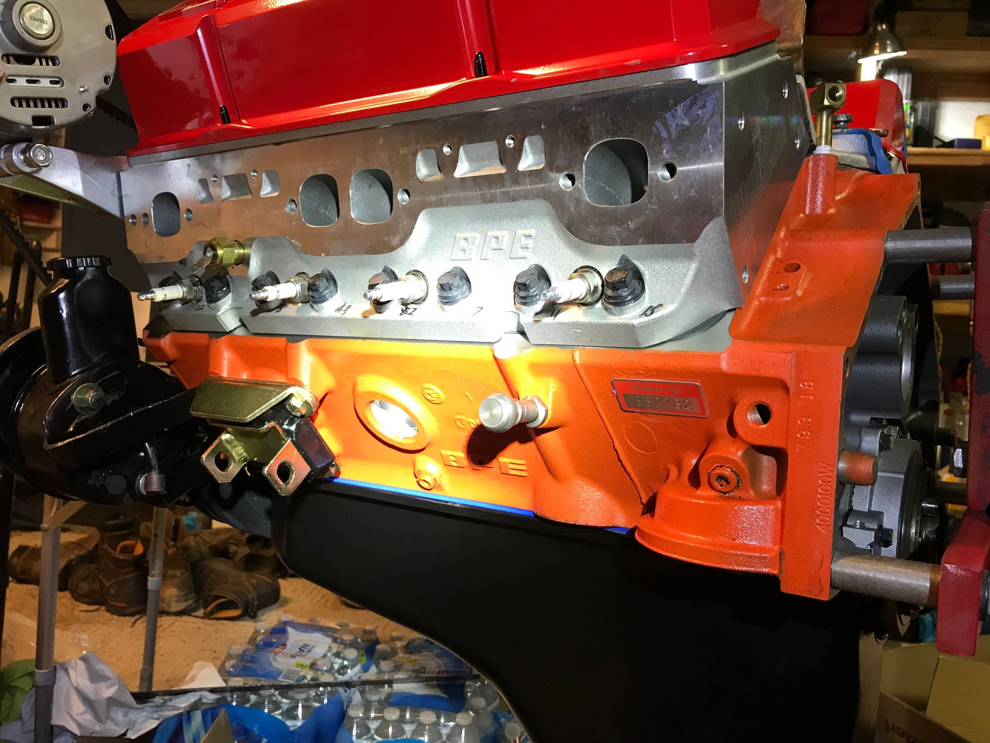

Well I figured I'd do a thread on my engine upgrade I recently completed. I had a decent engine in the car but I wanted more power (don't we all) and I had always wanted to build a 383 for it. So I finally pulled the trigger in September and ordered a Blueprint 383 short block (no heads). The original plan was to reuse as much as I could from my old engine to try to save $$$. After getting started, I found out I would have to machine my old Dart Pro1 heads so I nixed that and bought Blueprint's heads for it. The Dart heads were set up for a flat tappet cam and needed springs and machining to get them to the correct installed height. So I ended up buying a lot of stuff and going over my budget but... um whatever. Credit card is almost at it's limit lol. Lots of boxes from Summit Racing, a few free hats which I gave away as gifts. Anyways it was a GREAT project and a lot of fun. I did a lot of research on buying versus building the bottom end and decided I didn't really want to tackle that part of it. Besides all of the positive reviews for the BP engines and the price, it's hard to beat. The block is new and made in USA. There really is so many more things than you initially think of when doing this project. Just between new bolts and stuff it adds up. What happened as I went along was, once you start adding some new stuff, all the old stuff looks crappy. So I ended up painting a lot of brackets and getting new bolts, which I am happy I did because it looks awesome now.

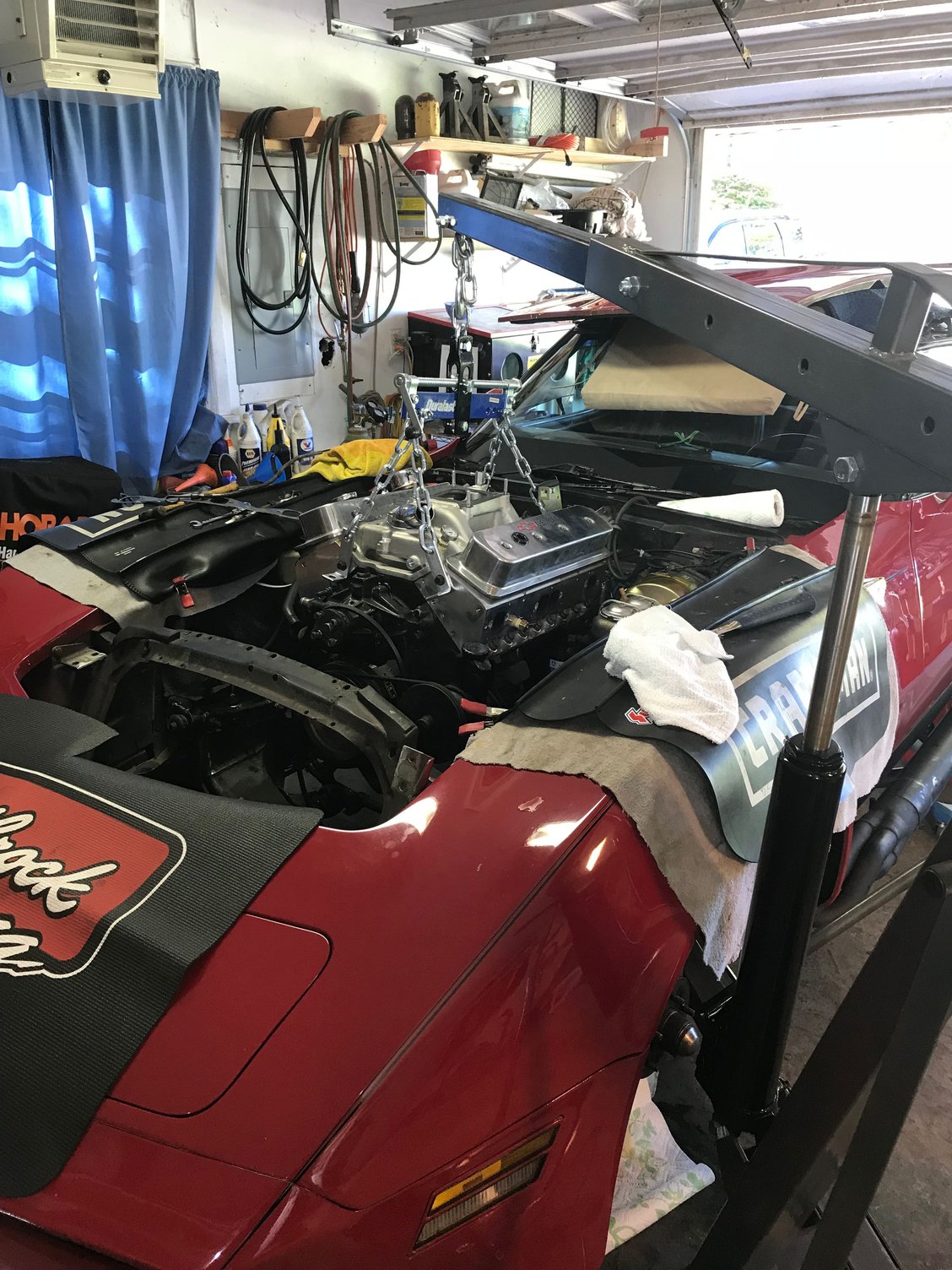

Installing the engine was actually pretty easy and went in without a hitch. And I had never done this before. The Harbor Freight 2 ton crane worked perfectly. I had a little trouble stabbing the transmission (TKO 600) in from the bottom but I eventually got it once I looked in and saw the clutch plate was off center.

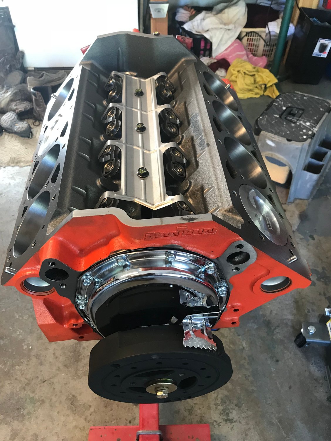

On the stand

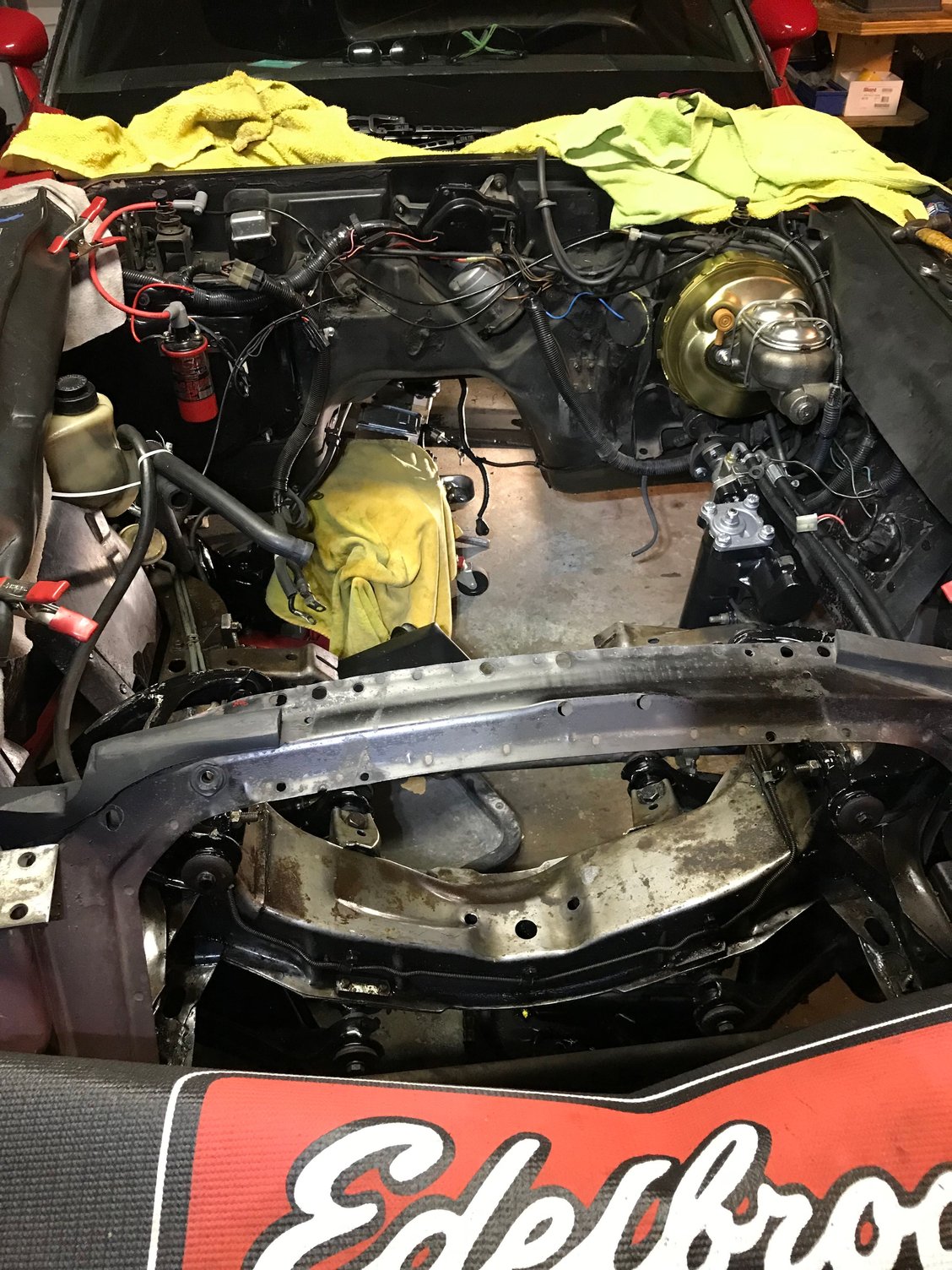

The empty engine bay

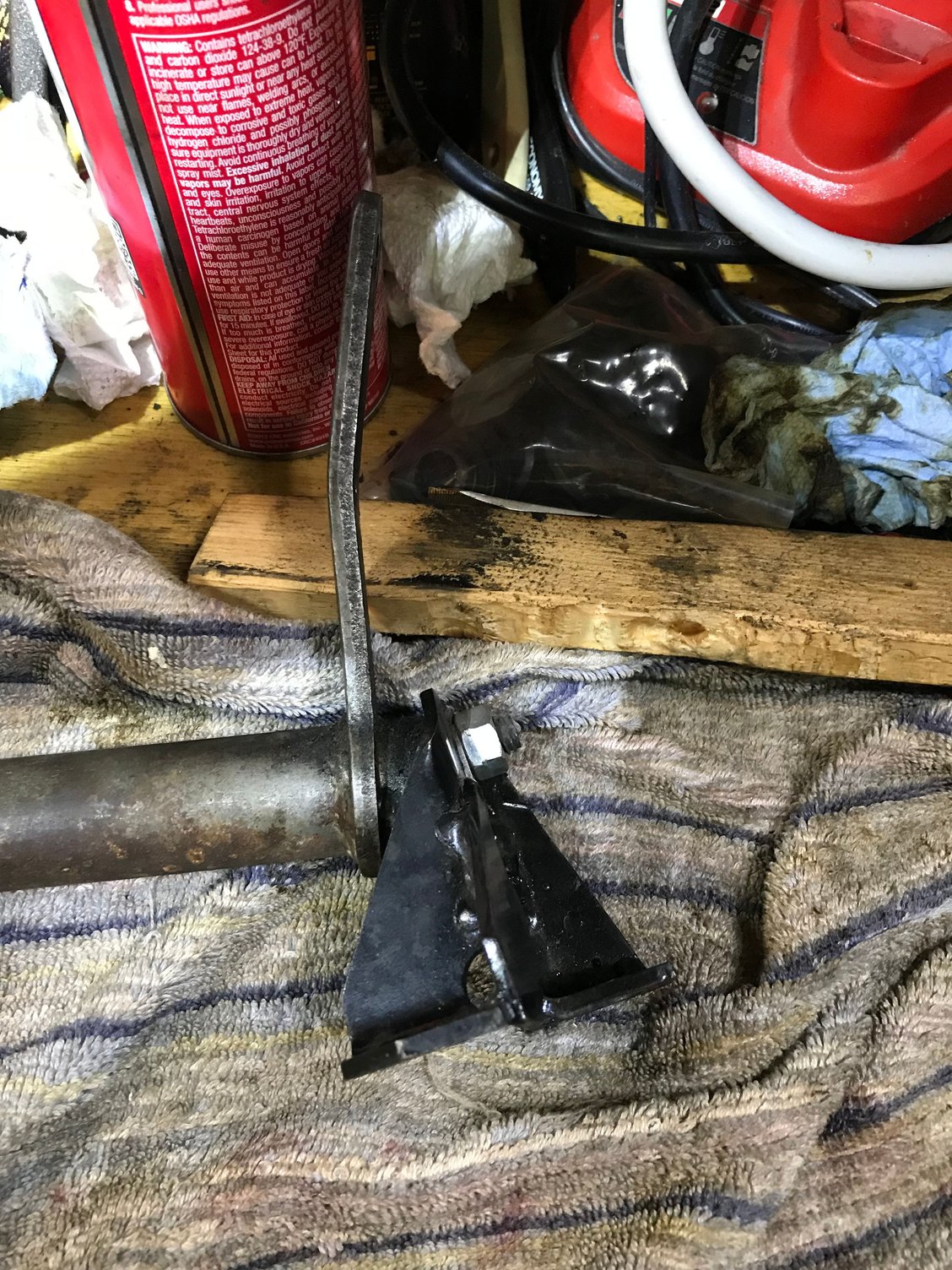

Had to bend one arm of the Z bar to clear the Borgeson unit (from a forum thread - thanks)

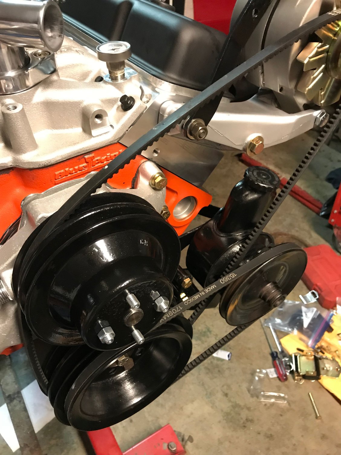

Getting the pulleys figured out. Had to shim out the power steering pump a little.

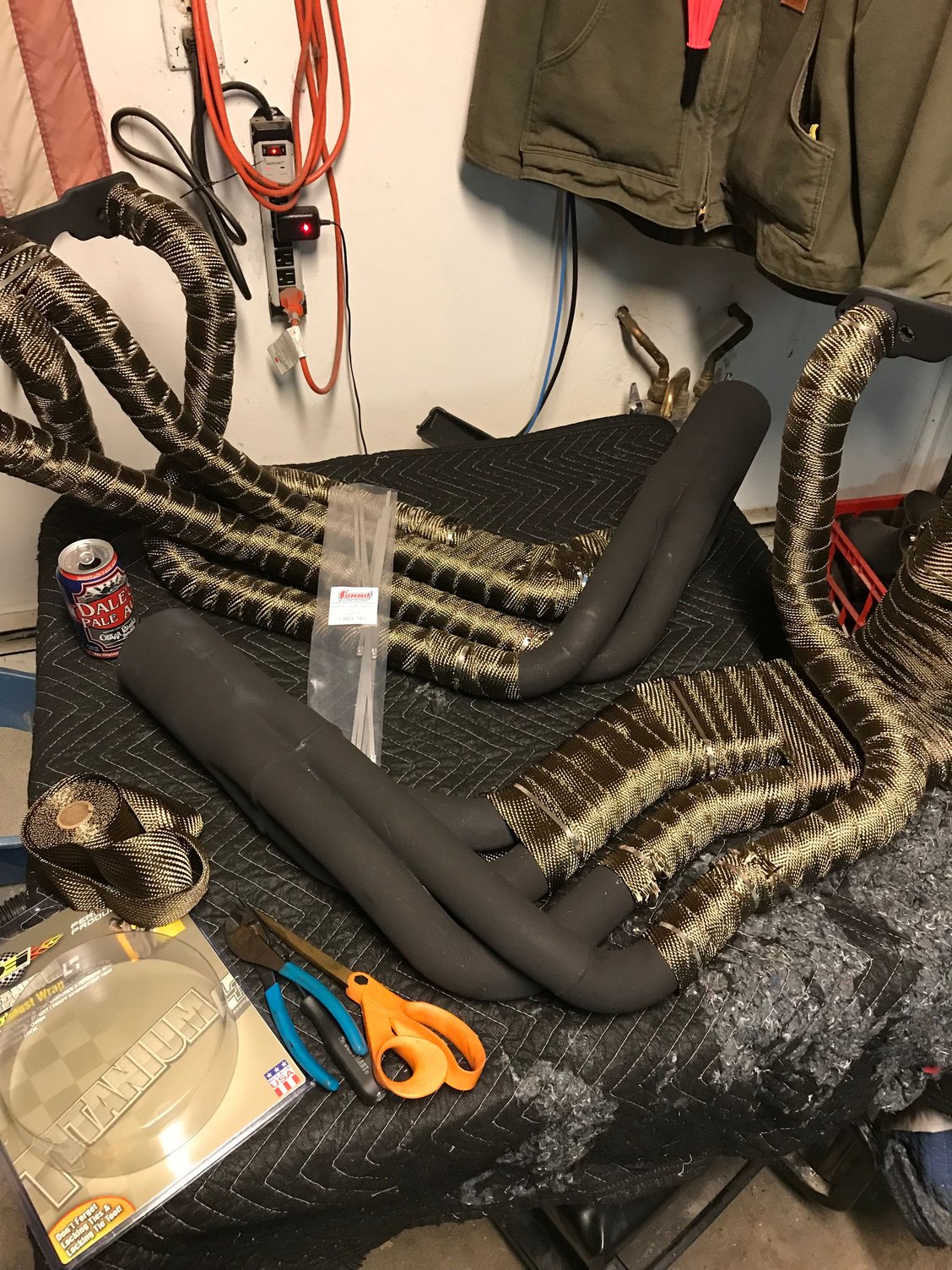

The really cool gold header wrap lol
And it's in

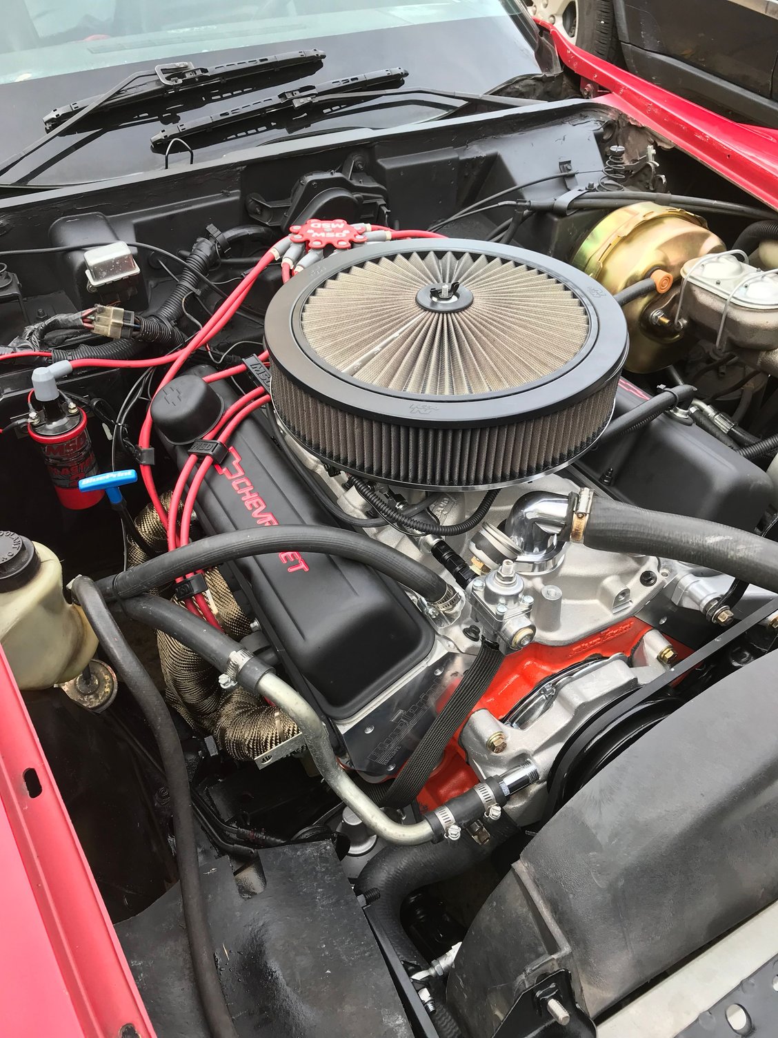

OK so how is it?
AWESOME.
Has tons more power, lots of low end torque. Sounds and runs perfectly. It actually fired right up, which was pretty incredible. Do I actually know what I'm doing? lol.. It felt like it. No leaks or issues either. Let me tell you I was stoked the day I fired it up. My wife was like haha you're like a little kid.
Driving it, it feels like it has the power that the car always should have had. I haven't gotten on it hard but it pulls a lot harder than it did before. They say this combo makes 430 HP, so I am figuring it is around that. I am surprised at how good the Eddy 650 carb works with no adjustments from the old motor. As I said before I am planning on getting the 800 AVS2 when it comes out in a couple months. The Edelbrock has treated me well so I will stick with them. Plus I have the jets and needles and stuff.

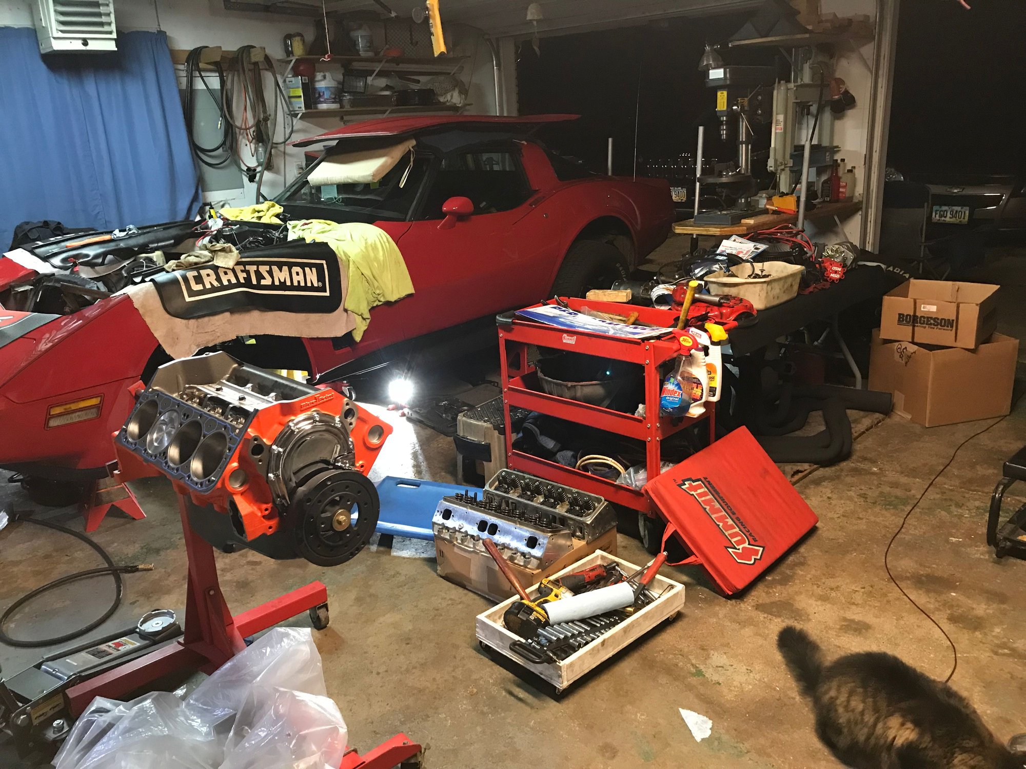

I love this picture, it looks like a Summit christmas card
Ha yes! It was Summit Christmas time for a few weeks. Wife was getting worried with all the boxes coming. And she only saw half of them. I had to take a picture of the garage! And that's a cat in the lower right, not a raccoon!
