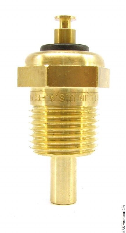

You won't even see it as the upper radiator hose will be covering it. The one problem that I'd see is the connector. The original connector for my '71 is the slip on type that goes on from the side over a the round button on the sensor. If yours has the blade type connection then it won't work at the intake location as there is no room for that type of connection.
My sensor type:
And the connector:
