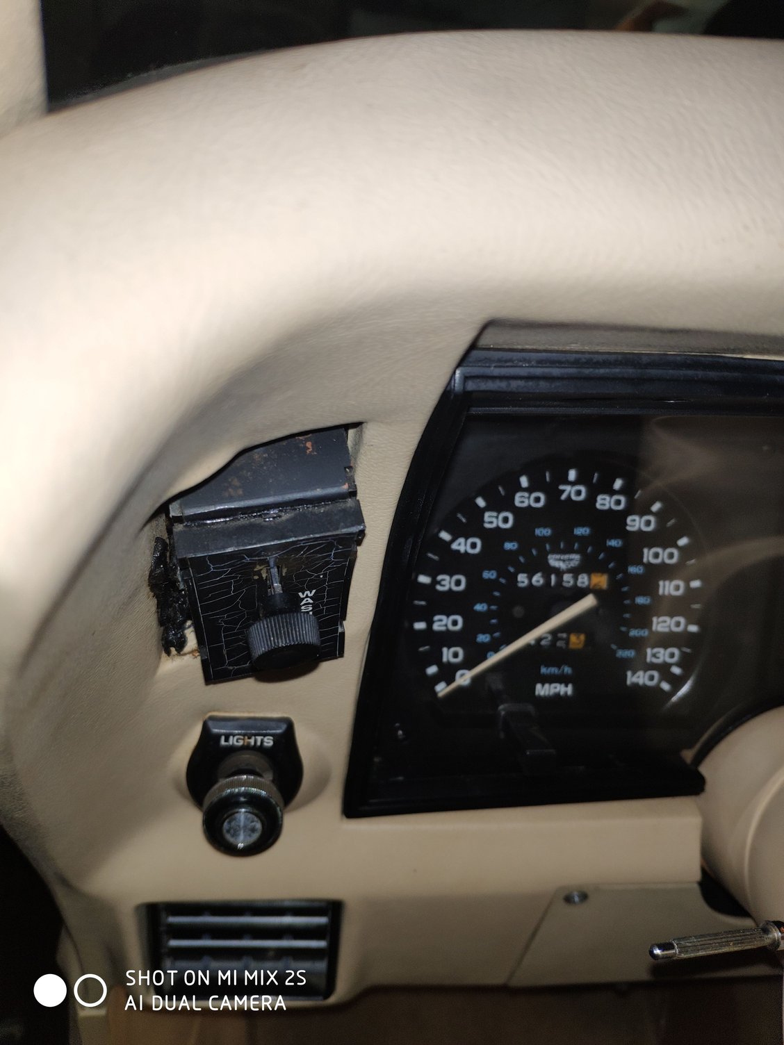

So I need to replace my windshield wiper switch but all the ones I find are for pulse wipers and look like this

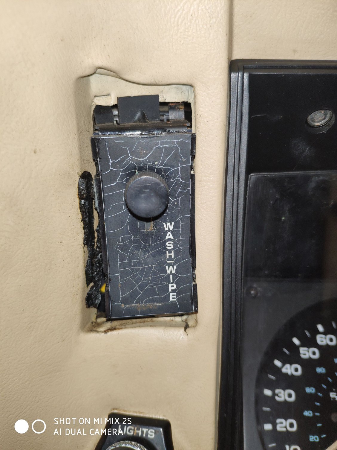

but mine looks like this and is not for pulse wipers and cannot find one that looks similar to it
the shaft for the **** is round on the replacement and flat on mine also

Looks the same to me if I understand your problem. Just put your round **** on the new switch.

I would do that but my car doesn't have pulse wipers and that switch is for pulse wipers and I don't want to convert it cause the controller is really expensive. If that switch will work with mine though I would use it

The switch is easy to rebuild.. and while this is for a delay switch the standard switch is still pretty much the same
There is more info at this link..http://repairs.willcoxcorvette.com/?...s=wiper+switch and a write up about how to do the switch rebuild.. (which is pretty much the same as standard wipers). http://repairs.willcoxcorvette.com/1...switch-repair/
