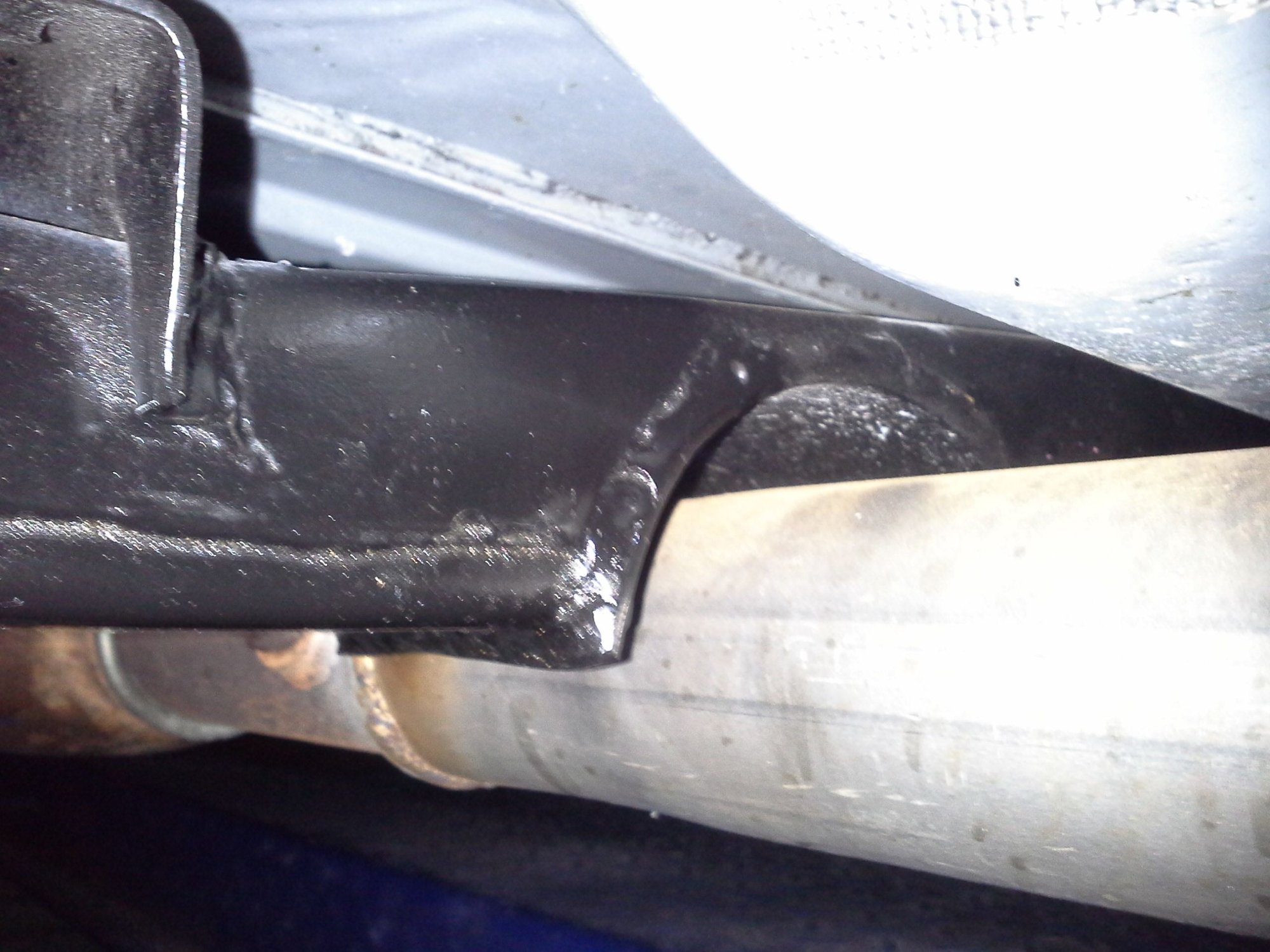

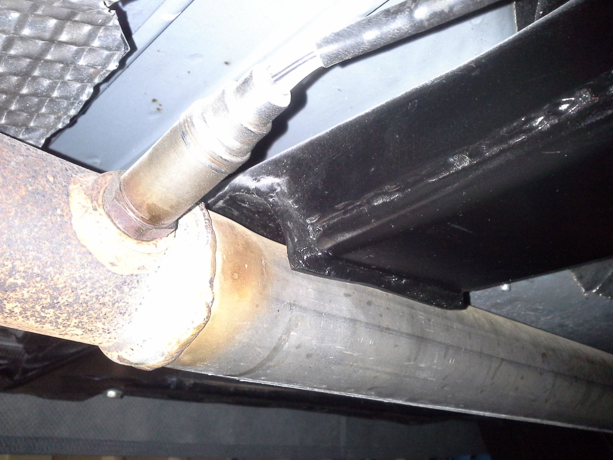

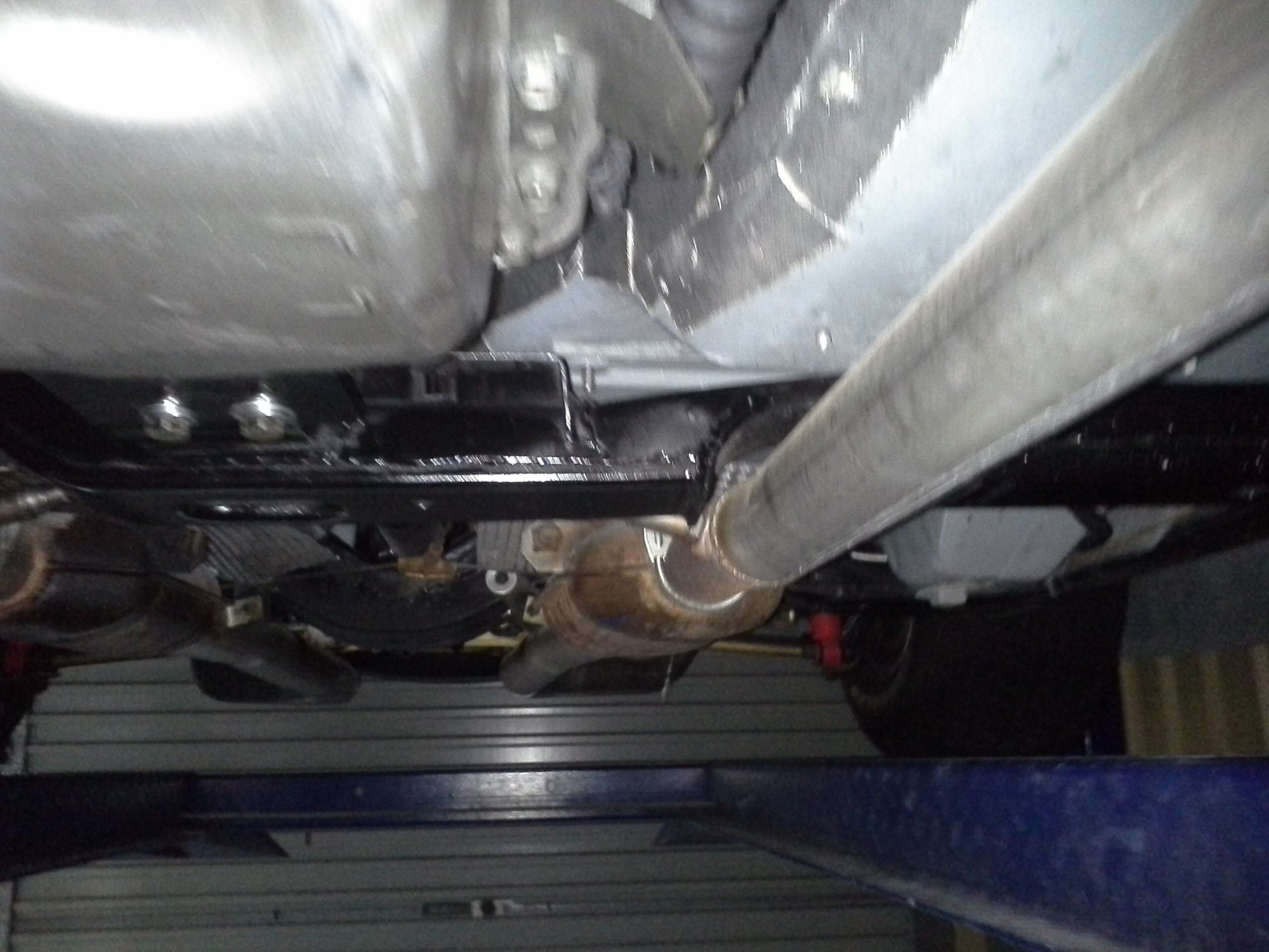

Thanks for the reply. In 80, the exhaust goes under the crossmember already so maybe I will look to modify it. Excited to get started on this, but I may wait until my lift is installed so I can just lift the body off.
I ran an 80 crossmember in my 77 swap , had to make the bracket from the crossmember to 4L60 anyway so I welded in a piece of 4 inch pipe for the drivers side exhaust pipe to go underneath
