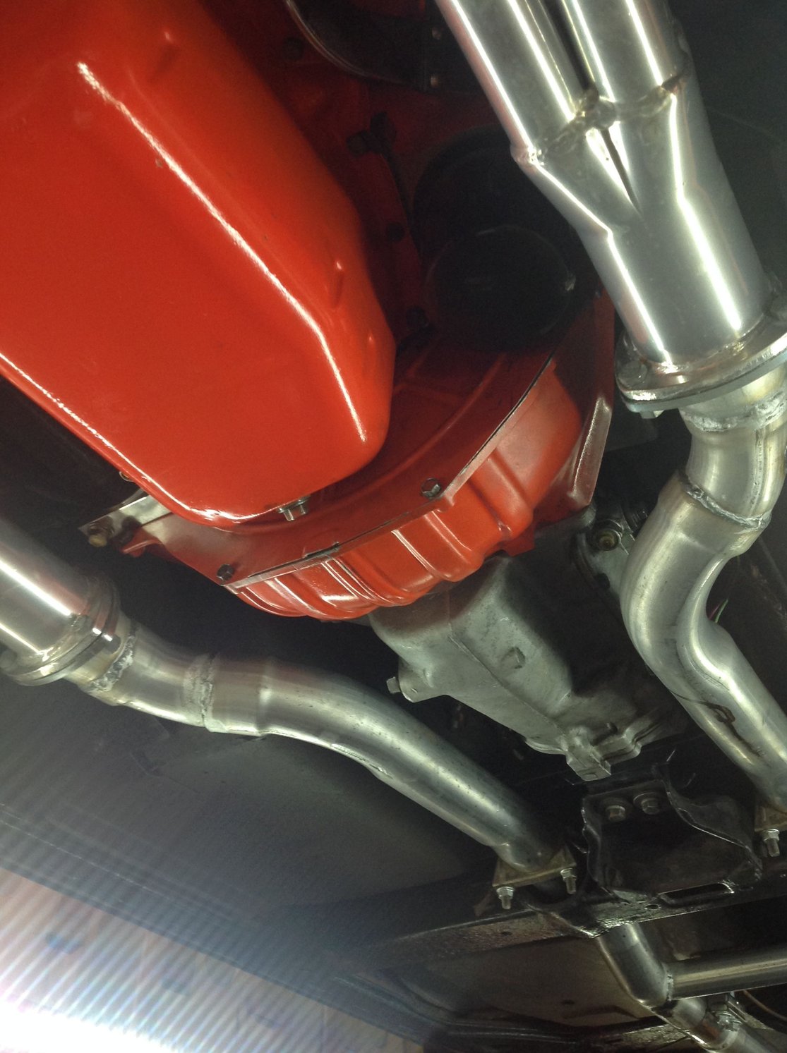

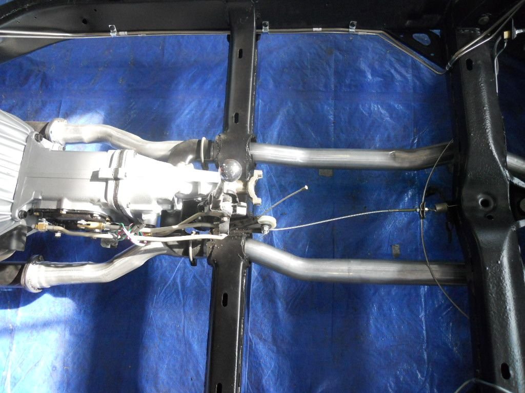

Hopr this helps. I can take a different view if needed but this is what I had already. Let me know. BTW this is a 327 but should be the same as a 350.

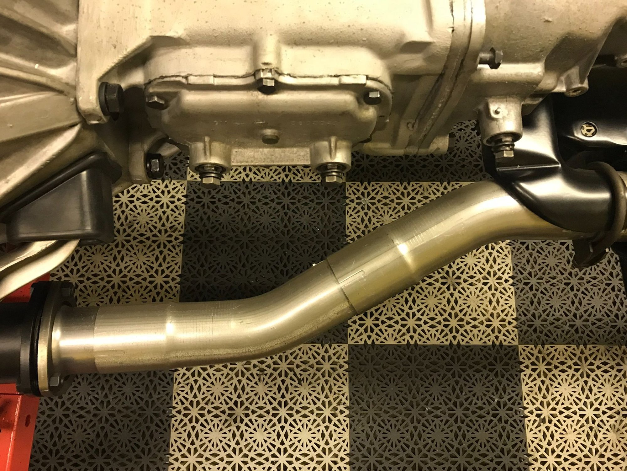

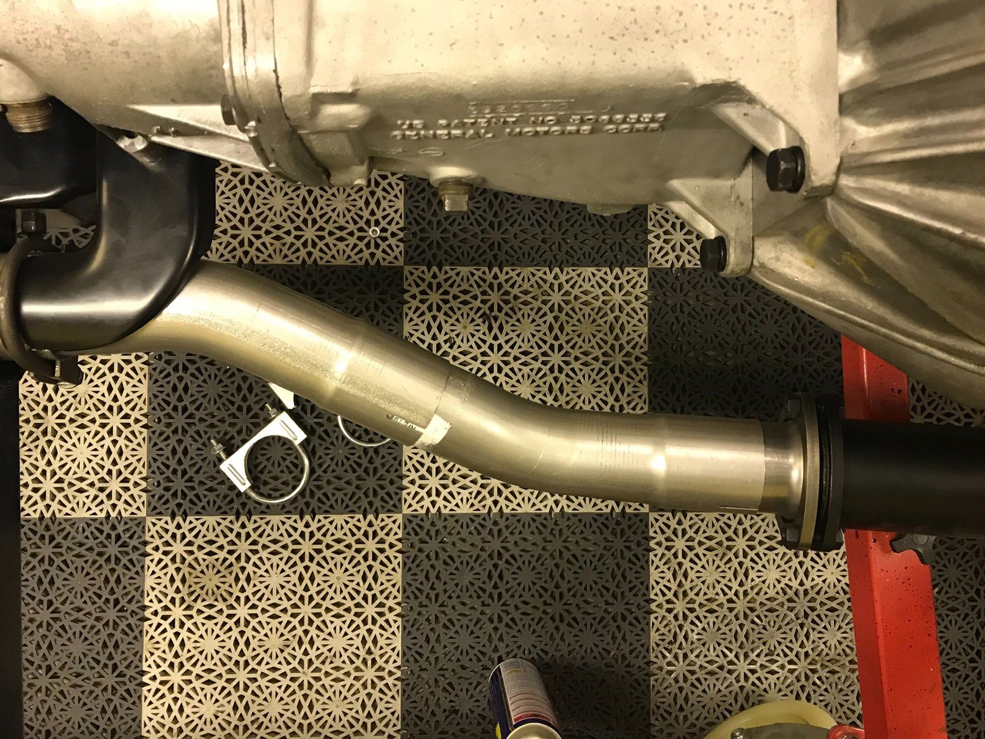

I've figured something in this direction though I’m afraid it will be to close to or touch the body.

Thanks for the picture, your pipes seems to be closer to the gearbox than mine. I think I will redesign and use 45 degree pipes instead of 30 to avoid contact with the body. The body is at the paint shop so I can’t check.

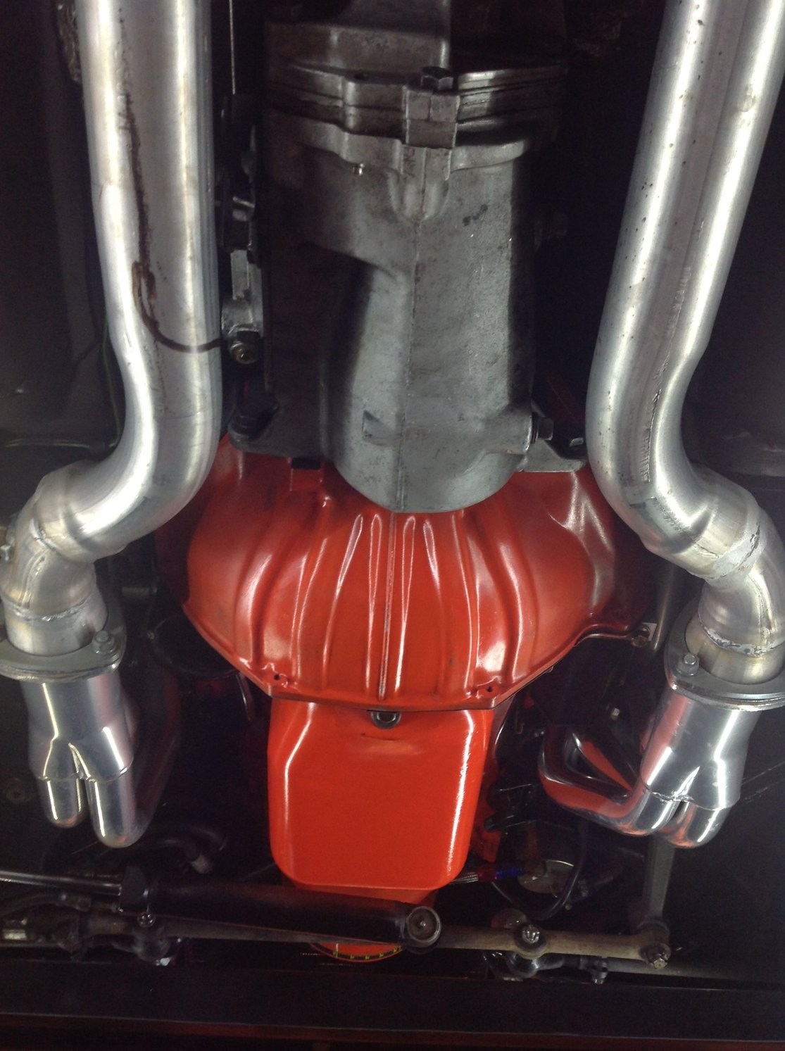

Lord M ... mine are also custom. Various header flanges end at various places near the firewall, so yours will probably need to be similar but different than anyone else's:
