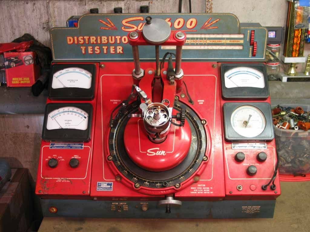

I have another question regarding 'distributor machines/testers'. Do they still make them?
Is it true that the job becomes 'easier' when using such a machine to adjust distributors'? Or aren't there any benefits?

I have 2 Sun machines, and yes, it is FAR easier to curve a dizzy off the car, although it can be done with patience.
Sun no longer makes them, and you pay well for a good/rebuilt unit. Say $1500-$3000
King was making some nice new units for big $$, but I "believe" they went belly up.
I "assume" you have an HEI. Use two gold springs from Mr Gasket 528G. Aftermarket weights are trash.
Lars has great papers on this. Email him at V8fastcars@msn.com, and tell him what you are trying to do.
