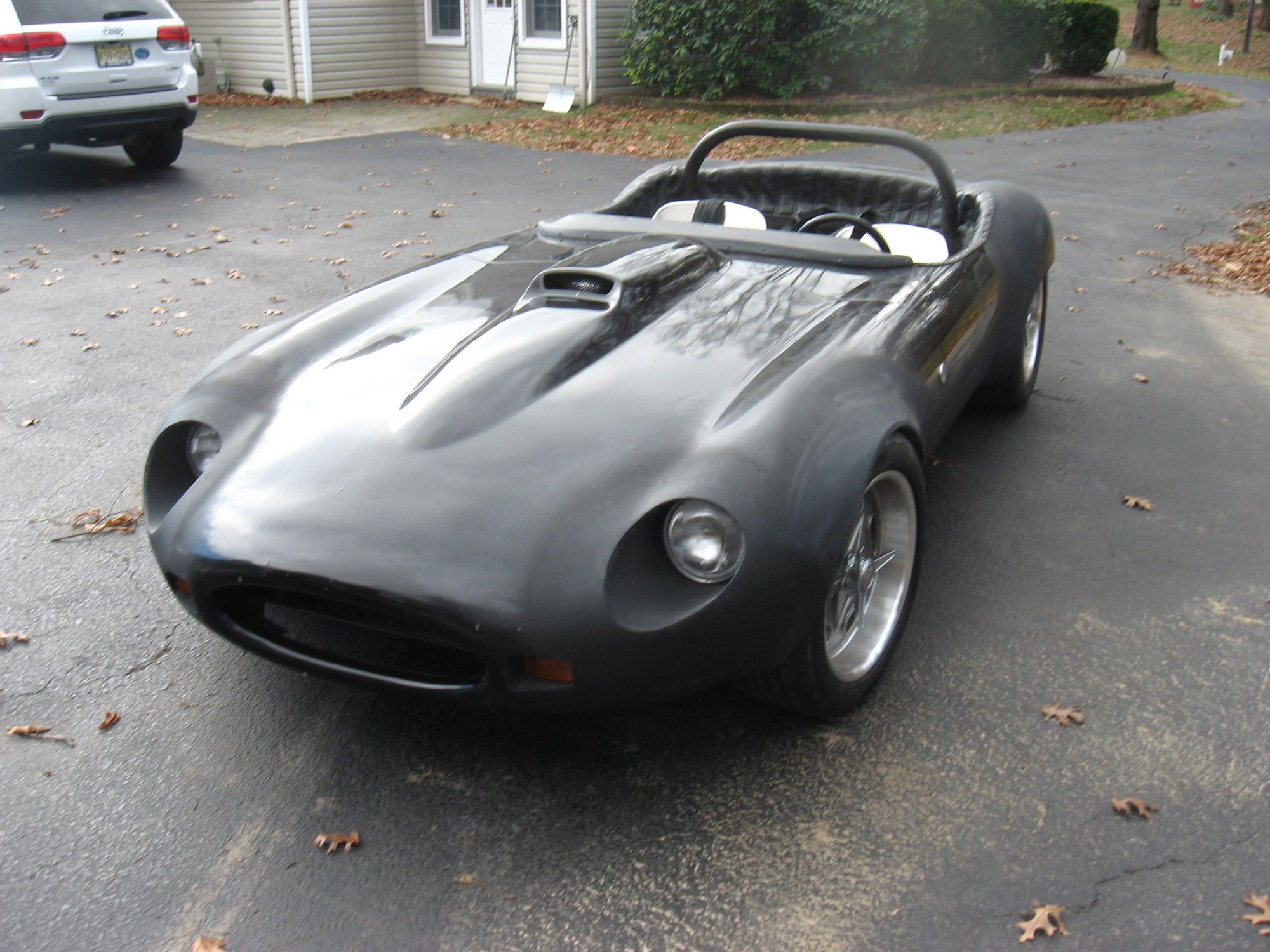

need to know the lowest manifold for a 327 engine-----does anybody make a 3'' front and a 4'' rear manifold ---please help ---thanks

Default forgot pics --
need to lower the scoop and need the lowest manifold possible

Nice car, what is it?
Here's a list of various after market manifold heights. But I would guess a stock L-82 Corvette manifold is lower than any of these. I have one off the car that I can measure, just tell me what dimension you need.

They aren't like big blocks. You can find big block intakes with the carb flange level with and slightly below the intake ports on the heads. I guess the narrower intake width makes a couple inch rise necessary to avoid a really restrictive intake path. I looked at the used on ones on eBay. None are flat like 454 truck intakes. Nice leetle ride. Half XKE, half Cobra? Looks a bit like a D type Jag. Looks like you would want a higher scoop to act as a windshield...
