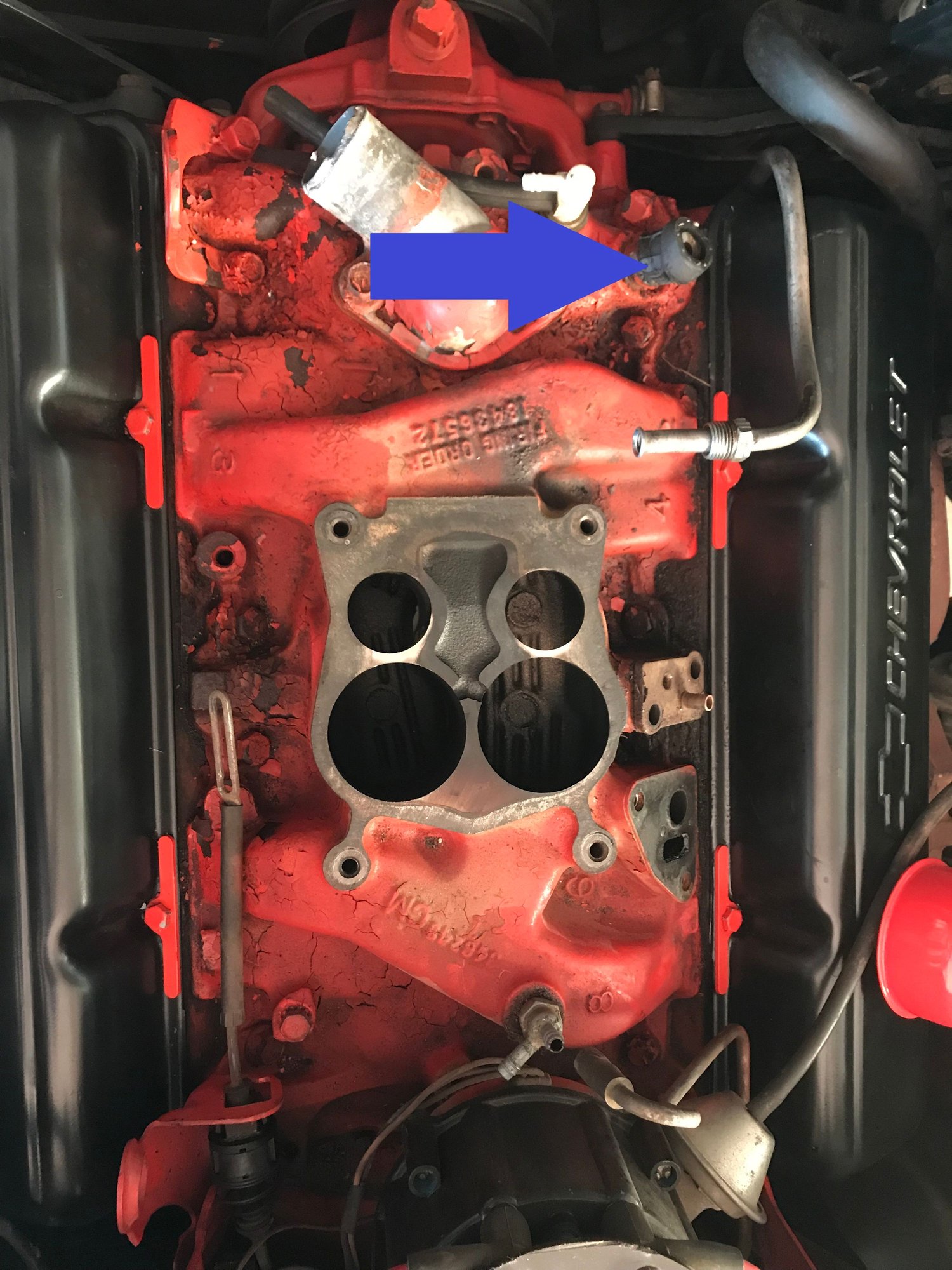

Full disclosure, complete newbie when it comes to working on cars...I have been tinkering with my 76 L48 for the last few years (using this site as my bible). This winter I decided to dig a little deeper swap the stock cast iron intake with a Edelbrock 2101. I got the carb removed and am considering having it rebuilt while it is off (Lars still around?). I am at the point of removing the distributor but I think I have done enough research to ensure I have the rotor marked for reinstall. I am changing out the intake and carb gasket as well as buying a new thermostat housing. Anyone have any advice for other things I should consider replacing or looking at while the intake is off?
Lastly, probably a dumb question but what is the fitting the blue arrow below is pointing to on the intake? The hose is completely melted to it so I want to buy a new one. Just need to know the part number.

1. Blue thing is old heater hose. Use a pipe plug on new intake.
2. Do not use thee supplied intake end gaskets. Use some type of sealant.
3. Block of heat passages that go through heads. Some gaskets have built in blocks
4. Mark distributor body in relation to firewall and rotor in relation to dizzy
others will have more advice.

1. You are saying that the hose going to this isn't used/needed? I just cut the hose right above the fitting right before I took this picture and planned on buying a new fitting to plug the hose in. I just didn't know the fitting.
2. I had heard this before. I think I am going to take your advice on that.
3. Interesting I had not heard this. I planned on buying the Felpro set: MS 90314-2. What is the reasoning for blocking it?
4. Makes sense!

If you were using it before continue to use it on the new intake. Remove it from your steel intake and transfer over to the new intake or buy a new one. Threads are probably 1/2" npt and then whatever size hose your running for the male end.
