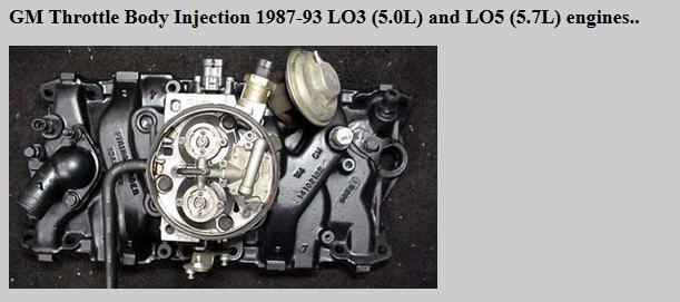

It's not my fault you can't tune as good as GM engineers.
In the early 90's with the very low hood coming out on the 93 camaro, GM developed the Gen 2 LT1 intake:
They originally did it as an interim solution to the 93 camaro's hood clearance, but discovered it was so easy to tune they kept it and put it in production, despite the poor midrange performance compared to the TPI intake. I had this intake and engine in my 96 impala ss. We were looking for an option that would give us more torque in the midrange, as the impala was a heavy *** car, and the Lingenfelter Super Ram was too damn expensive. So we had to look for alternatives.
Back in the late 90's, Accel made an elbow that would adapt the stock Gen 2 LT1 throttle body to GM's Performance Parts carb LT1 intake...
Accel 74882 90 Degree Plenum Adapter
http://www.holley.com/9901-101-1.asp
which was a standard Edelbrock Performer RPM intake modified for the LT1:
Maybe the intake elbow acted as a spacer, but we never had a single issue with that intake after we got it tuned and it pretty much bumped our torque curve by 30-40 ft/lbs across the entire rpm band.
I couldn't find a picture of the exact setup, but here's something similar. Plus, it shows injector bungs welded into a carb intake, which is what I was suggesting to the OP in the first place:
Maybe the OP can keep his excellent midrange and still run MPFI by using a similar elbow. Edelbrock and Holley both make an adapter elbow for the LS1 throttle body.

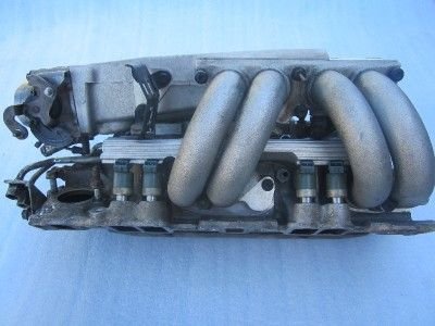

All TPI engines, the GM original LT engines, modern LS engines -none of them came with single plane manifolds; all have port fuel injection....

The formulas for intake wave tuning are well known; it's not even remotely controversial or up-for-discussion, really.
If you know the length and average CSA of an intake's runners you can just plug it into PipeMax and it will tell you @ which RPM which reflected waves will occur at. The intake wave tuning provides a small amount of boost in a narrow RPM range and provide more torque at the RPM that it's occuring at.
The longer runners of a dual plan are harmonically tuned for a lower RPM than single planes. True 19" -21" "long runner intakes" ala TPI or some of the Dodge Cross-rams are working with the 3rd reflected wave which is stronger and WILL end up with more torque lower down, if the CAM timing is time with the resonant frequencies of the intake track.
-Just because you have efi squirting the fuel in, doesn't change that.
The OP isn't dealing with wet flow issues; he's using port injection.
From Grumpy: "setting up a dual plane intake for MULTI PORT EFI, will provide you with good street manors and good mileage and potentially more low and mid rpm torque, but its unlikely to provide more peak rpm horsepower, than a well designed single plane thats cammed and geared correctly ,could. each design has it strong and weak points"
http://garage.grumpysperformance.com...-efi-use.2590/
My understanding is that the problem with dual plane manifolds and EFI is SPLIT / DUAL PLENUMS, NOT dual plane manifolds themselves. This is Holley's official stance on the issue. The problem is that with a fully split plenum you've got a MAP sensor that can only measure one half of the plenum and it doesn't know what's happening in the other half. Cutting down the divider or adding a spacer solves that problem. -If you took a TPI, LT, or LS intake and installed a plastic split down the center separating it into two fully separated plenums, you'd be in the same situation with a MAP Sensor in only one of your two plenums. -A dual intake with split / dual plenums (no dividers) is actually an intake with two plenums but a MAP sensor in only one of them. https://forums.holley.com/showthread...l-plane-intake
-I'm going to bet that if you had a dual plane / dual plenum intake and an efi system that could support multiple MAP sensors, you'd still see improved low to mid range torque AND you'd have no problems running the thing. I don't know of any dual MAP sensor EFI systems, though so cutting down the plenum divider is the way to go.

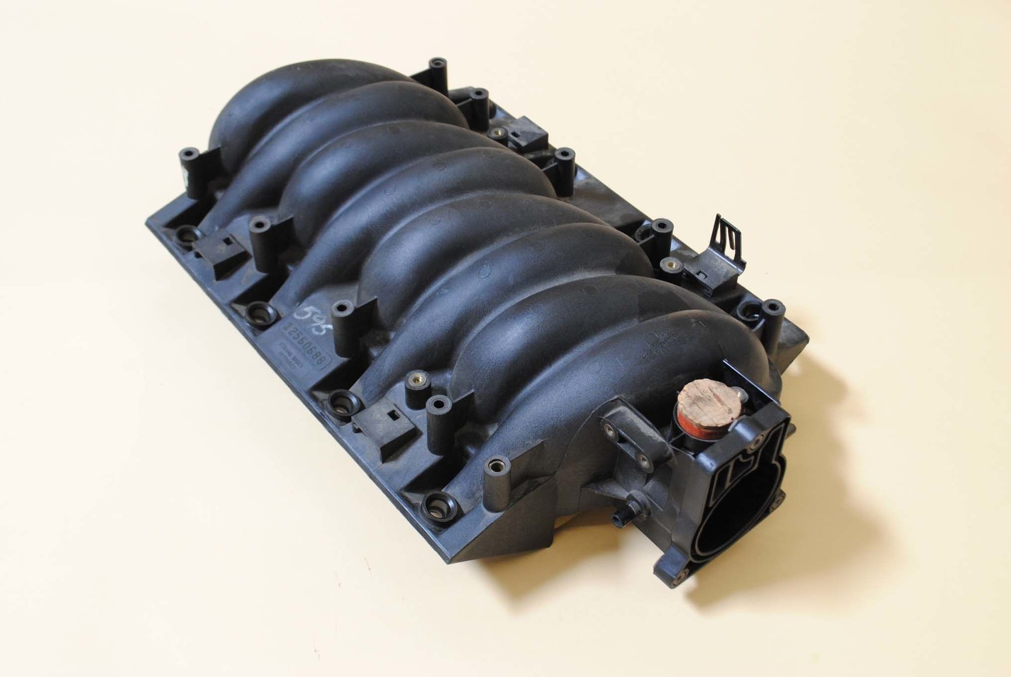

I think I'm misunderstanding what you're saying, but either way, neither TPI, nor LS intakes have straight runners. TPI runners have a 180 degree bend of the air...
Not remotely straight runners; curviest runners ever???...
LS curved intake runners
