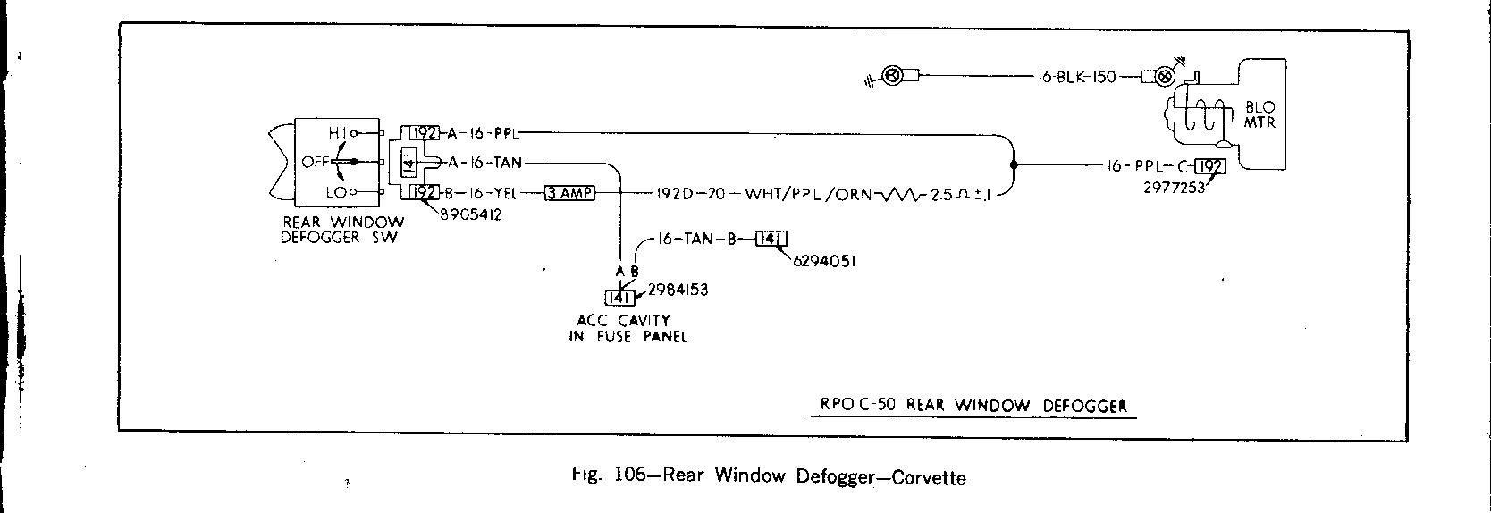

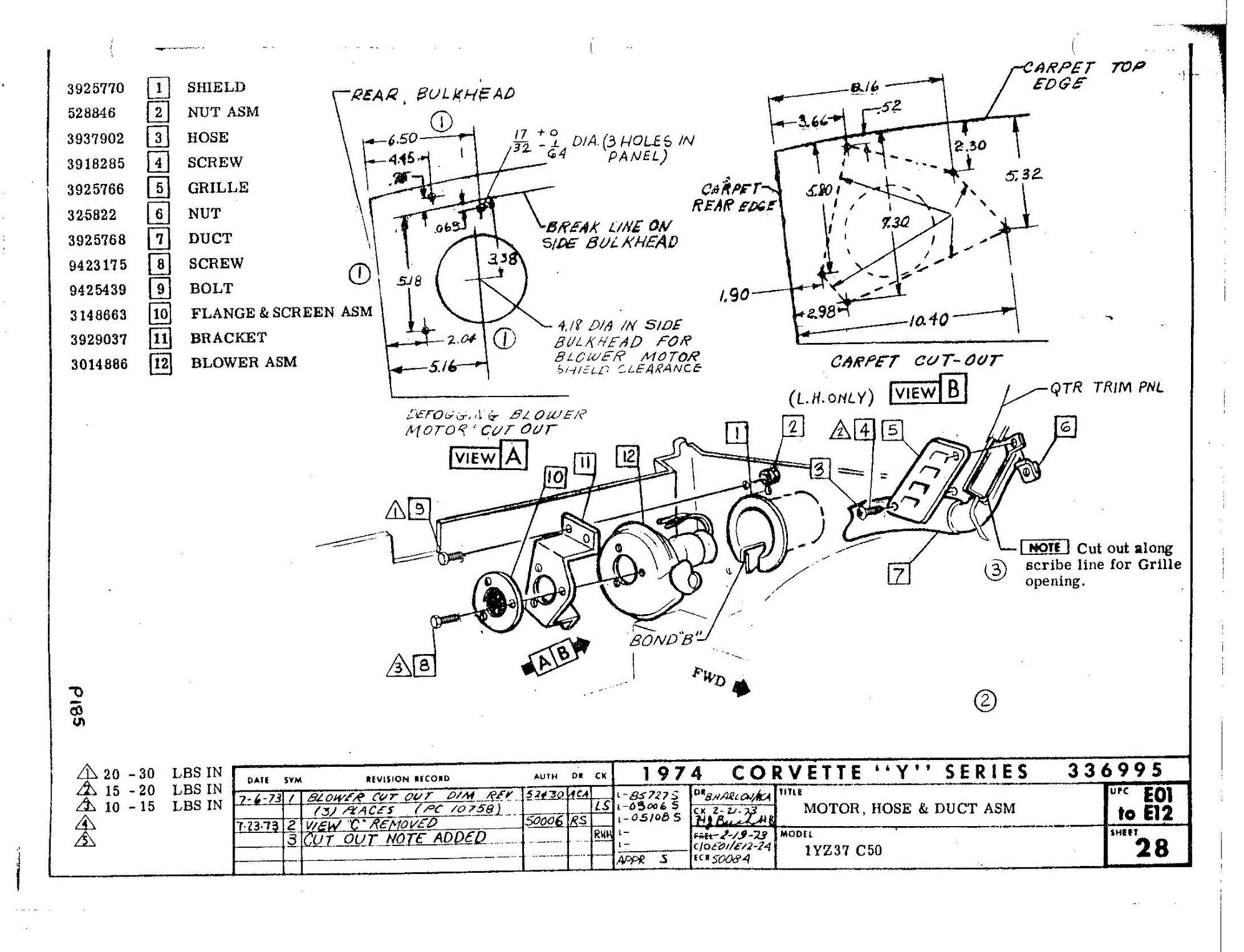

Need diagram or photos of 71 coupe rear window defogger vent and duct. Any help would be appreciated.

Default Does this help?

Thanks Peterbuilt, that's a big help...
