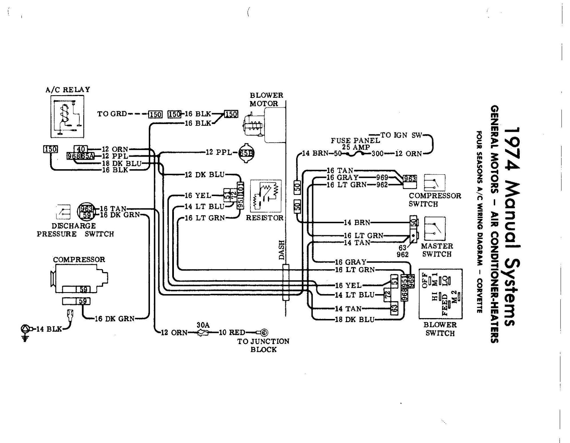

Corvette 74 - A/C - the blower motor is suddenly not working. Changed to a new blower switch - but no improvement. Have power to the new switch and the blower motor works with external power directly to the motor.
I am now planning to change the Master sw (2973407) and the Comp sw (2873872) - as per page 227 in the red Haynes owners workshop manual.
however, I just can not find these two switches? -
can anyone help help me to find them?
Do anyone know what the numbers as above mean? - are they GM partnumbers? or ?
Regards
Bo - Sweden

First verify that your blower motor is grounded.
Run a jumper/temp ground wire from the block to the blower motor and see if it runs.

The master switch and comp switch are mounted under the plate where your rotary heater controls are. Top right hand under

Pull the resistor grid out of the duct and look at it.

It is VERY common that a black ground wire from the blower goes to the + post on the starter, that is RONG you need it to be going to ground....in my '72, I ground it to the intake manifold , it happens VERY often when someone changes the starter motor, the wire sometimes goes under that starter bolt, and maybe a factory did it on the bellhousing.....but I keep it simple.....intake manifold.....on my car it also grounds the wiper motor....so maybe check that too, just for grins....

BROWN #50 is LOW speed.
When your switch in the heater control is on LOW speed this wire will have 12 volts.
TAN # 63:
With the switch in the next click, the tan wire will have 12 volts on it.
LIGHT BLUE # 72:
On the next click, this wire has 12 volts on it.
All LOW speeds go through the resistor.
ORANGE has a separate fuse and bypasses the resistor.
Gets 12 volts only on HIGH.
