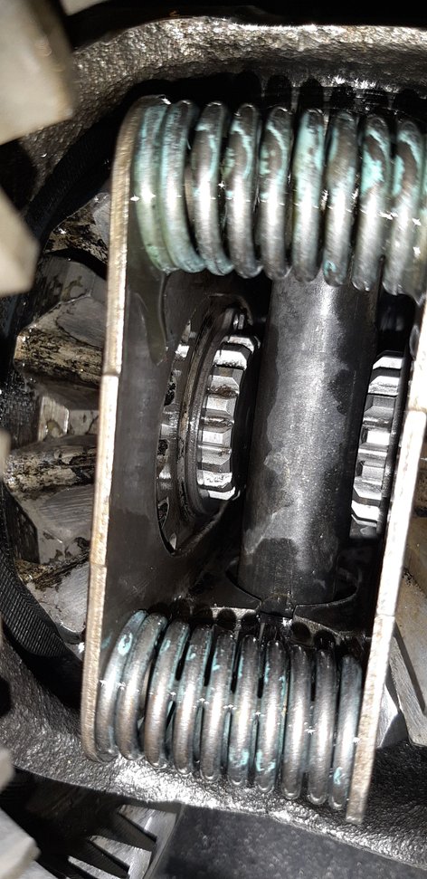

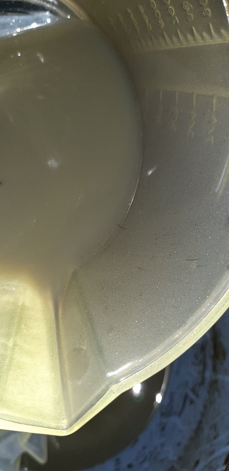

Hi guys, accidentally drained the oil when changing the spring bolts..
The oil was very glittery, although it has literally done 4 miles since the oil was changed..
It's not magnetic, what could cause this? Crush sleeve breaking down?
There is a slight up and down movement on the side yokes, don't know if that's normal. Side yokes have 40 thou endplay, break away of the unit is around 80 Nm atm iirc.
any pointers?(He asks while looking at rebuild kits)

Old Dec 25, 2018 | 04:23 PM
Dusky's Avatar
Dusky
Joined: Nov 2017
Posts: 587
Likes: 49
From: Belgium
Pin looks weird because of the brake cleaner

Also non metallic, so nothing iron anyway. Does the crush sleeve wear like that?

Crush sleeves don't break down. They are steel sleeves that are compressed under heavy load and keep preload on the bearings. I can't tell anything by looking at the oil picture there may be some metal in it or not. The ends of the axles appear good, there are sharp chamfers on each one. Looks like the axles are pushed in and there is a gap between the snap ring and side gear.
It appears to be an otherwise stock diff- rough posi castings, spring pack, etc. If it was quiet, you are not pushing the car hard, install the new cover and install it in the car and go. Use the correct length bolts of course.
Be careful buying parts, not all kits are the same. Do your homework.

That could be clutch material... did you put the friction modifier in when u added oil back? Clutch style posis HAVE to have friction modifiers or you'll burn them up
Cheers, isnt the endplay too big?
Do you know if the light up and down movement on the side yokes is normal?
That's what I'm fearing. I'm using amsoil severe gear oil (synthetic) which should have been fine according to a few people and the bottle, but now im doubting it.
maybe best to replace the clutches?

040" endplay for a rebuilt diff is absolutely lousy, for a stock built diff with miles on it then it's about right. There should not be a lot of lateral play in the axle/bearing. If there is, then the Torrington bearings may be bad.
I never use synthetic gear oil. Plain old 90 or 85-140 gear oil with GM additive is all you need. You pay more for oil you don't need. The clutches are not going to burn up, without the additive they would chatter. That appears to be a 70's posi so it would have the weak snowflake clutches unless they hav been replaced in the past, Do NOT use fiber coasted clutches as they will wear.The stock posi set up is pretty sloppy and more them likely a lot of the axle endplay is from the posi setup.

Its not a rebuilt diff although it seems Like it has the older style clutches.
with the side yokes in that shape, where can the play come from, only from worn clutches or am I wrong?
There is not a lot of lateral play, but you can see it none the less, difficult to say how much without my dti

Sounds like you have a stock diff with common axle endplay of 040" and a broken cover. As mentioned you can bolt on a new cover and drive it. Otherwise you might as well correctly rebuild it.
Axle endplay comes from 3 areas
1- worn soft faced axles
2- posi setup
3- posi case cross shaft holes worn
Old Dec 27, 2018 | 11:42 AM
2- posi setup
while its out ill Probably rebuild it, rebuilt the trans and engine too, so only makes sense...
Do you know the stock thickness of the posi clutches by any chance?
mine measure all at 67-68 thou, snowflake clutches sadly
thanks

068-069" so you have little wear on them and most don't realize they don't wear like a fiber flywheel clutch. They can be reused if you want but they are weaker. Solid steels are the best and available. If you build it stock make sure the lash is 002", Tuning is a better option but more time consuming and you have to balance it correctly or it will not work correct. Measure your axle face to snap ring should be 190-200 if original GM, could be anywhere between 170-185 with the quality of axles sold today -new or used. If you have 185-200 and had 040 endplay then the problem was with the posi setup- unless you found the case holes enlongated.
