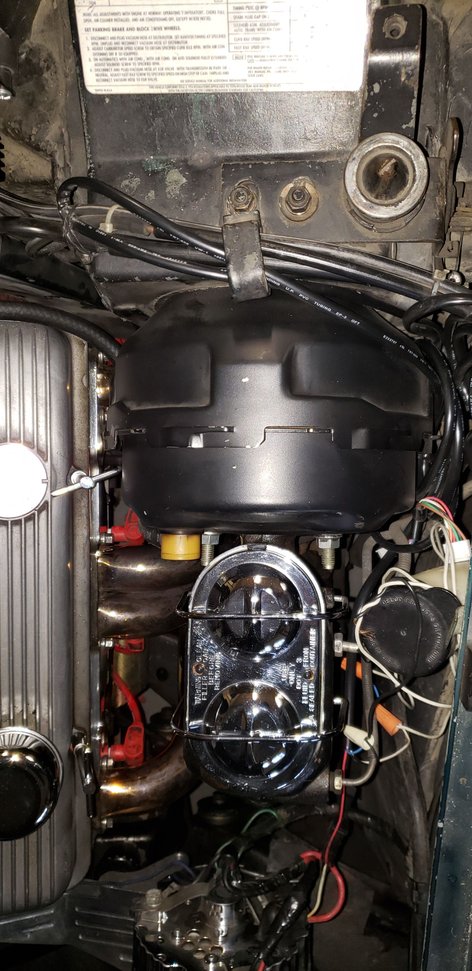

Originally Posted by suprspooky
I'm thinking about this change too, can you post a picture showing the Booster/Valve Cover area? Did you need to make new Lines?
In case you come across another Tuffstuff booster, I'll post a couple pics anyway. The booster was a direct bolt-in.
