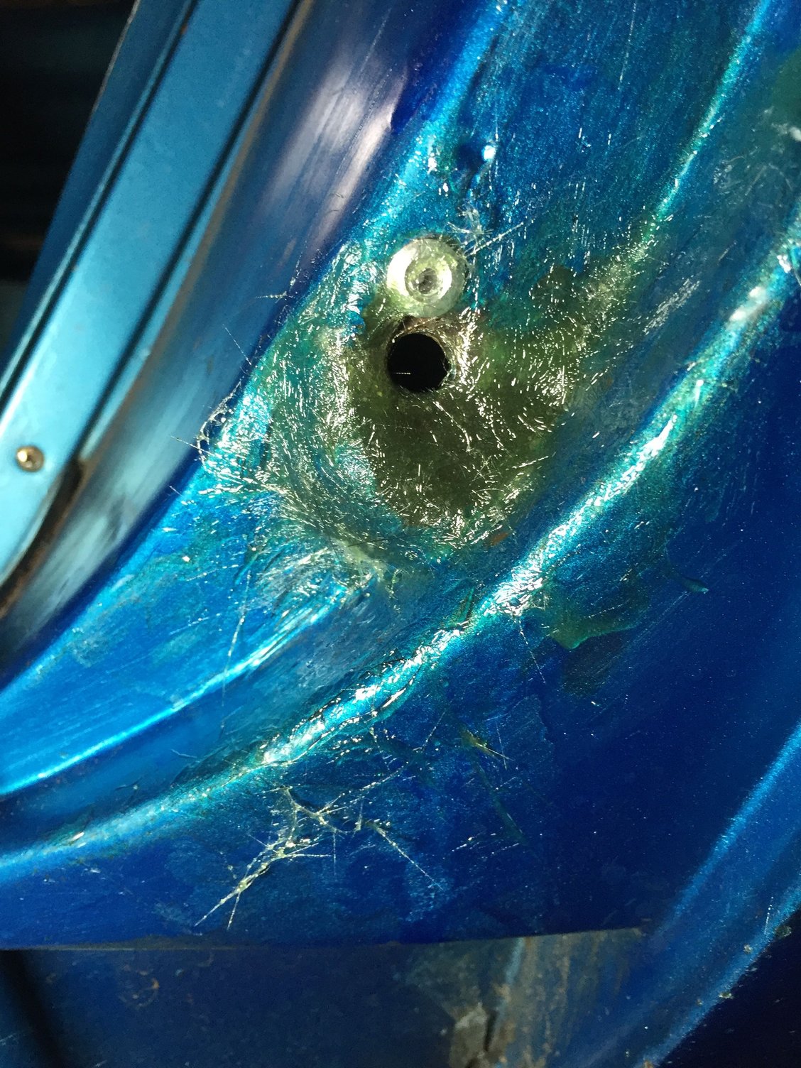

you won’t admit it but it happens alarm switch was bent on a angle ,, door closed pushed the switch right through the fiberglass I had just enough meat to get the pop rivit in the top hole im not done yet I will sand it out and shape it to orig. Im not to worried about the paint since i will be getting it painted this coming year

that sucks. Good luck

so it seems as if the newer door switches have longer ends on them so they bend easy if you hit them in any way or if something gets caught on them. this was a replacement switch if I can get the shorter switch I would be happy so this wont happen again

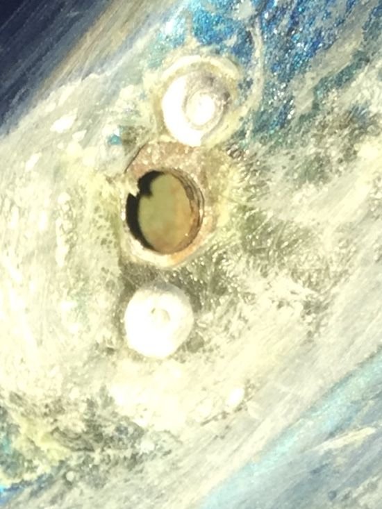

Getting there
