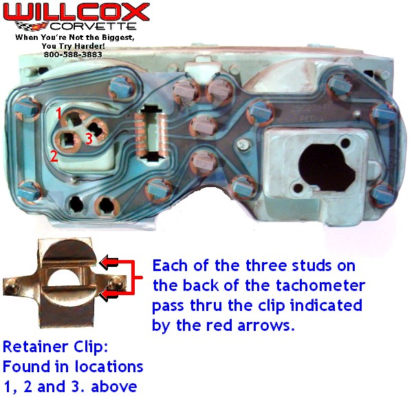

Originally Posted by JC82
Ok just one more question. I just inserted the tach bulbs by pushing them in from the front. Do the speedo bulb sockets unplug from the rear? If not, the bulbs still won’t be accessible from the front with the face plate in place. Yes?
The bulbs are held in place by a twist socket and they come out from the back side with ease.
If you look at this picture you'll see them on the right hand side. The only way to change the bulb is to remove this housing. The sockets in the picture are blue, the new ones are now black as shown above.

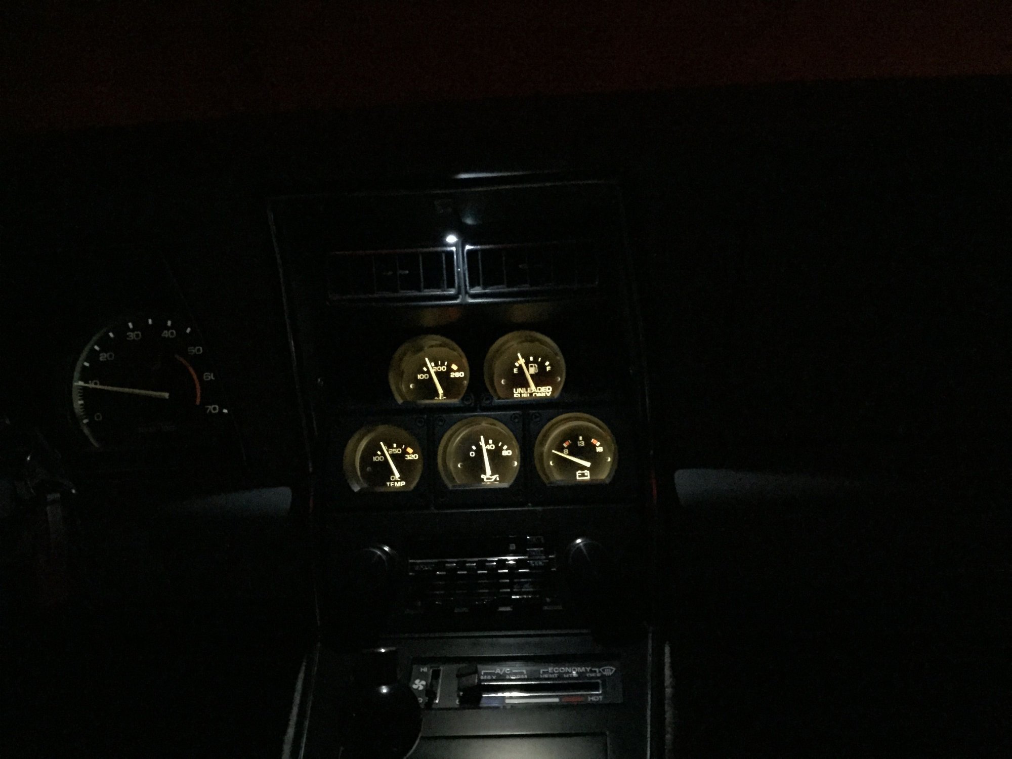

A note of caution - after replacing them with all new original glass bulbs (naively thinking the OE bulbs had faded over time), I decided to move to the upgraded LED bulbs. I first replaced mine with the standard "cool" white lights - just excited to have brighter instrument lights. But, they just didn't look natural for our era of vehicle. Then, I replaced them with the same flat bulbs but with "warm" light color but they did not have enough lumens. So, I upgraded to the below type. They fit perfectly in the bulb receptables and pack enough lumens to appear as modern lighting. You can "dim" them to a point, but you really won't want to - It seems that they are just the right amount of light for comfortable nighttime driving, and the color ("3000k LED light color) is probably identical to your original lights, but bright enough to actually read the gauges. I first installed them in the center console instrumentation lighting - you can see for yourself how they compare with the barely discernable OE bulbs in the speedo/tach cluster in the attached photo. You might be tempted to think they are a little too bright - they are not. The OE bulbs are that dim on C3's, and not just on our `82's.
https://www.ebay.com/itm/10x-T10-505...qCm7:rk:1:pf:0
Tip: make sure that, after you are ready to reinstall your instrument cluster, inspect each light bulb for illumination. You'll have a 50/50 chance that your LED bulb is on because they are polarity-sensitive. Just turn around the unlit bulb and plug it back in and it will work. We have all experienced this in our LED conversions but it is usually overlooked in the forum explanations. Also, there is really no reason to change out the instrument bulbs that function as turn signals or warning lights - the LED bulbs do not offer a noticeable improvement. Btw, when you migrate to upgrading the center console bulbs, here are a couple of additional tips: 1.) you can access the shifter bulb via the passenger side carpeted access panel - there is no reason to remove the shifter console, itself. 2.) When you remove the center console to change out the bulbs, consider enlarging the plastic `down-fire' hole with a drill bit (try 30% larger), while you already have it apart, that illuminates the climate controls. You can see the improvement in the attached photo. Again, it might appear too bright - its not (and iPhone camera is sensitive). Even when you replace the bulb with the upgraded warm LED bulbs the original hole is so tiny that it didn't really help much since the OE aperture is too small.
