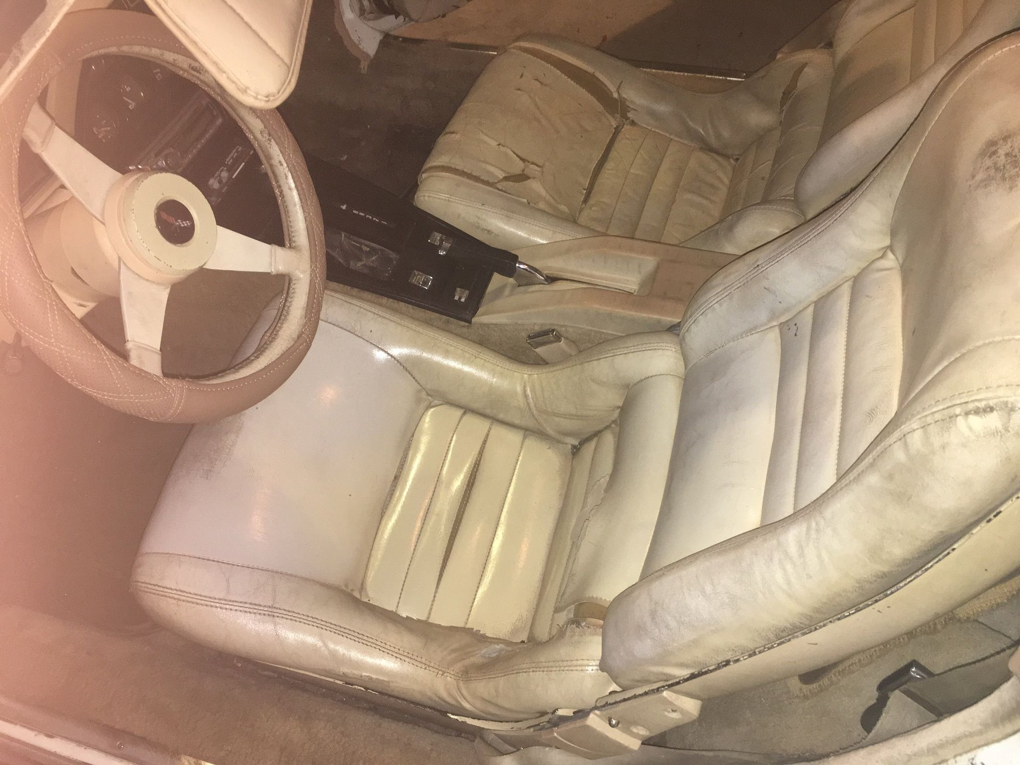

bought it a few months ago. Interior was trashed, been working on getting all of that and some other problems sorted. Also had to do some body work, old tire exploded while it was sitting in the garage. Found the charging issue when I went to get it inspected.

I bought it a few months ago. Interior was trashed and had to do some body work after a tire exploded in the garage. Found the charging issue when taking it to get inspected.

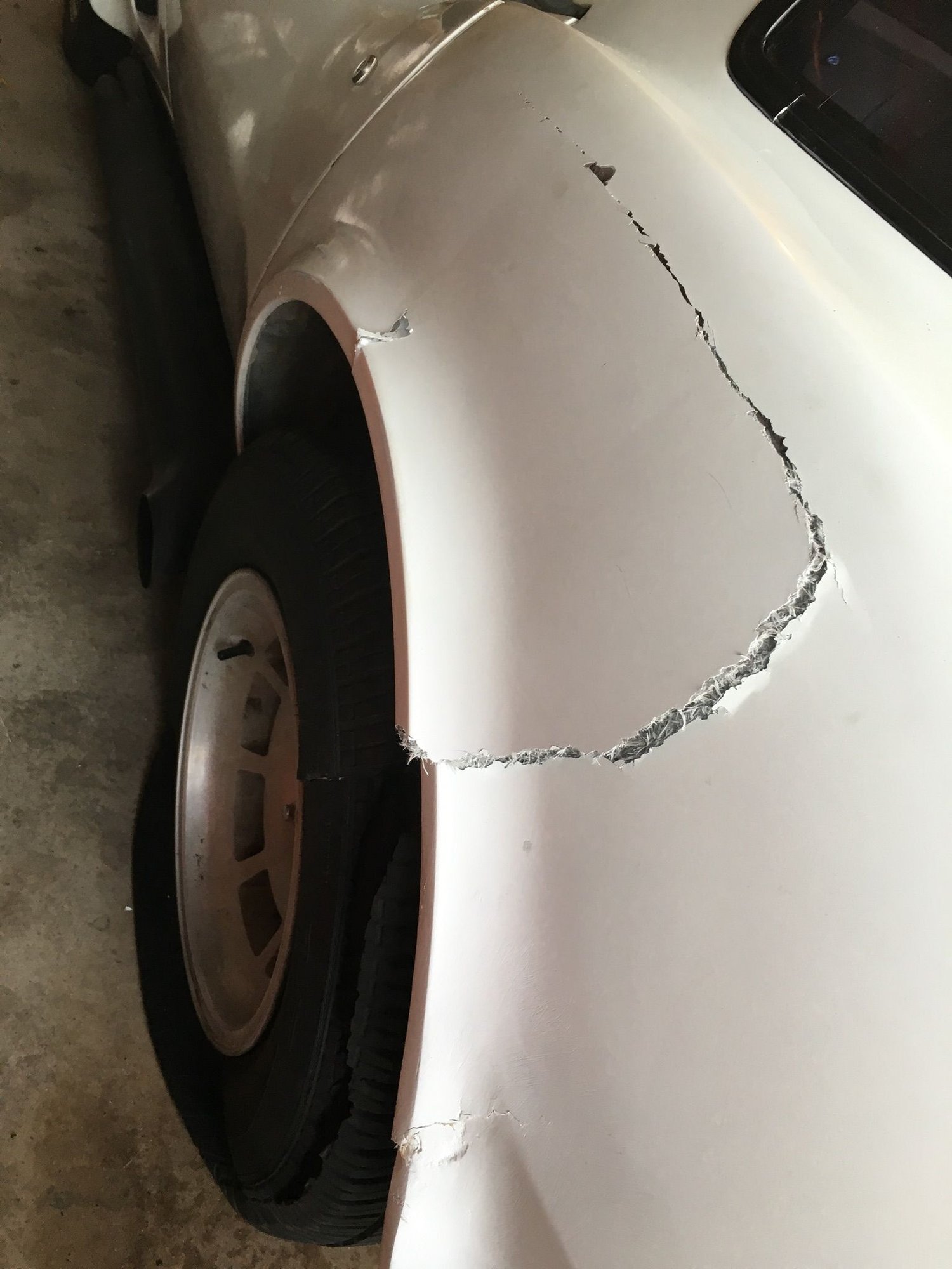

That doesn’t happen every day. How high was it inflated?

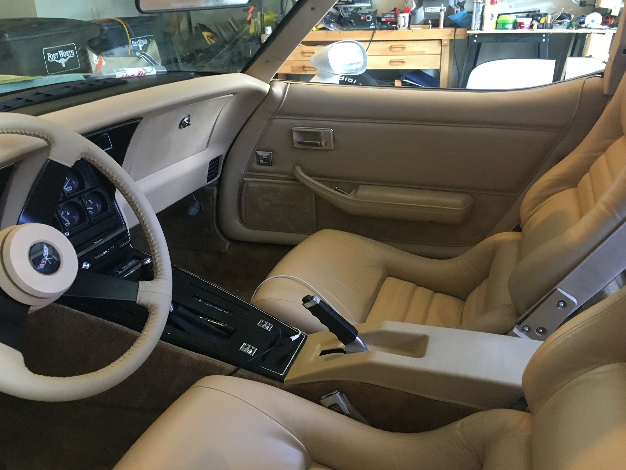

Not sure, it happened a few weeks after I bought it. Tires looked good so I did not inspect them. Turns out they were from 2004, my guess is some kind of dry rot and over inflated. I did not check the other 3, just aired them down as quick as I could.

Looks nice. It's come a long way already.
