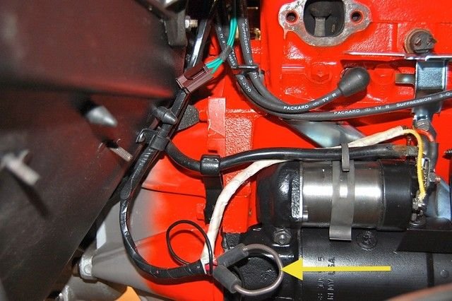

Check your fusible links. They usually get fried when this happens.

I would grab a meter or test light and start tracing power. I agree with the fusible links.

I agree check the fusible links.

Thanks for all the help. Going to try fusible links first then try and track down what is draining battery

Big thank you for all the help. Got her running again, she sounds very happy 😎

Was only the fusible link?
Old Jan 23, 2019 | 08:53 AM
Vette2300's Avatar
Vette2300
4th Gear
Joined: Jan 2019
Posts: 4
Yes but I’m still trying to track down the parasitic battery leak
