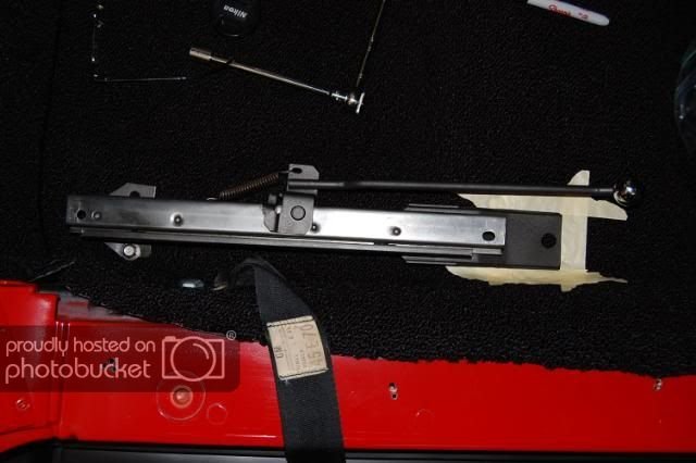

Hey autoalain
I replaced the carpet in my 1970 last summer: there is a single bolt and alignment pin.
Hope this is what you're looking for.

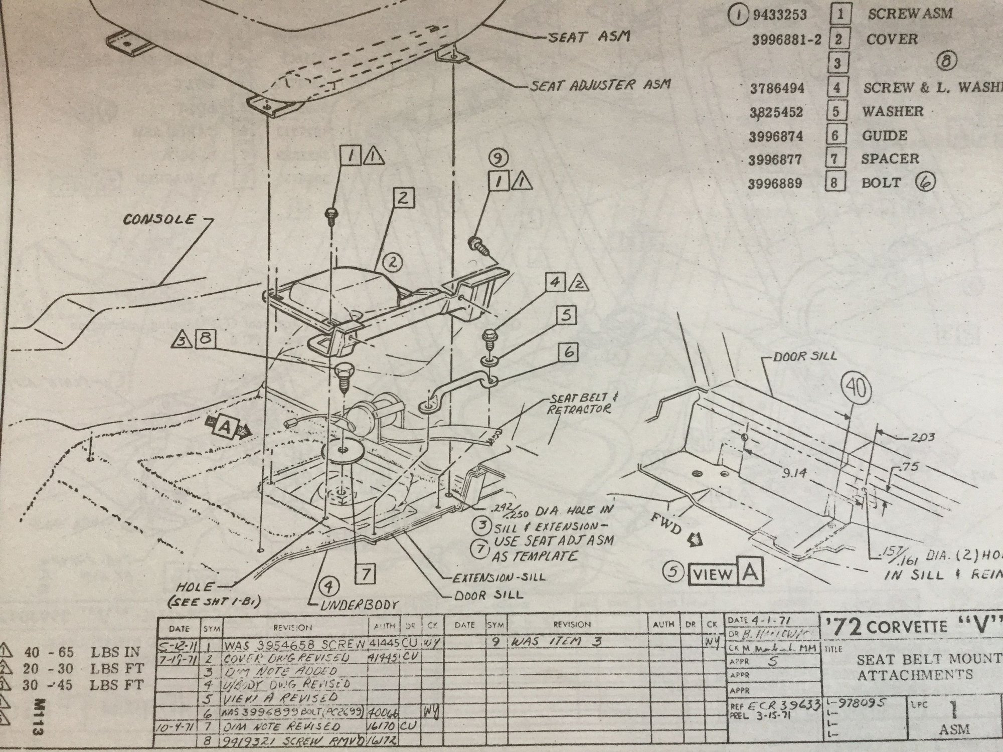

I don't have a picture handy on this but the outer one bolts to the floor under the seat. There is a bar near the sill that the belt goes under then through the carpet up to the seat. There is also a plastic cover that goes over the belt retracter on the floor. Should be in the assembly manual.

Ok, found a photo that should help.

Here is the assembly manual picture. Clears it up a little. You can see the retractor and the bar and the cover all in this picture
OP has a 71 which only has lap belts. Retractors didn't start until 72.
The pic from 70 sting shows the bolt hole for the buckle end.
There's a similar mount point at the door sill for the belt.

Oops. Yes mine is a 72 manual. Doh!

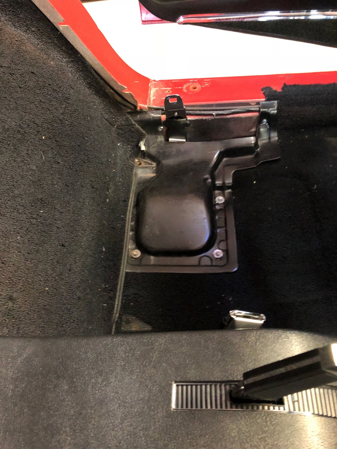

from Alan71's stuff
M

AHHH. the black interior pic is exactly what I need for my 71. this answers all my questions, thanks for taking the time to educate me. Mike.

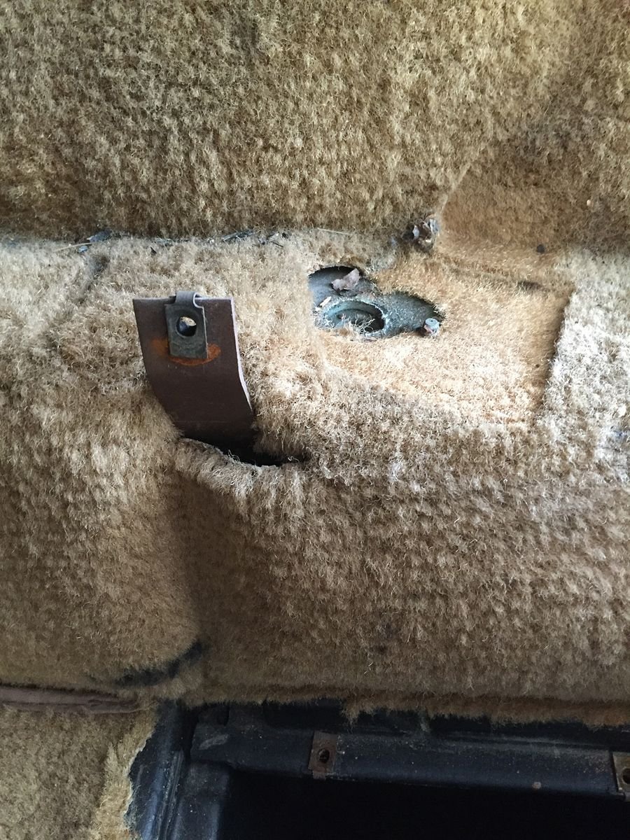

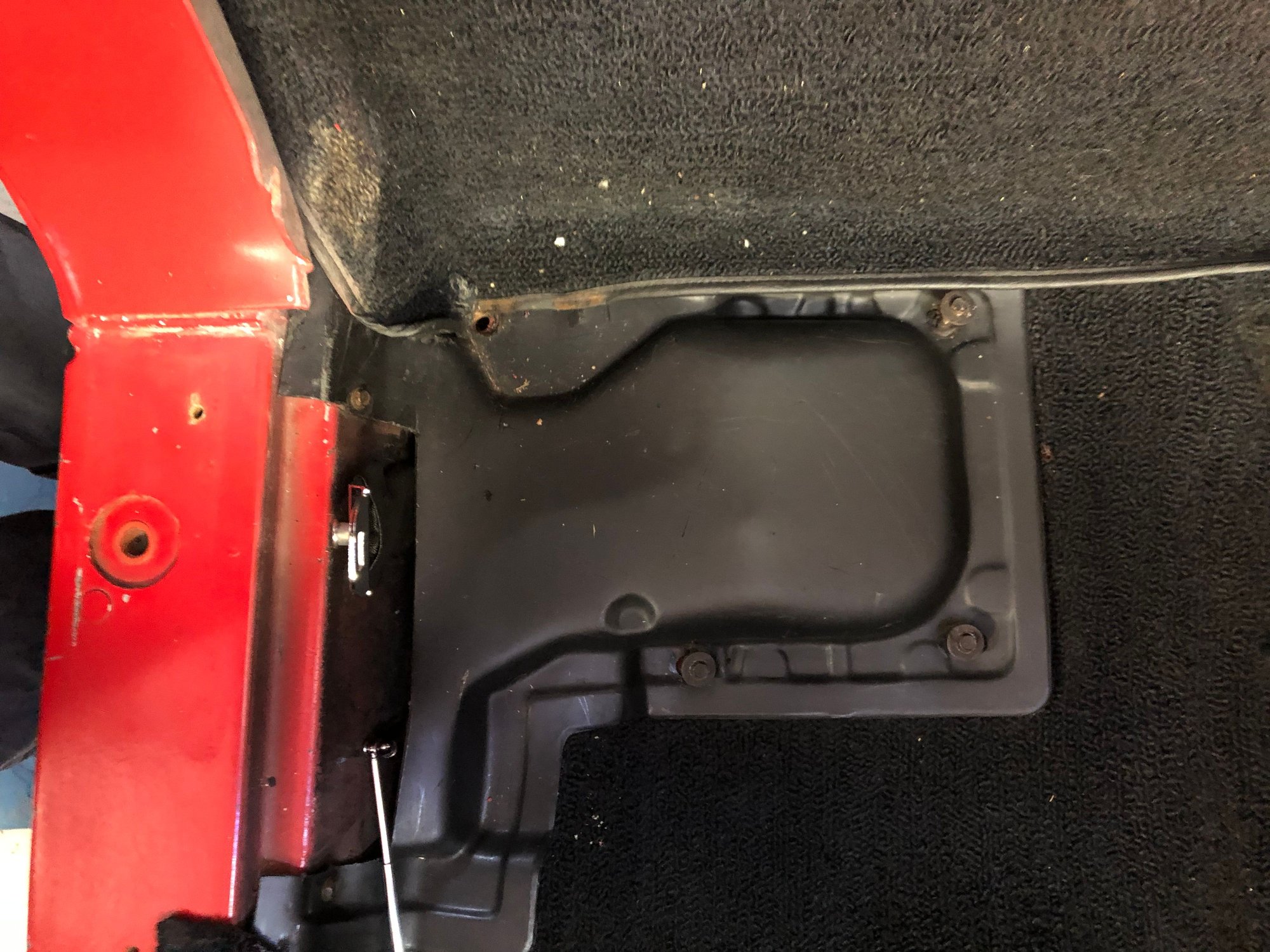

Thanks These pictures may help from my 73 vert.
To outer seat belt attachment pic?
