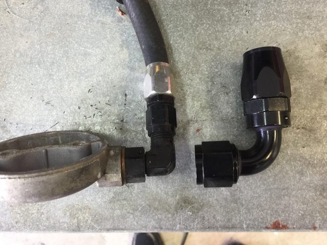

Here is what I had on the Carter 172 pump, and the -10an on the right is what the pump actually required to hit that flow rate. Needless to say, I was not getting anywhere near that flow rate...Not even half. This pump is self regulated at 7 psi so it doesn't need a regulator..... Plumbing it correctly is a nightmare in a vette frame though.

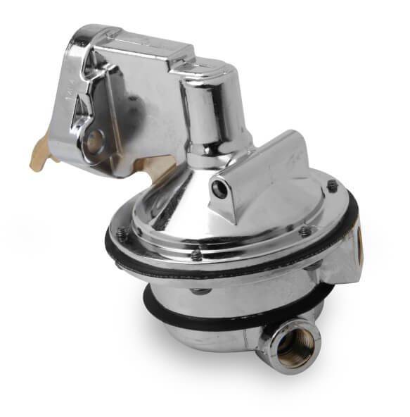

This is the fuel pump I purchased: Holley 12-454-11
Features:
  • High output fuel flow
  • Flows 110 GPH free flow
  • Shutoff pressure pre-set from 6.5 to 8 psi
  • Fuel pressure regulator is not required
  • Heavy duty construction for continuous high rpm operation
  • Fuel body casting can be rotated to accommodate various plumbing situations
  • Inlet & outlet tapped for 3/8" NPT

I started a separate thread before I saw this one. That is the exact pump I installed on Saturday. The ports can be indexed in 6 positions but not in relation to each other, they are fixed about 60 degrees apart. I ended up with the inlet facing forward and the outlet angled forward and inward about 60 degrees from center close to stock. Not the best arrangement.
