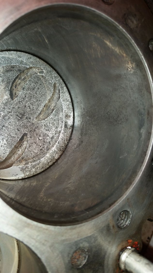

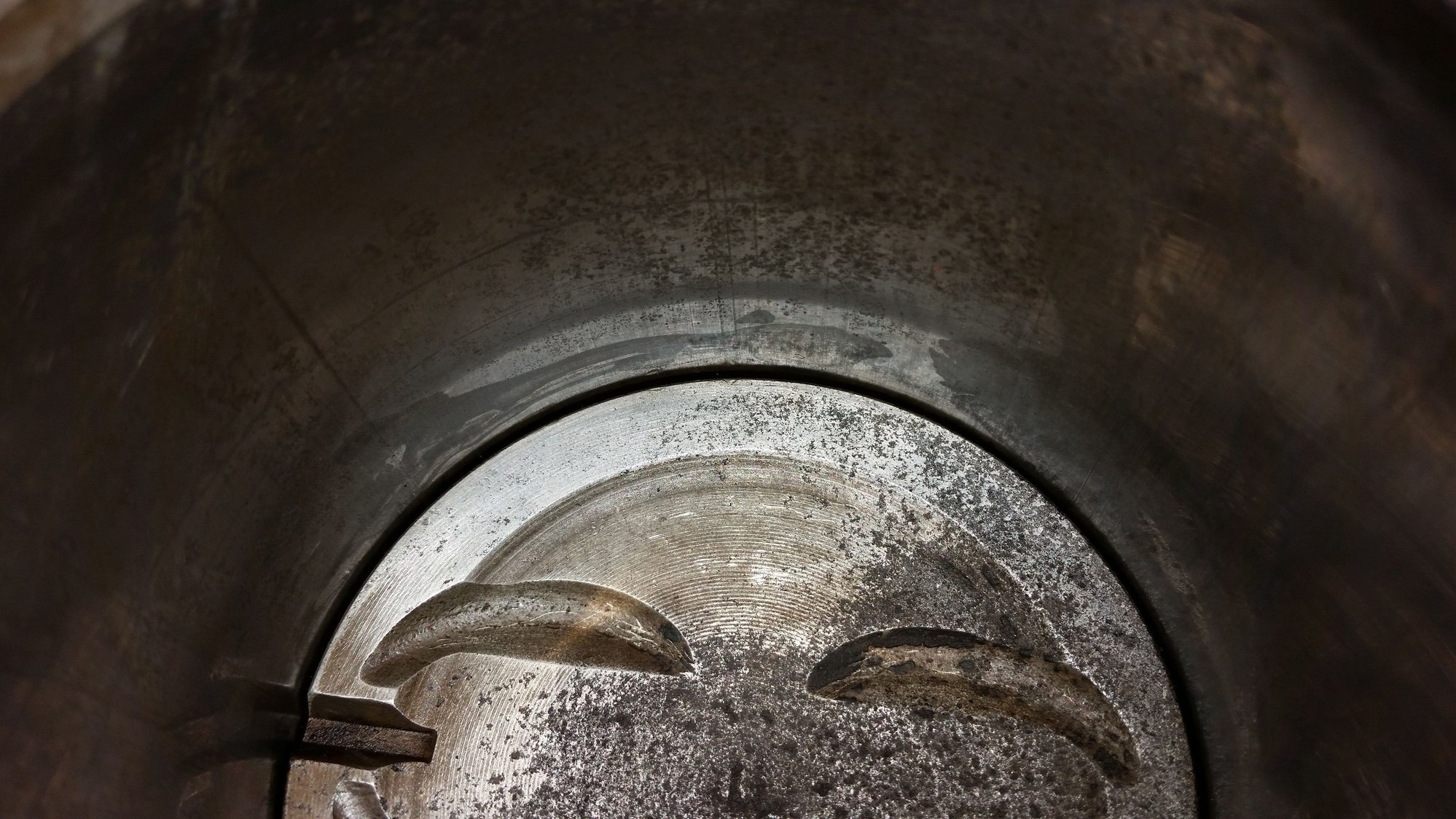

Hi everyone,
I have been working on an upgrade to my 1972 L48 matching numbers engine which includes vortec heads, new roller cam, roller lifters, intake, headers, and exhaust.
I've got the engine pretty far disassembled, with the heads off, and have been cleaning the deck and block as much as possible. Now that I can see into the cylinders, it looks like there is a decent amount of pitting on cylinder #7, and a little bit on cylinder #4.
From what I've read, many times pitting comes from gasket leak, leading to coolant going into the cylinder for extended periods of time. From my novice view, apart from the pitting, the cylinders don't appear to have much if any cross hatching left, and look pretty polished. Although, before disassembling the engine, each cylinder made pretty good compression at about 150 psi, and oil pressure was good, at about 45 psi at warm idle. The engine leaks, and burns oil, at about 1 quart every 500 miles. I'm not sure how much is being burnt vs leaked out. I looked at the plugs, and I'll admit I'm not very good at reading plugs, but I would say they look oily.
I was trying to avoid pulling the engine; I have never done that and fear the pain of putting it back into the car correctly.
I'm leaning toward pulling the engine and getting it bored out, since I'm going through it all right now, but I'm not sure what replacement pistons to get. I think the motor should make about 330hp at the crank (mild cam since I have auto with 3.08 rear) with the cam I've selected, so I don't think forged is necessary. I am confused what piston compression height to get; I see 1.540 to 1.562, but not sure what compression height the stock motor had. Since the vortec heads have the smaller combustion chamber, 64cc, and I was planning to use the 0.015 head gasket, I don't think flat tops are a good idea. Should be about 9.5:1 when done. I see most dished pistons with 4 valve reliefs are about 12.3 cc dish, but not sure how that works with the piston compression height.
What do you all think?
Would you pull the engine, or would you just button it back up to see how much oil the engine is actually burning vs leaking after new valve seals and various gaskets?
Has anyone replaced the stock pistons successfully? Which ones did you use?

Almost looks like there was detonation going on in there and the walls don't look good either. How were the plugs, did they have metallic specs on them? For the brand, I would go with Wiseco forged, but that's just me. They are good pistons and you can get them in any size you want without spending a fortune in pistons. I would let your machinist work out the details on how to go with the machining of the block and then discuss it if you are not happy with the numbers he provides you with. A 10.1 motor would be nice, but if you want 9 or 9.5 then do it.

You have a very good plan for a very good combo.
The bore looks awful. It won't last long with more compression. Have it bored & fitted with new pistons. First have the machine shop tell you MINIMUM that will clean it up; first oversize for sbc is +0.020" & hopefully that's all it'll need.

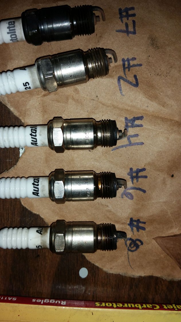

So here are the plugs
Old Jan 28, 2019 | 08:33 PM
mongoose87's Avatar
mongoose87
Joined: Jun 2017
Posts: 495
Likes: 85
More plugs
on the bright side, cylinder #2 looks really good. Ha
Before disassembly I bought a newer Q-jet and was getting it tuned as close as possible to ensure a good cam break in. That's probably contributed to the sooty plugs. Since vortec heads don't have heat cross over, had to get a model with electric choke. The newer model had transfer slots, which I believe gives it more kick, or maybe I just got it more dialed in.
I like the divorced choke better though

Before I committed to boring the block and the new pistons, I'd check the taper and out of round on all 8. Then figure out if it's more economic to bore and new pistons or another block.
It may be that a good hone will clean everything up.
I'd also look at the cost difference between the hypereutectic and forged, remembering that forged will take some detonation with out self destructing. And you're in there, check the crank dimensions- If things are worn to the point the crank needs turned, it may be that it'll be less cash to build a 383.
I'll admit up front I'm not a big fan of the hypereutectic pistons in applications that are not computer controlled. Too easy to make a mistake and go into the detonation zone.

I agree with the others, those bores are done! That pitting needs a bore to get rid of it.
Most stock engines have the pistons at least .020" down in the bore, so getting the max compression height is good. I'd go with low expansion forged pistons.....the extra $300 spent now will provide comfort down the road if you want more.
