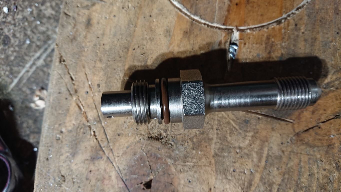

Ive got a GM power steering pump, using the earls adapter an-6 fitting, but i seem to be leaking from it, so not sure where the o ring seal should go??
should be in the postition in picture 2 or 3 ?? or somewhere else, are you meant to use a copper washer aswell or ??

the picture in this link matches your second photgraph
https://www.summitracing.com/parts/e...SABEgIctvD_BwE

its brand new, not even run yet, i had the seal in the 1st pic of the fitting, so i will try it in its new postition in 2nd fitting pic, ive already got a oil cooler on the return line, so good to go there
