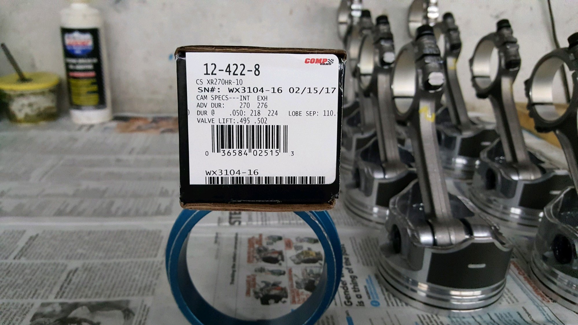

It's 32 degrees at idle. If it matters, it's a 383 with Scat internals, Dart Pro 1 200cc heads, Comp Cams 12-422-8 Duration 270/276, Lift .495/.502, Dart intake and QFT 750.
With vacuum advanced unplugged that is way too much....should be like 14-18 idle and 34-36 at 3000 rpm....the idle timing is no where near as important as the total timing....

383 with Dart 180's and that cam will should be a mega torque beast......tire smoker.
Those heads with the fast burn chamber only want about 32-33 degrees total timing FYI.
