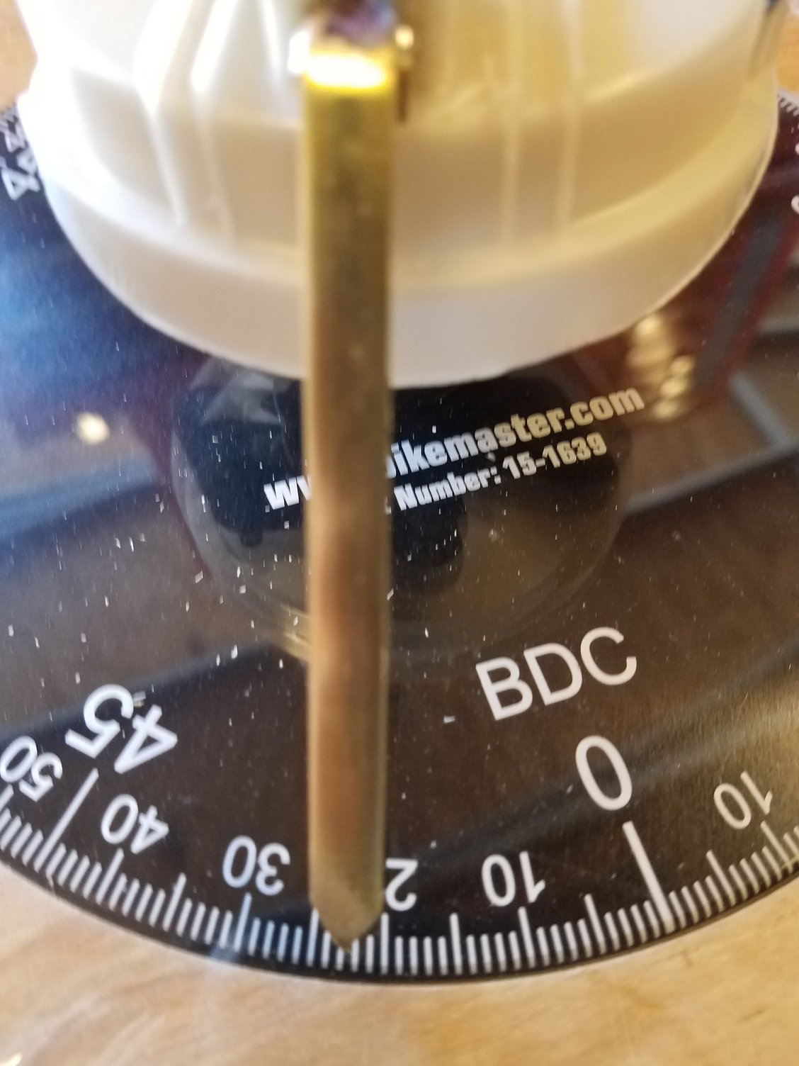

This is a stock assembly for a Street Fire out of the box. Notice 22* ? That is 44* crank degrees.
Do you use the vacuum advance? Or would you use the mechanical advance? If you are familiar with the 8362? Have you changed any of the settings inside of the 8362?
Just questions I have so I can make an informed decision on what to use. I appreciate your input and advice.
Thanks!
I started playing with it this summer, but am shut down for now. I am ;looking at two solutions, but need to try some things first.
You NEED a mechanical AND a vacuum advance for a street driven car.
