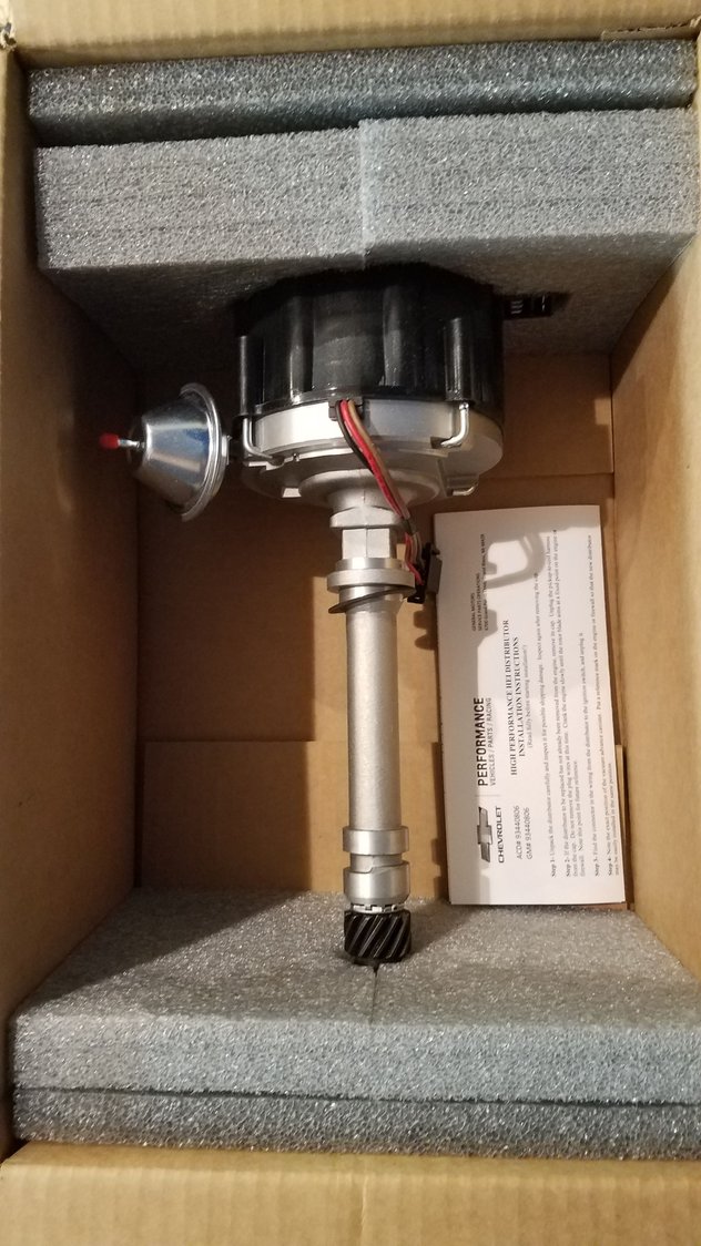

I opened the box finally. This will start some discussion.

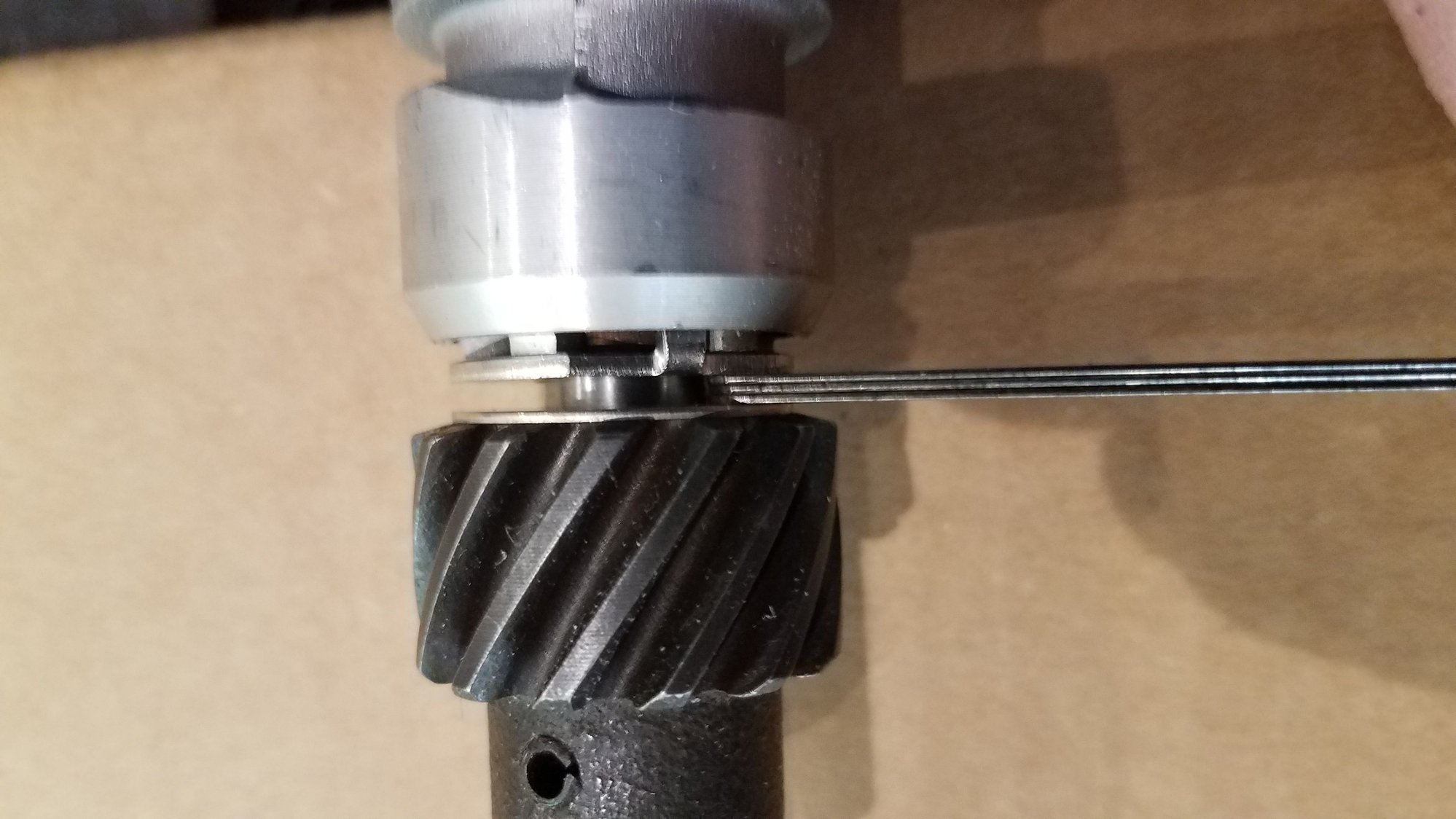

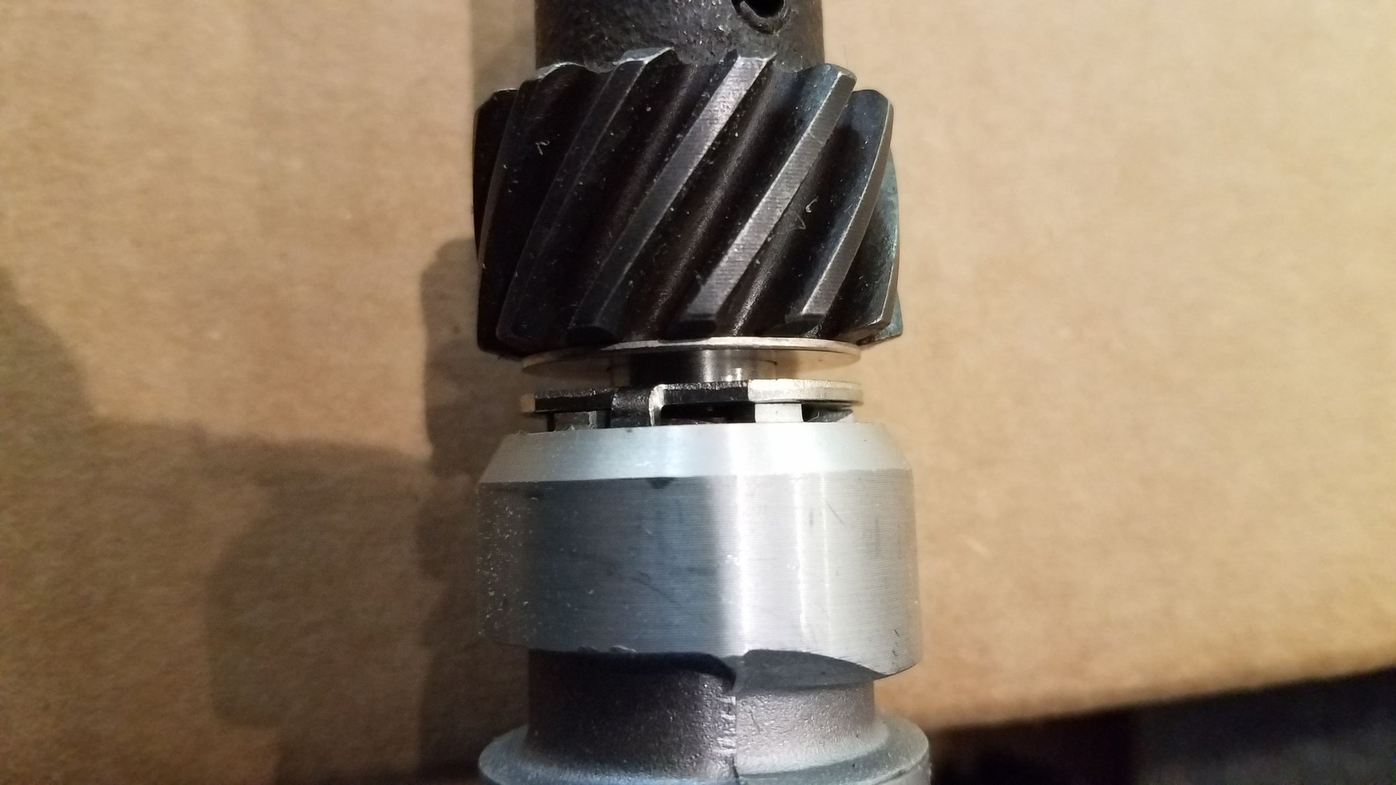

.077" end play out of the box.
wow. what is the story on the dist? what is it for?
last i looked there were only 4 service replacements and they aren't 1 sizes fits all

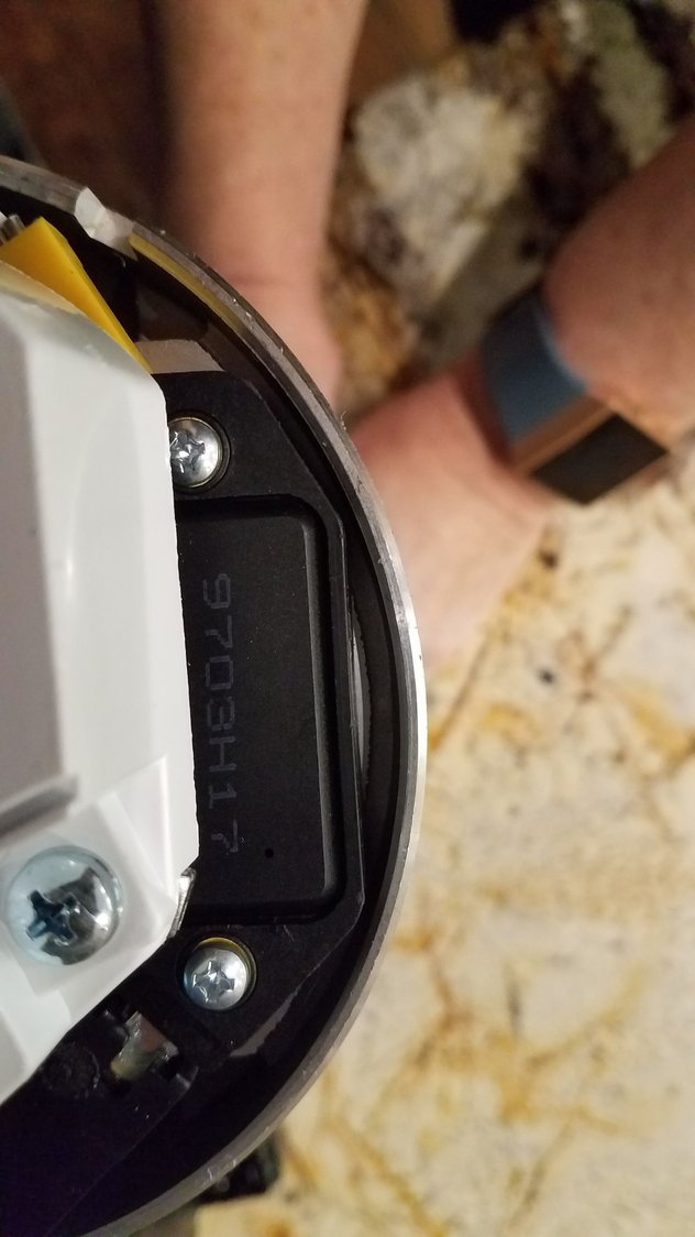

b2b ...did you find any laser-etched numbers on aluminum base?
Notice how the number on module is echoed on white label on cap?

I read the instructions. What did I miss?
Going to need some shims for that gear.

Taking a leap (assume) - they expect a good amount of break-in wear to occur from the distributor gear wearing on the camshaft gear.
Blocking the bypass is something I would always do on a new engine break-in and I certainly did not like the synthetic oil engine break-in I tried.
Maybe a little over the top (or maybe not?).
I leave the by-pass blocked well after the break-in is over. The high zinc dino oil works for me every day.
That new gear does look different than the old ones I am used to seeing. Rougher finish, not machined fully. Maybe it IS different?
