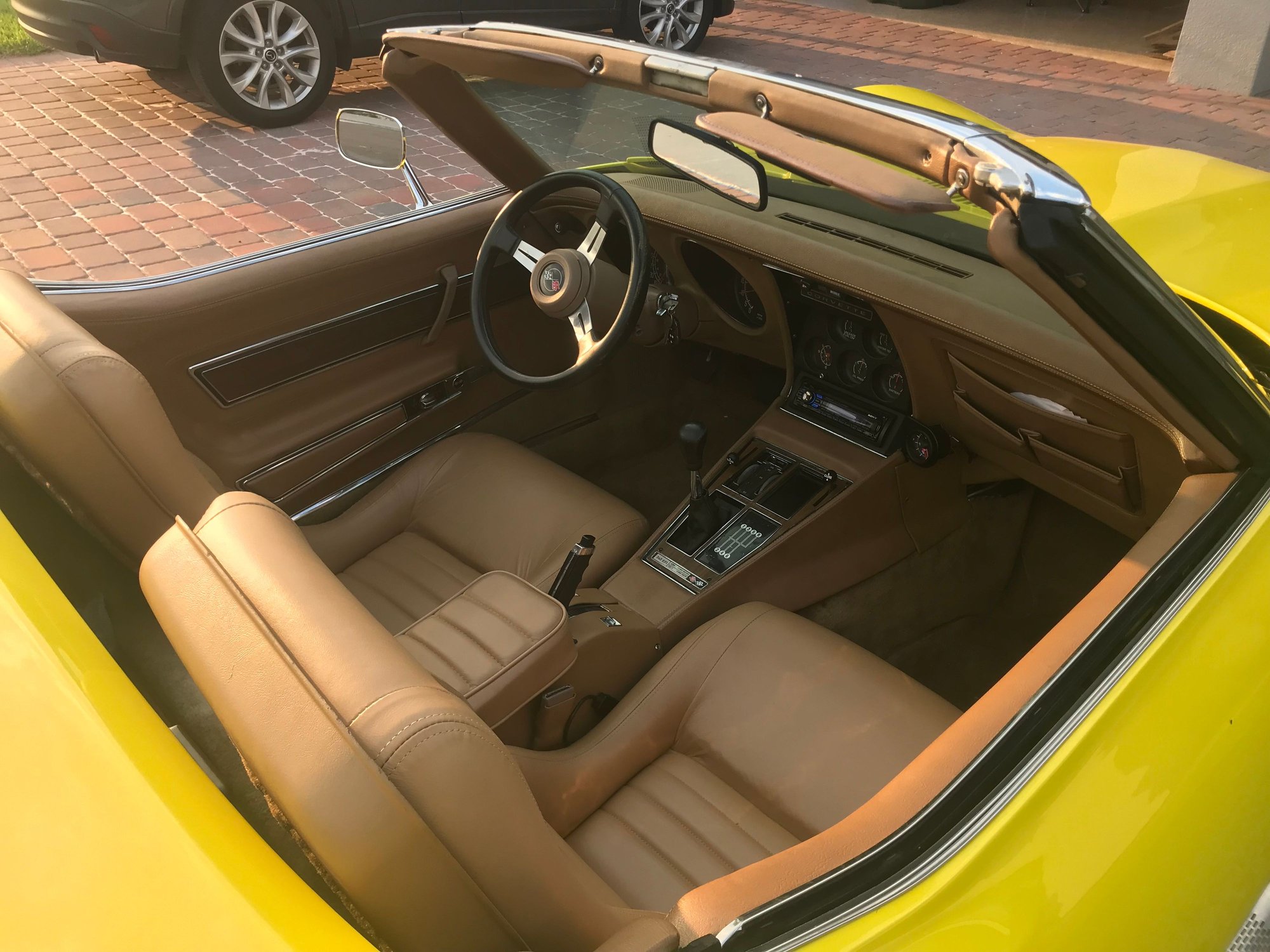

The cushions I bought from Willcox^^^^^^^...100% leather and 4 inch bolsters...you can see they look great!
I found a great deal on the 80 seats for a pair locally for $200

The drivers seat is the one on the floor with the big rip. These are my original 80 seats, now basement gaming chairs. In jb78L-82's image above, the (pre-refinishing) drivers seat is on the left, with the ripped bolster.

Correct...I actually used the passenger seat on the drivers side (I switched them after installing) due to the fact that my 78 L-82 4 speed gymkhana suspension had very few options and does NOT have a tilt steering column (see picture in previous posts but I did manage to source a tilt steering wheel when they used to make them for non tilt cars), nor power door locks, power windows, rear defroster, etc. To give my legs a fraction more room I switched the seats. My car had just the L-82, 4 speed, sport suspension aluminum rims, and AC..nothing else.

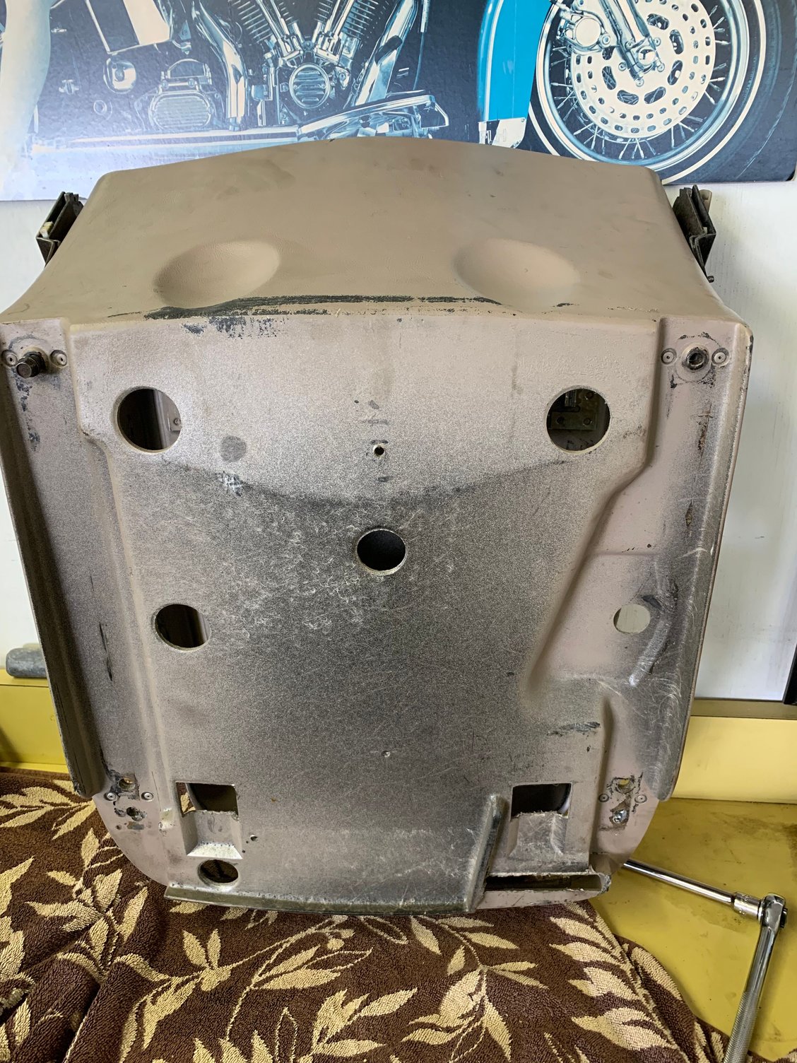

Here are pictures. Discovered one seat has 76 rails and the other 82😬
