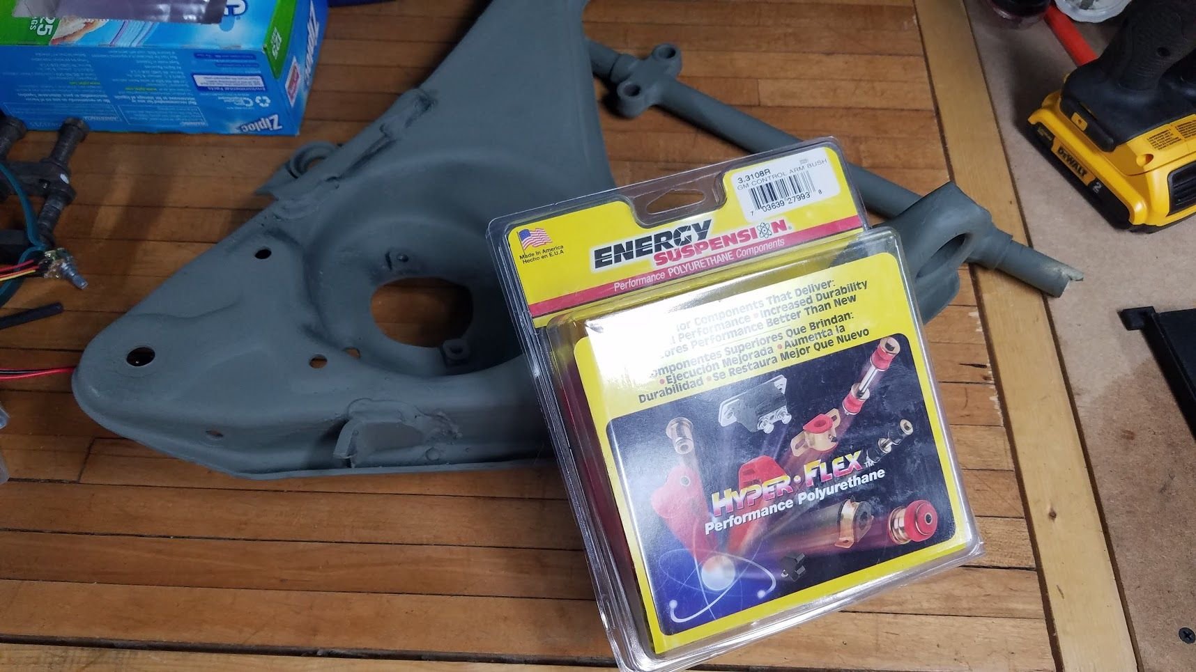

If you want cruise with your car and put on some easy miles, get the best stock-style suspension parts you can. There are lots of options for painting the arms, etc, search the forum and see what works for you. Examples are POR-15, Eastwood chassis black, one of the many SEM products, or just Rustoleum self-etching primer. If you go through the trouble of having them blasted, you may want to have them powdercoated, or at least use a two-part epoxy primer, neither of which you are likely to do at home, but will likely look better than the other options.
Poly bushings can be used anywhere there is a simple rotational movement, so upper and lower A-Arms, for example. The poly bushings may also make it easier to DIY, where the rubber bushings require a press, and may damage parts if not done correctly. Where there is a complex movement (like the strut rods, or the trailing arm bushings in the rear), you are best served using rubber, or heim joints. I'm halfway through a front end refurb, with (red) poly bushings everywhere, having already done the rear (including having the trailing arms blasted and powdercoated, so they look better than the rest of the car).

If the blasters can powder coat, too, that's your best bet. I just wire wheeled and painted mine with self-etching primer.
This is as far as I've gotten, so I can't tell you if I notice a difference, but I don't expect any harshness. The heim-jointed strut rods in the rear did not make the car more harsh, the suspension now just acts correctly. For the other stuff I've replaced, I used all Moog chassis parts, and that helped the steering a lot.
