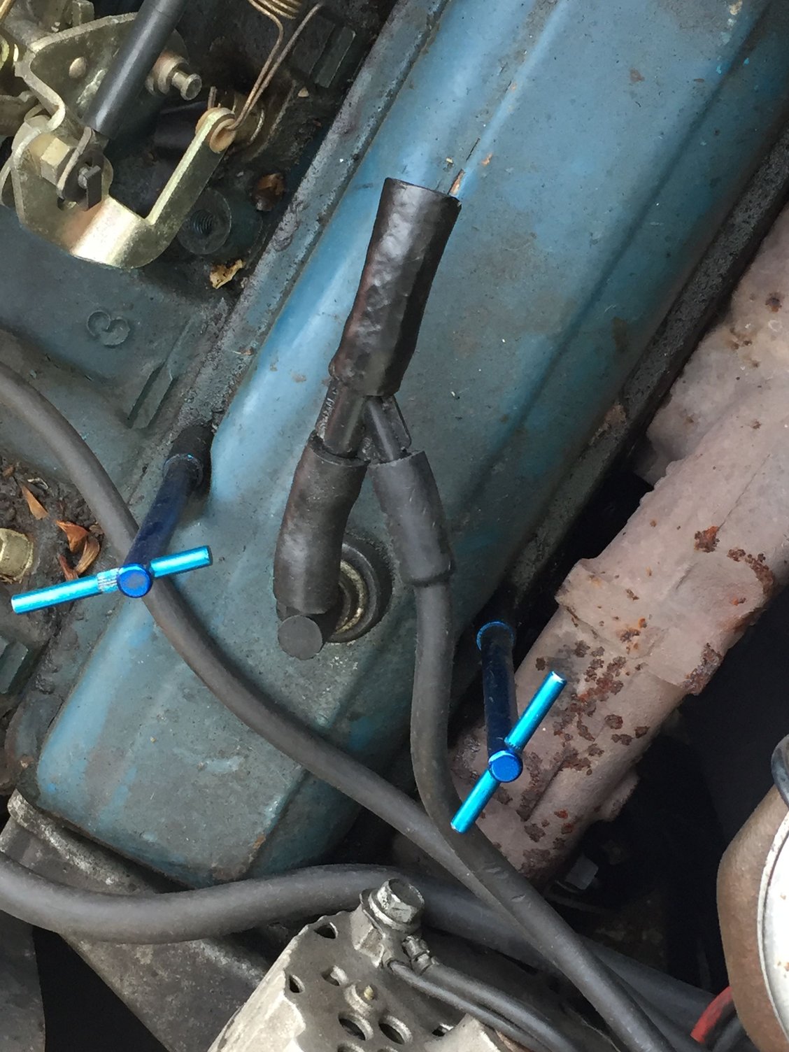

Ok, I took a couple more pictures. What is the yellow sensor coming out of the rear of the intake manifold between the air cleaner and the distributor? It also appears that the pcv valve has been plugged. Does this have any performance ramifications?

The gauge issue could be as simple as a bent tab on the flexible printed circuit board behind the gauges. It's worth taking a look. It could also be a bad ground. The Willcox Corvette website has some great how-to pages on diagnosing specific gauge issues, so you'll be better prepared for what to look for. Now is a good time to pick up a Shop Manual and Vehicle Assembly Manual for your car, too. Repros are available from all the Corvette vendors, and even from RockAuto.
I think the yellow things are just caps to block unused ports from an intake manifold vacuum Tee. In my 80, I just have an "L" in that place, a single right-angle vacuum port.
You'll want your PCV back. In fact, the way it is connected, your gas vapor recovery tank may not work. Do you also have some gas fumes?

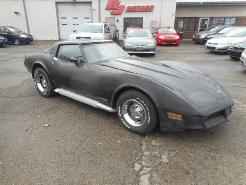

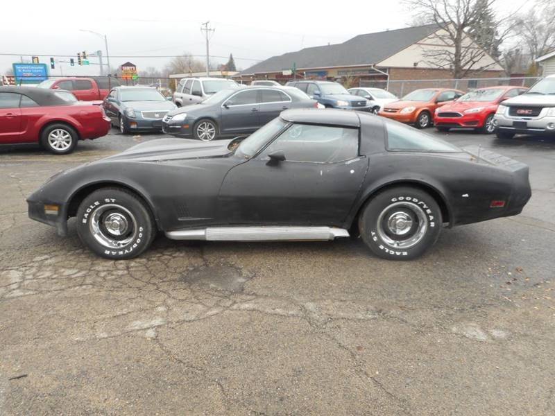

Thank you for the responses. Bikespace, if I understand you correctly, the PCV connects to the gas vapor recovery tank? Is that the line that runs down the driver's side of the car? I just had a roll bar installed and in cutting away the body on both sides I noticed three gas lines, two on the passenger side and one of the driver's. Here are a couple of pictures of the exterior. It's in pretty good shape but the paint is faded and needs a redo.

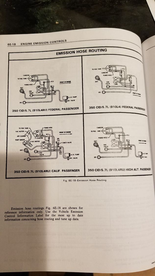

My 80 is missing that plastic Y, so it is connected differently, but in my wife's 79, the PCV valve and the large hose to the gas vapor recovery tank connect to that Y, which then connects to a large port on the carb. I believe there is a second, smaller vacuum hose "signal" (ported vacuum) that activates a valve inside the recovery tank, but the PCV sucks fumes from the crankcase whenever the engine is running.
It looks like you'll have a lot of fun with that car. You probably want to buy some new tires before you take it on the track, though.
EDIT: It looks like the large hose is also connected to the vapor tank and the carb (like mine), and perhaps the signal line is connected to the Y? Is there a second port on your carb to connect the PCV? Your best bet is likely to find a vacuum diagram for your car (1980 L48).

Here's the emission diagram from my 1980 Shop Manual. Just one of many super useful things you will find inside!
