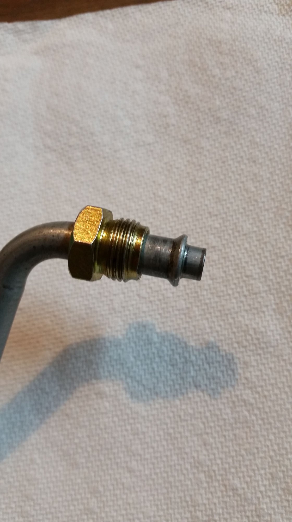

Hey guys,
I have a 1981 corvette 350 stock. I’m replacing my power steering pump and hoses because of leaks. My question is the stock power steering pressure hose that connects to the power steering pump has an ‘o’ring and the replacement that came from a corvette parts vendor doesn’t, the information for the hoses designate they are for 80-82 . When I contacted the vendor their response was they never heard of a ‘o’ ring on the hose. I did notice that the original hose with the ‘o’ring has a different end on the tube then the replacement. Can I assume that the hoses have been updated and this is the new version, are they interchangeable?
Thank you for all your help.
Hose from vendor specifically for 1980-1982
Original hose from my 1981

The 1980-1982 cars used an o-ring on the hose... this is why the hose kit was different from that of the 1963-1979 cars... The hose was different and yes... you'll need an o-ring. it looks like they sold you the correct hose... they just don't know there should have been an o-ring.. It's a standard ring that you can get from your local parts store.
