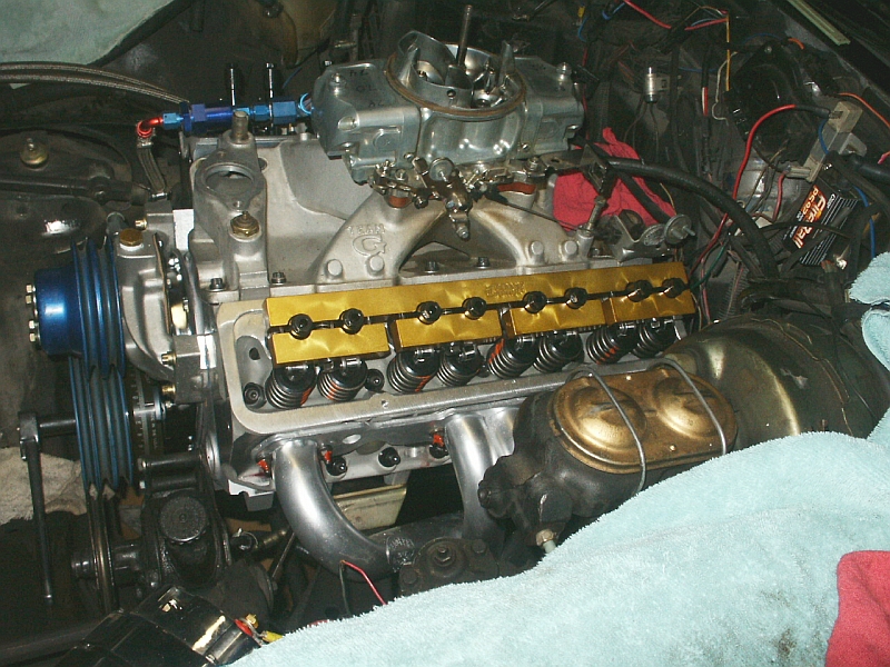

My 7000 rpm 12.70 355 ci with Stage IV TH350 3000 stall and 3.55 gearing. Both the rear end and tranny blew out one season so I got a bullet proof 800 hp handleling 700R4 and a 4.11 Tom's rear end..... Then I decided to get more serious and drop down to 11.70's by putting the car on a diet and installing a totally ARP studded high nickel 4 bolt main 4.030 bore. So I built my 3.750 stroker motor to be able to do 8000 rpm and then set the sequential rev limiter to 7500 to make it last. I spent a lot of time on engine dyno software and figured out that I needed about 11:1 C/R, Dart 227 cc with competition porting, 2.10 intake and 1.625 exhaust, and a solid roller with mid to high .600 lift to actually be making power out to 7500 rpm. Team G single plane with 1/2 inch thermal wood 4 hole spacer and 830 CFM demon carb. Very bullet proof and it has never had any problems, just refreshed every few years because I was also driving it a lot. When you are young it's your life!
It was just a phase in my life and I got tired of having to sit all day in the hot sun and travel to the other division 7 tracks. Local Reno/Fernley Nevada, Sacramento California, Sonoma California, and Las Vegas Nevada. It was a travelling ET bracket series and you had to make the majority of the events to be the season winner.
At first I just did the easy stuff, like gutted under the hood, removed the passenger seat, and spare tire carrier. Later on I spent a lot of money with a new light weight front end and none of the heavy metal. gutted interior, roll cage, fiber racing seat. all in an attempt to be very near the 3000 lbs with driver minimum for Vintage production road racing and I moved up to a 7500 rpm 427 SBC and a 5 speed manual. It's best et on a non prepped track and road racing slicks was 10.96 at up near 7200 feet ADA
This is my original 383 when I first installed it! Like 1994 or it could be pictures of a later refresh
