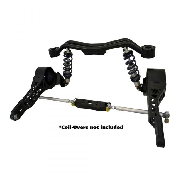

Hi All,
I am going to attempt to get "American Force" 20x14 wheels installed in the rear of my 69 with offset trailing arms and fender flares. I am also going to shoot for 18x10s or 18x12s up front with the Mickey Thompson radials on all 4 corners. the 28x18R20s in the rear or contingency plan the 28x15R20s in the rear if the 18s are too too wide. And the 26x12R18 or 26x10R18 if the 12s are too wide. I think I can manage the 12s up front. The wheels are key, American Force seems to be very affordable and very pretty for what you get vs other companies that can run 2-3-4-5 times as much for the same size. Now I am picking a standard 5 spoke wheel nothing too crazy, but I must say the Torque Thrusts are just over done soooo many have picked them and I like them too but I want to do something completely different that others do not have.
American Force INDEPENDENCE wheel Comes in 12-13-14-15 inch widths and 18-19 and 20 inch diameters. Shooting for 20x14 rear and 18x12 up front if I can massage them all in with the correct offset/backspacing etc. with the Fender Flares I have access to......we will see.
Mickey Thompson Sportsman SR Radial Tires
Just wondering if anyone has attempted ANYTHING as wide as these in the past without having to convert the whole car to a race car with narrowed solid rear axles and chop the frame and fiberglass in the trunk area to hell and back before? I want the car to handle like its on rails, So the more I push the wheels OUT from the car the better it will handle vs making it look like a funny car and have everything tucked in behind the stock fenders on all 4 corners. Not liking that look at all. I get it has a purpose but not what I am after. I do not want to go full wide body with those squared off rear fenders and all that just nice wide 4-5-6 inch flares in the rear and 2-4 inch flares up front is what I am proposing to do and cut the original fiberglass open pretty wide and high so you do not even see a seam where the new flares go on and it looks like its supposed to be that way from the factory.
Just wanted to see if anyone has taken what most do with the standard 15-17-18-20 inch wheels running 10-11-12 in wide and pushed it to the extreme and made it work?
Doing simple math, stock wheel I think is 9 inches so +2 for the offset trailing arms, and + 4 for the rear flares should yield me about 15 inches of width so a 14 in wide wheel SHOULD be okay and manageable taking into account the flares come down and I do not want the tire to slam into the inside edge of the flare so by taking it in 1 inch from the outer edge of the flare should yield me enough space that at full suspension compression it will JUST miss the flares inner surface. I can always put custom bump stops in to make SURE the suspension does not allow the tire to rub and with either VanSteel or Global West tubular trailing arms and A Arms the front should be able to have the inner fender wells cut and molded to allow the extra space to get the wheels to turn just about all the way before it touches the frame rails and the flares up front can be placed a tad wider to allow for the extra travel space needed to swing a negative offset rim from lock to lock, and again can utilize bump stops to ensure the wheels and tires do not touch the frame rails.
So what do you all think? I would opt for the 18s on all 4 corners but I do not believe Mickey Thompson makes the 15 and 18 inch widths in their Sportsman S/R Radials in the 18 inch rim diameters, You have to bump to 20 to get those or drop all the way down to the 15s to get those widths and I just can NOT do the 15s on a car im doing up as modern and "today" fresh as I can create it. This car has the 1 piece flip front end from Ecklers from a long time ago and some meat head put a turbo 350 in it and yanked the original Muncie 4 speed out of it so I am going to put the 427 and Muncie back in it as it should be.
So am I insane or can I pull it off, Any tips, tricks or advice would be greatly appreciated.

First off, BEAUTIFUL Car!!!! How wide are your flares? 4 inch in rear 2 inch in front? Do you ever have any rubbing issues front or rear? Can you turn your steering wheel lock to lock or do you have to stop just shy to prevent rubbing the frame rails?
I was going to do the offset rear arms to allow more back spacing for the rear wheels which is how I was going to try to get a 14 inch wide wheel under it with an 18 inch wide tire under there. It SHOULD fit as long as the suspension has a bump stop to keep the tire from rubbing the inside of the flare. Sort of like a little prevention in case I hit a dip in the road and the car wants to squat down fully. With my old supercharged 80 vette I had 2 exhaust systems, the side pipes with the electric cut outs and a full system exiting the rear and when I would hit a dip the electric cut outs would scrape the ground so I learned where the ruts were in my local area and would approach them on an angle to have all 4 wheels go over the rut or dip individually to keep the car from squatting all the way down but Id prefer to avoid that with this car and ensure everything is tucked up as high as I can underneath and the wheels being 28-29 inches tall should provide adequate ground clearance for the exhaust because I plan on doing the 2 full exhaust systems again because I liked how I could open and close the side pipes with the flip of a switch in the center console and allow them to cool off before I get where I am going to prevent me from burning my legs. Short skirts and side pipes are not the best mix to be honest.
So you have no rubbing issues with the 26 inch tall tires front or rear? Unfortunately Mickey Thompson makes the tires that wide a little taller than 26 so I need to make sure the flares I install are high enough to clear with the suspension compressed fully. Most likely the car will have a slant like most old school muscle cars do with the *** end a little higher than the front as opposed to the leveled look of most cars today. If its what I have to do to stuff 18 inch wide steam roller tires under it then so be it. I can live with that. There will have to be some give an take with something this drastic.
I am going to order one rear wheel and one front wheel and ensure their fitment first, then ill order the tires afterwards and see of i can make some wood tire holder with the correct dimensions that the wheel has and see if it rubs or touches anywhere and make any modifications I need to before I mount the tires on the wheel cause once you mount a tire they wont return the wheel or return the tires so that's the key This is going to be pricey with the wheels running around 800 a piece and the tires at 450 each I dont want to have to eat a mistake and end up having this stuff sitting around unusable and a constant reminder I screwed up royally
