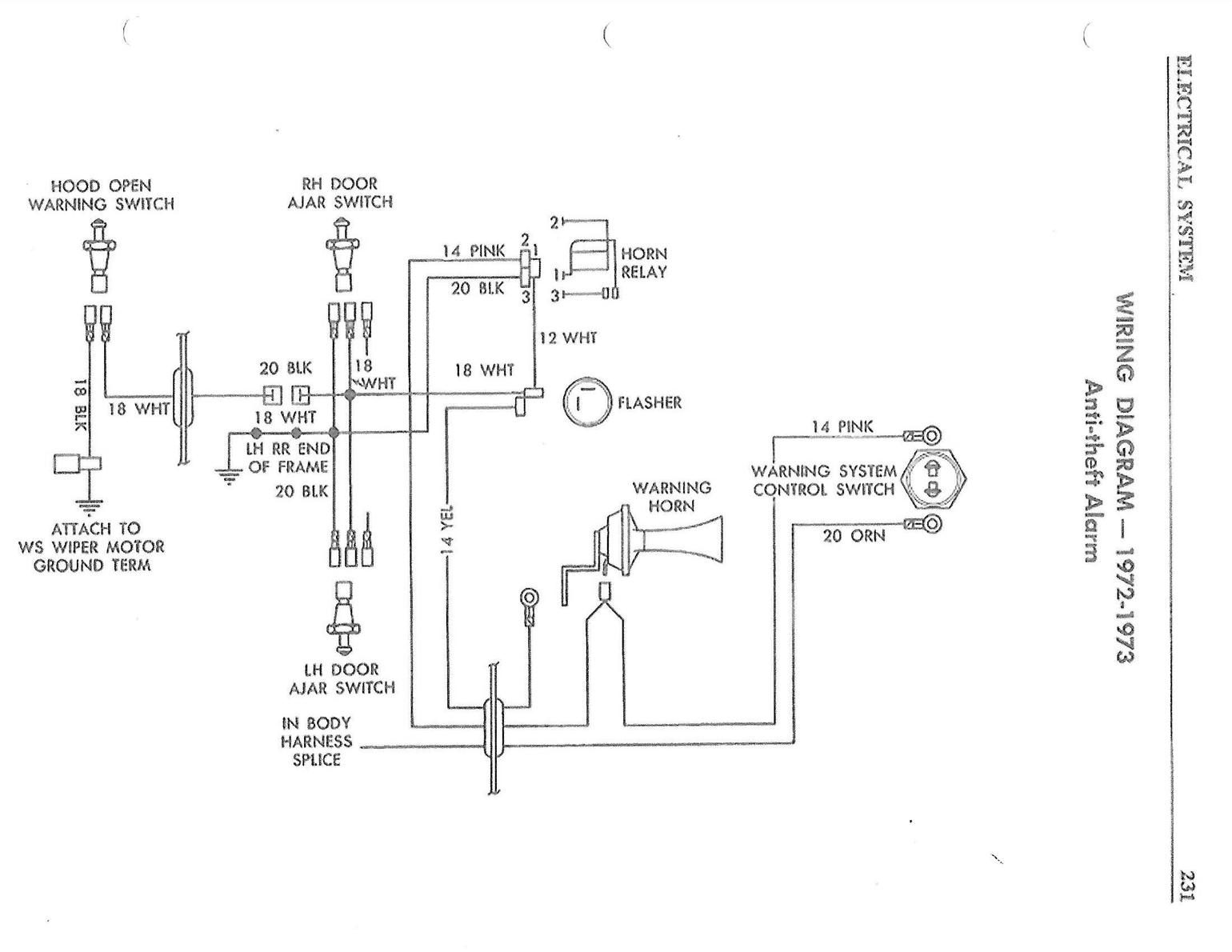

I've got two switches on both doors, and none on the hood.
From what I've read here, sounds like one set is for the door ajar light, which works.
Unsure about the other pair? Factory alarm? Something aftermarket someone added later?
Did Factory Alarm include a hood switch?

Alarm would have switch for hood,and would have keyed switch above the Corvette letters along the back.
The switches on the body at rear corners of doors are door ajar switches. The ones on the body at the front of the door are for the courtesy lights.

The switches in the hinge (front) are for the courtesy lights and the left switch will have one more wire for the 'key left in ignition' buzzer.
The rear switches are for the 'door ajar' and 'alarm' wires.
Yes, you should have one more alarm switch near the wiper motor.

Yes. The UA6 section of the AIM shows the factory installation (including the hood switch) and lists the original part numbers. Keep in mind, the alarm was optional.

HI. I have a 69 with the factory installed alarm. The alarm is set off by the two switches at the front of the door frame ( same ones that are for the courtesy lights ) and the switch on the right side under the hood.

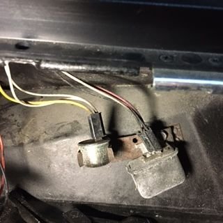

I thought my 73 was also missing the alarm relay and flasher in the jack compartment.
It wasn’t until after I removed the seats and pulled the liner from the jack compartment that I noticed the relay and flasher tucked tight against the back of the bulkhead down in a corner.
Even with the seats out they were hard to see.
