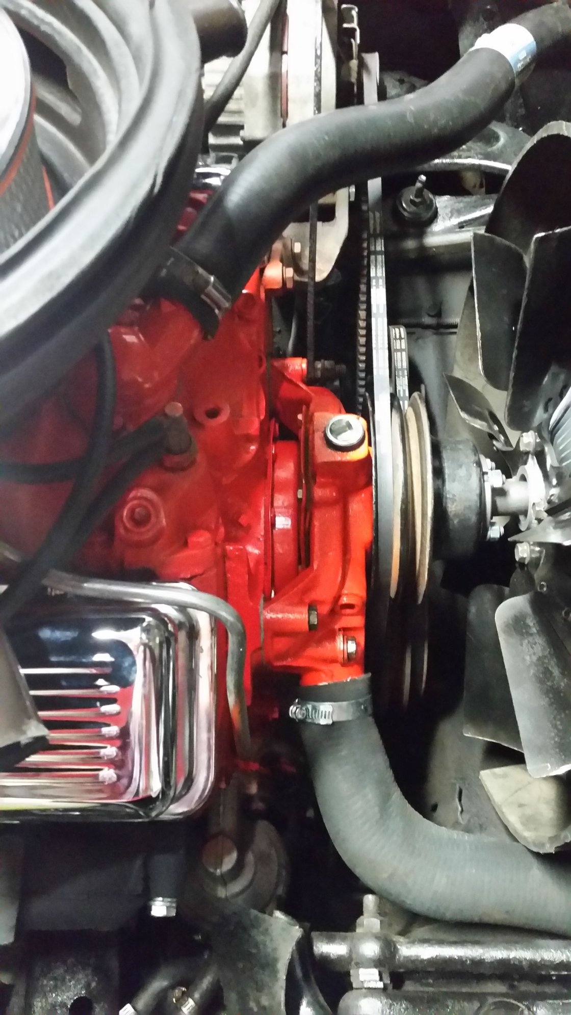

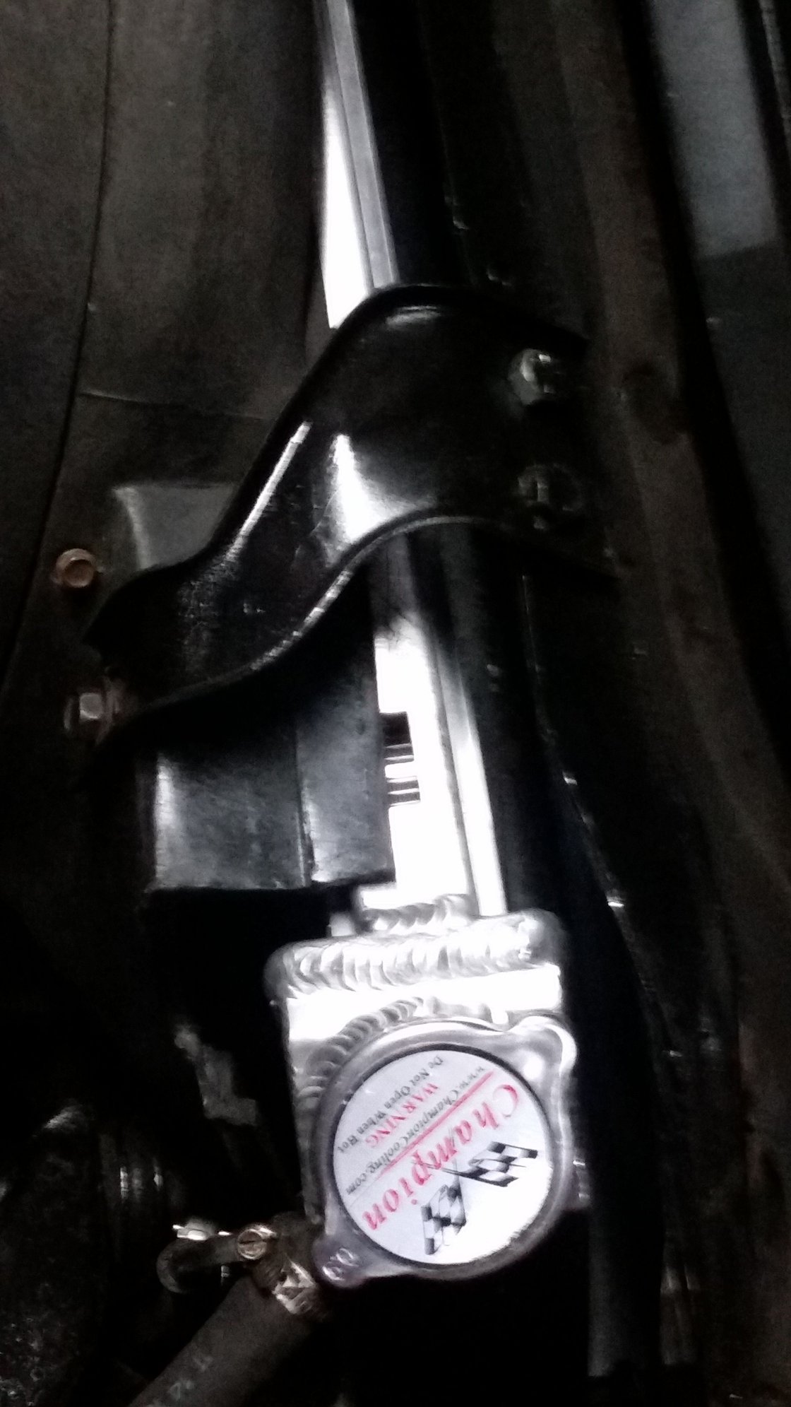

Finally finished my cooling project yesterday. Ended up with a Champion radiator only $204 delivered. Added a new water pump and new hoses, thermostat, fan clutch, and new rubber hoses for the transmission fittings.

Sheet metal plate on back of water pump rusts out. Not worth tearing off shroud, fan, pulleys etc to replace it next month or whenever. Mucho easier now...

Of the 99.9% of SBC waterpump failures I have seen, its due to the "weep hole" leak on the bottom. Never seen the back plate rust through. Seldom does the bearing and seal fail.
Its not a bad job to replace the pump in the future and no you don't have to remove the shroud. Just clutch fan, belts, four bolts, one Rad hose, one heater hose.
Those cast iron units seem to go forever. I would hang on to it.
Every time a W.P. replacement problem pops up on this forum, its about an aftermarket unit not fitting correctly, wrong shaft size, wrong pulley spacing or poor fitting and sealing at the block.

Don't forget to replace all the foam strips that seal the rad to the support. Not having a complete seal causes temps to rise when driving slow or stopped.
