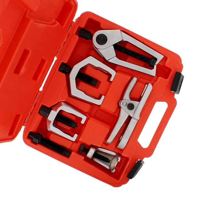

Here's a pic of a set that's available by searching for Ball Joint Separators
I have a few of the c-shaped separators in different sizes (in the middle of the set). They work fine once you get the hang of them. Much better than a pickle fork.
I haven't tried the big one that pivots in the center, but have heard that they work really well if you have room for them.
Personally, I think the pickle fork only works well in situations where you still have spring pressure trying to pull spindle loose, like in the case of our upper joints.
If you are using it that way, be sure to leave the castle nut on, but loosened, so that it doesn't completely separate and injure anyone with a flying spring or anything else.
Good luck with your project.
-Chris
