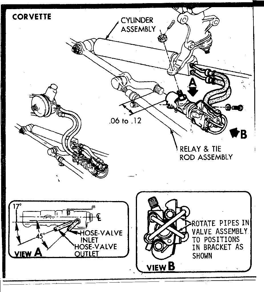

Default 72 LS5 PS Hose Routing
Could someone please get me a picture of the P/S hose routing. I have a 72 LS5 and have new hoses, but the pump to control valve hoses do not seem to fit correctly. I have the AIM and Chassis Service manual,but they do not have good pictures.
Thanks!

Default Does this help?

Thank you.
