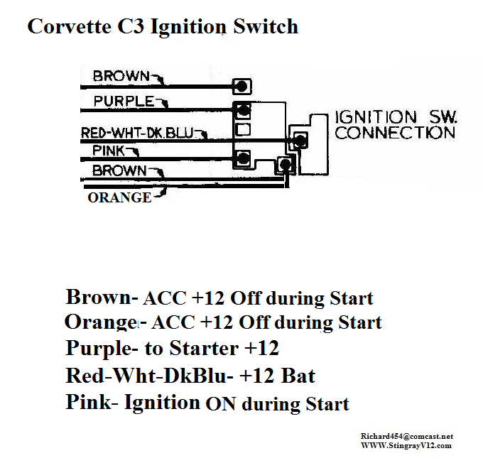

If you want to "hotwire" it-
here's what the wires do at the ignition switch-
This is good info. I have been frustrated that my radio blanks out and looses presets everytime I crank the car. I thought I had the correct constant power wire but I must have it connected to one of the wires that goes off during cranking. I incorrectly assumed the inexpensive radio was sensitive to low voltage and turned off because voltage drops too much during heavy load during cranking.

Originally Posted by Peterbuilt
It might be easier to plug the memory radio wire into the 'BAT' terminal in the fuse box.
Hey Peter-
The ACC on the fusebox will also have power when the ignition is on but not when starting.
To Hot wiring a 76 Corvette.
Hey Peter-
Hi Richard,
Your knowledge of electronics is far superior to mine but I thought that 'Greengear' said that he was losing his presets each time he starts the car.
If he connects to the ACC terminal that will still be the problem and that is why I suggested that he use the 'battery' terminal in the fuse box.
Maybe Greengear can post his radio diagram.
Here's mine:
