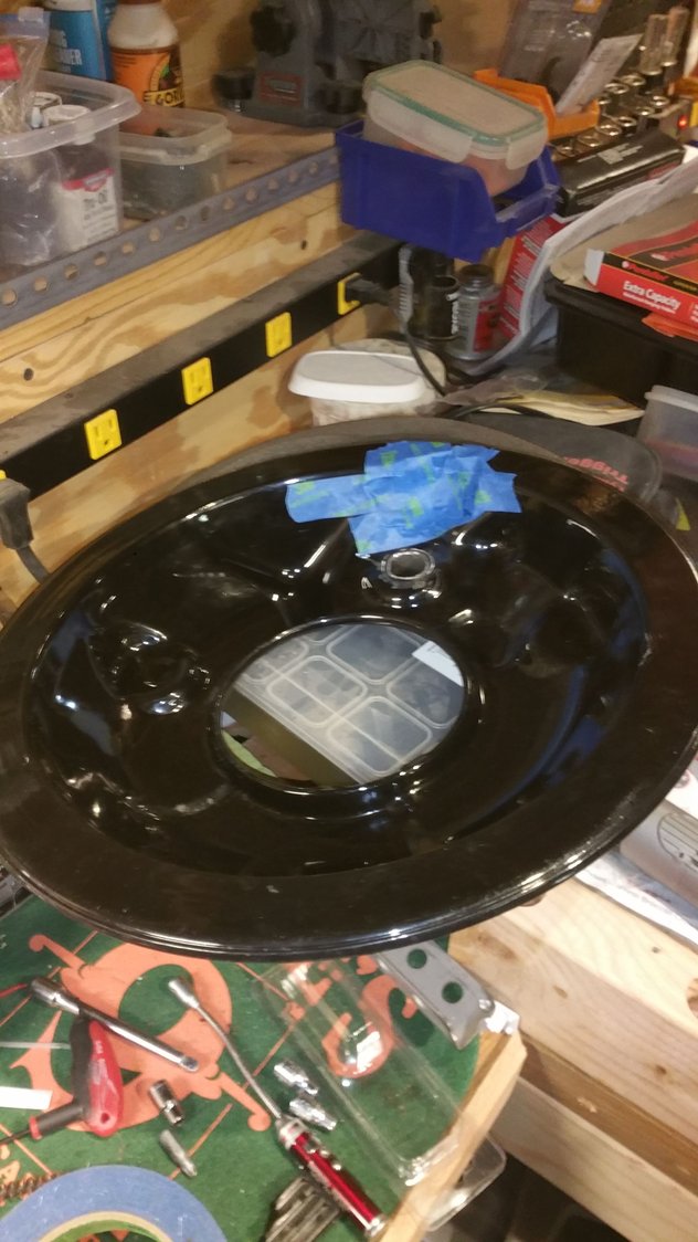

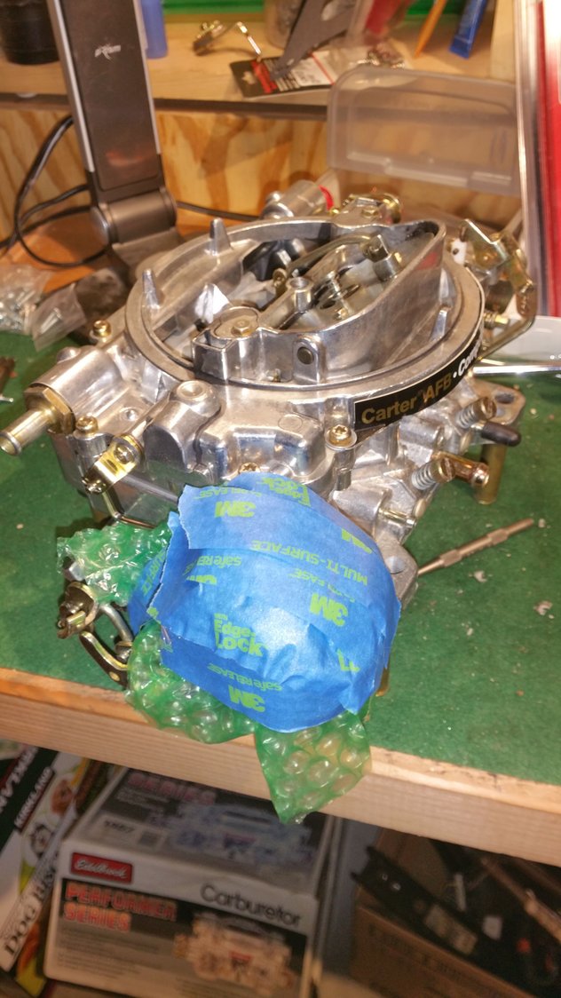

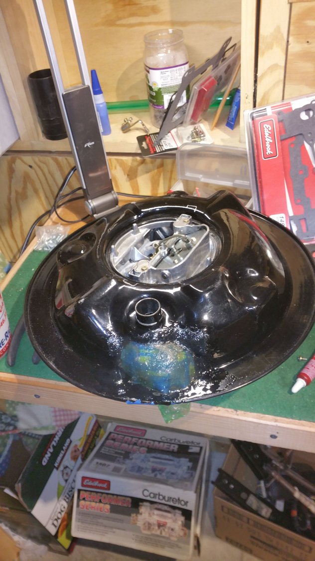

I had to mod the stock low rise bottom air cleaner to get it to fit. I lot of dremel and fiberglass to work around the electric choke. It worked good though. You could do something similar to what ever drop base you find if it still rubs. Be careful of shorting out the positive lead on the choke.
padded up the electric choke. Make sure you get enough room that the power lead doesnt ground out on the air cleaner. I would trim a little and test fit it, then trim a little more until i had an good openning. I didnt take pics of that though.

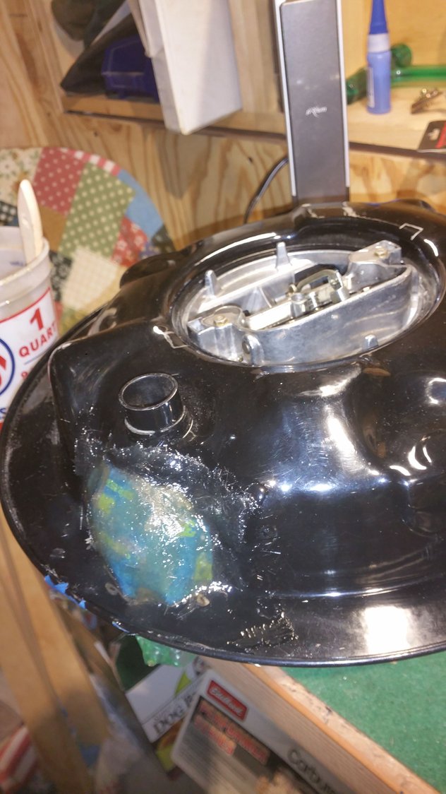

a little reinforcement to keep the inside clean and to get the needed shape to clear the choke. I had to chop off the intake hose fitting too
A view of the little dremel work needed to get the room for the choke. I added tape on the inside for the shape I needed, then a little to cover the exsposed tape on the outside
when it dried I peeled off the tape and repainted it

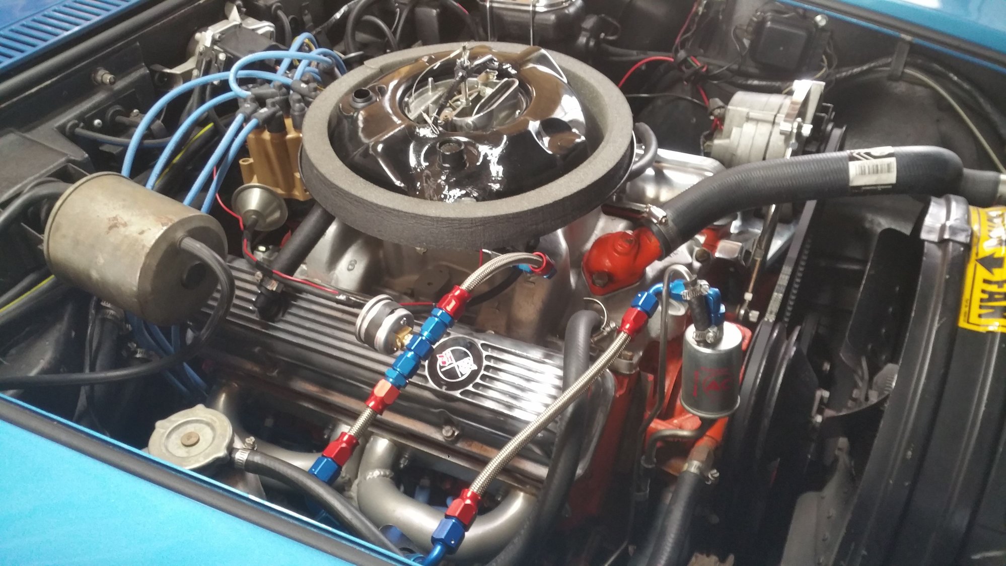

I added a cross bar with a provision to bolt down the air cleaner and a fishing lead with swivel to retain the wing nut incase i fumbled it into the carb. I did this because I used a cold air intake

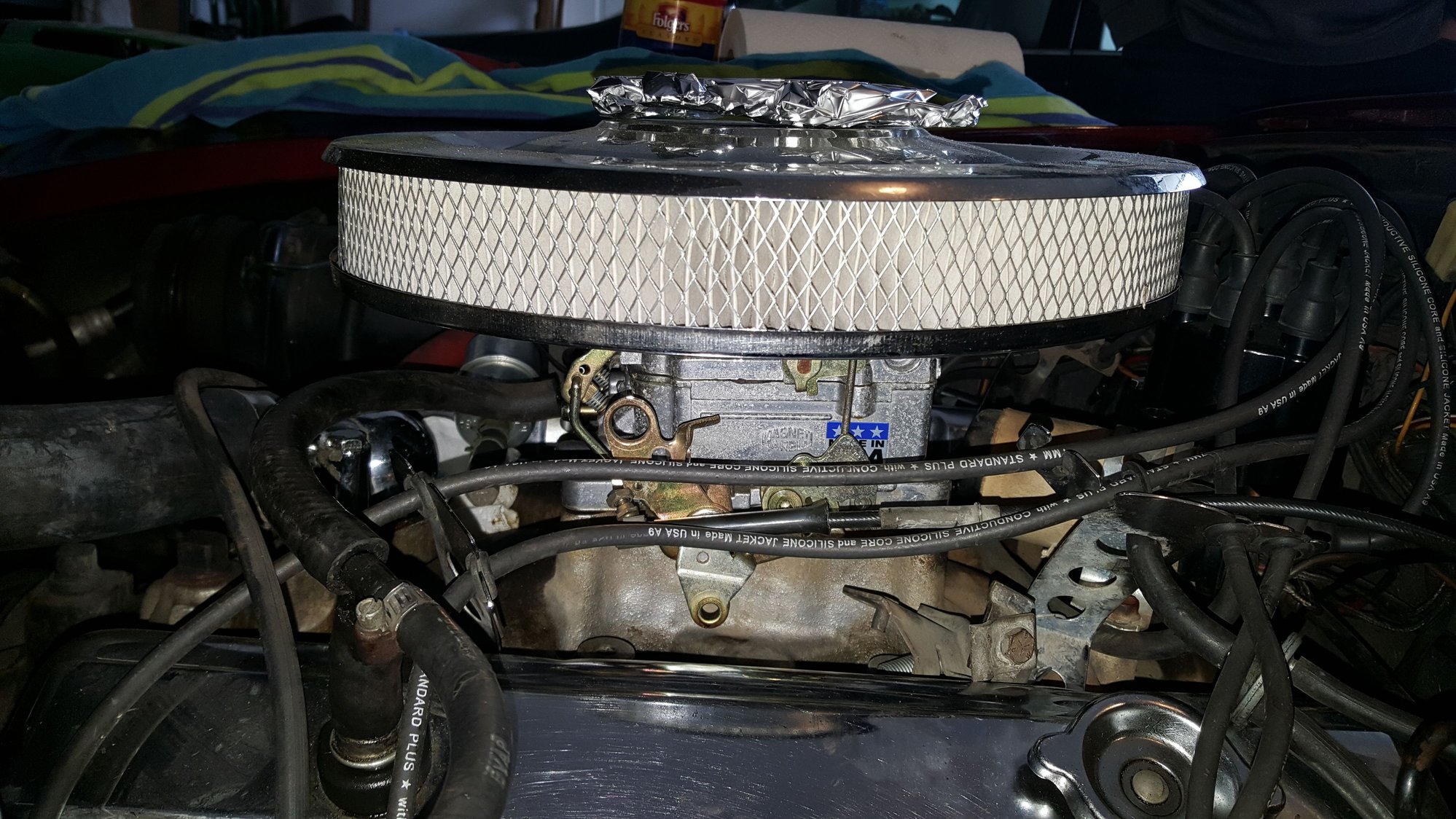

I pulled off the old Holley and set the 1406 on my intake. I put on the same Edelbrock drop base that I used with the Holley and it just cleared the electric choke. With a 3" filter element, I couldn't even close the hood. With a 2" element I could close the hood. To measure clearance, I put a aluminum foil ball on top of the lid and closed the hood. It flattened my aluminum foil ball to 3/8".
Looks like my options are to doctor a deeper drop base like Resue Rogers or to just rebuild the old Holley (that ran fine).
