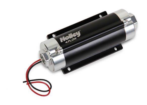

I switched to a Holley billet inline fuel pump after running a mechanical race pump for 8 years.... I'm super happy with mine. They are a little pricey but work well and are very quiet. With the engine running, you will not hear it.
http://www.holley.com/products/fuel_...s/parts/12-800
