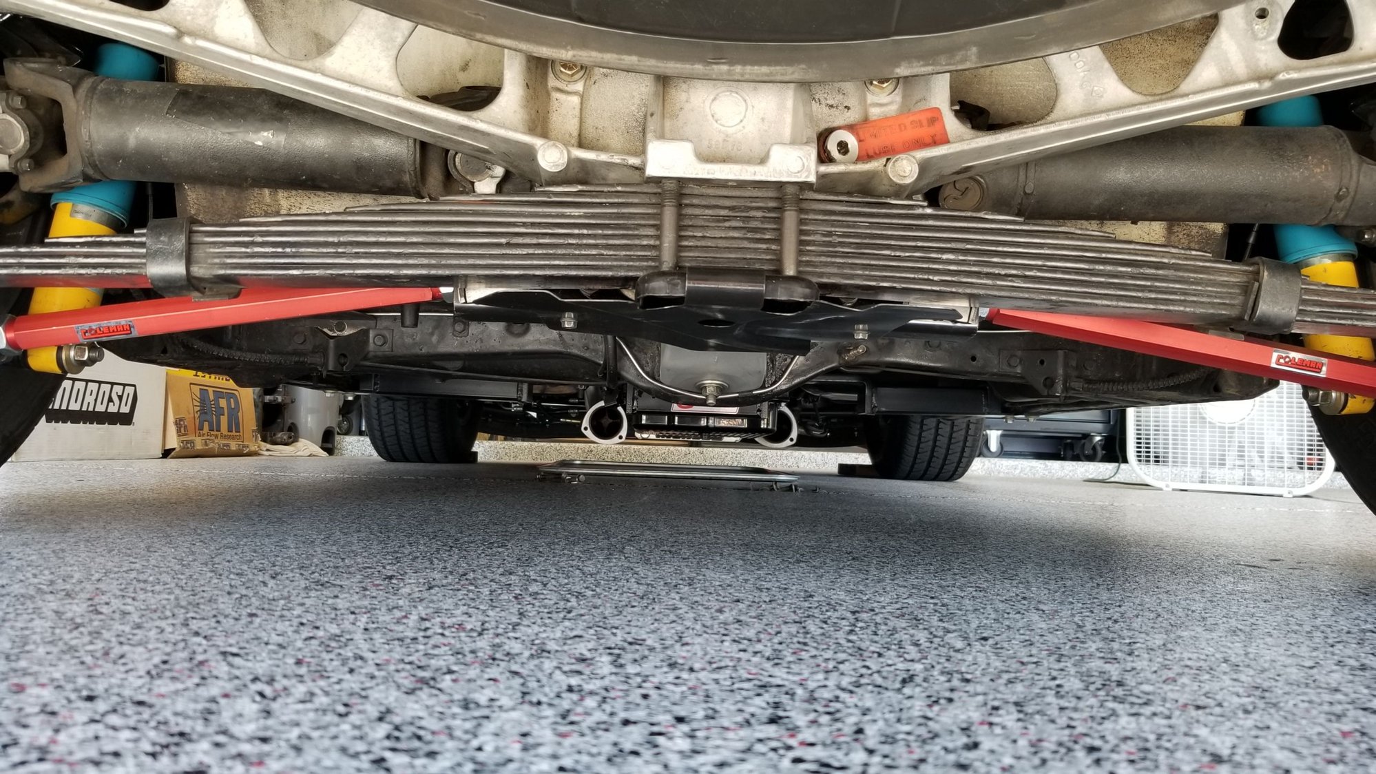

This isn't answering your question, but unless you want to keep the stock look, I would go with the heim joint mod and be done with it. I recently did mine and should have done it years ago. The car feels so much more stable and planted now. Extremely easy to adjust and it won't shift after you lock down the nuts.

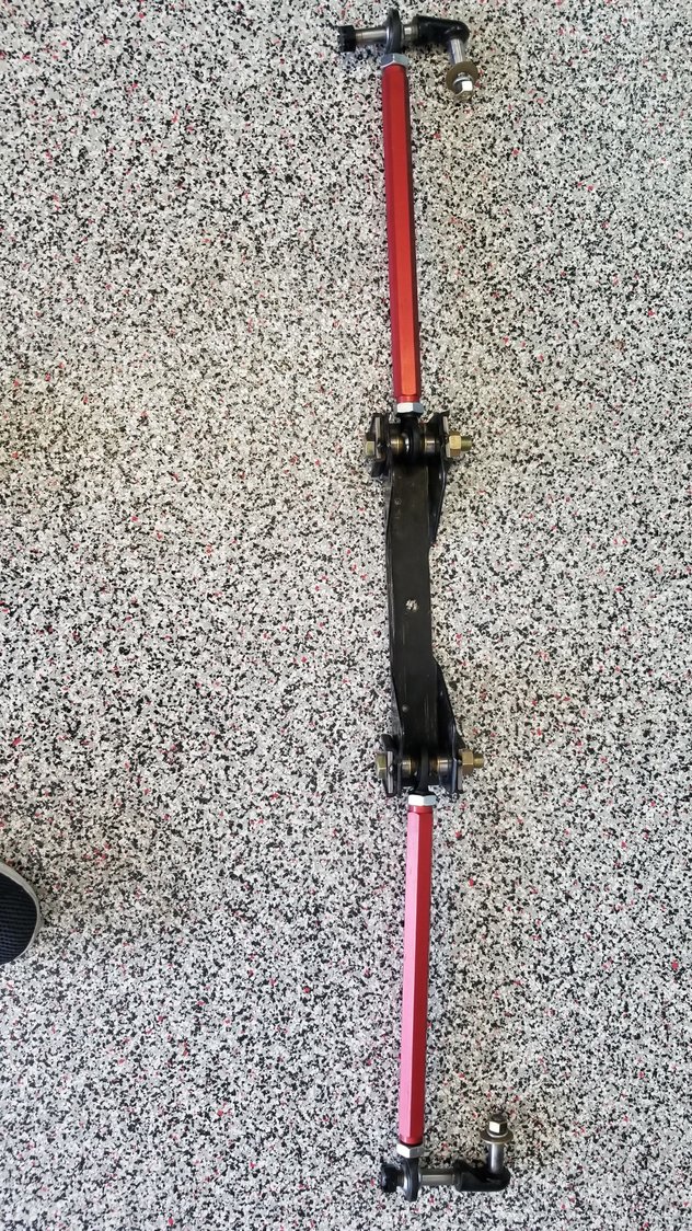

These are what I use and were referred by BigBird I believe it was, (see link below) not entirely sure on the member now. I used the 13" and works perfect. The heims are from I think Aurora. I did mine a little different than most on here. The shock end has to be 5/8", but the inner end to diff is only 1/2". I couldn't see using a 1/2" bolt, so I had my machinist make the shim stock to fit perfect along with heim beveled shim for rotation and then made the "C" channel diff bracket accommodate a 5/8" bolt. Works perfect and used grade 8 bolts on everything. You can buy the heims at various places including Speedway racing and the all the parts needed. I also used chrome moly heims, 3/4" thread and 5/8" hole on both ends. Hope this helps.
Strut Rod
You will also need a left and right hand heim, use whichever type you like, Speedway sells them also.
Here are the jam nuts also from Speedway:Jam Nuts
Here is the PN for the cone spacers I used with 5/8" hole, both ends of rod. Cone Spacers
