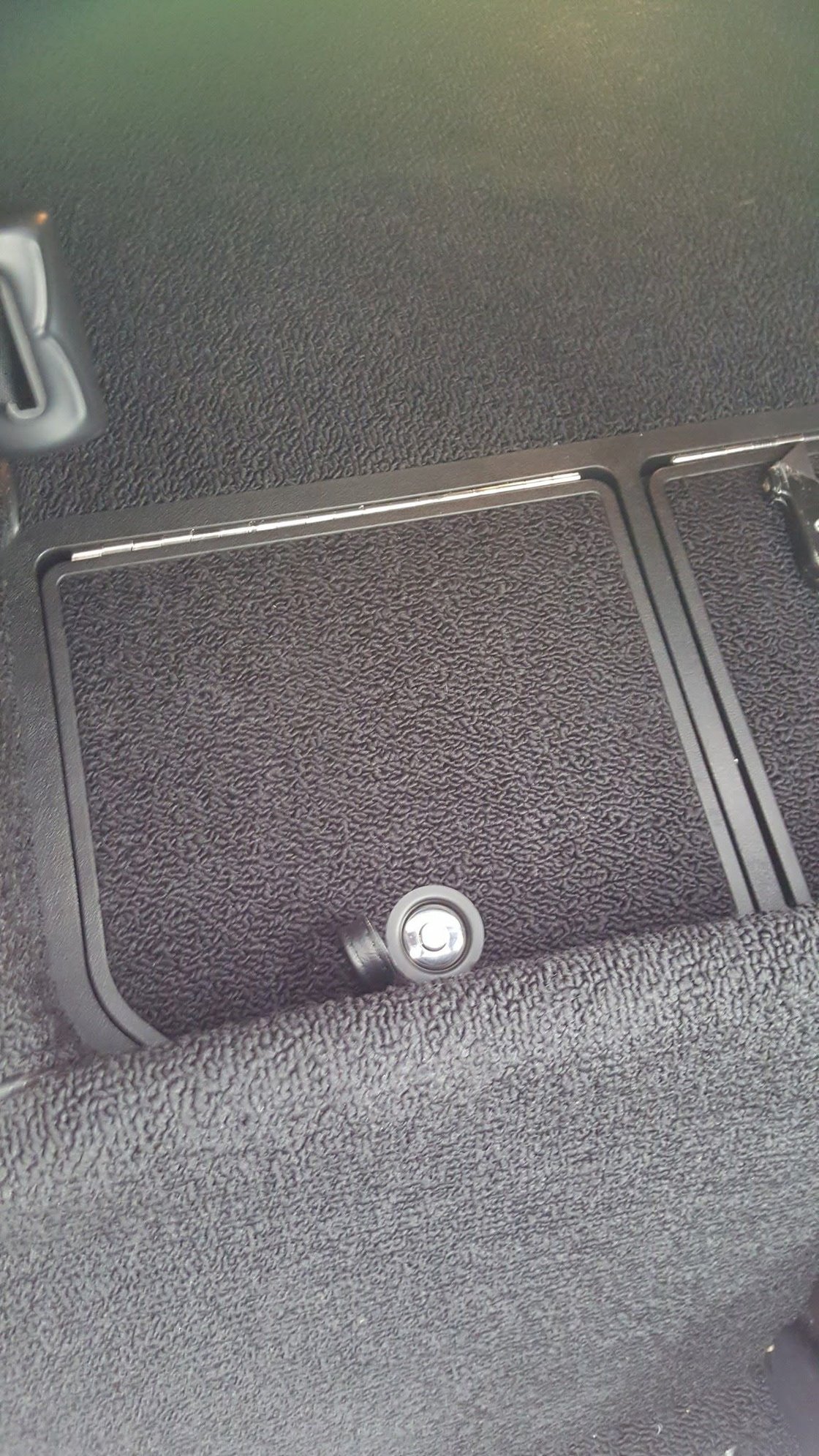

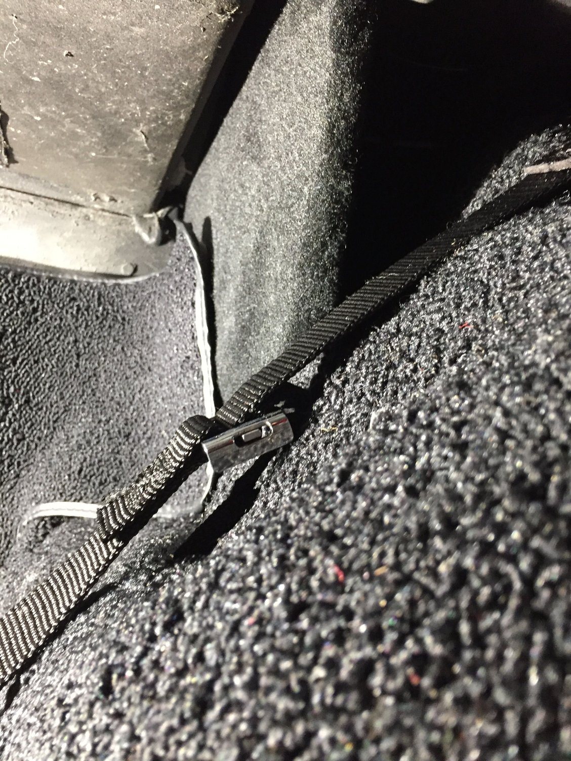

Not sure if anyone out there wants an upgrade stereo with a little sub, speakers in the rear AND no use of any very needed space for t tops, rear window and luggage?
later this week I’ll post a pdf if the template I cut for the rear speakers. The template kinda shoves to the back into that cravas back there. PLUS added bonus the sub seems to fit under passenger seat!! More updates as they unfold.

Default Rear window stowage operable.

Does that sub fit under the seat without modifications to the floor? How much room is there actually under the seats?
Kael

Thanks for posting this! I made an enclosure myself that *should* fit in the back without interference for the rear window tray but if not, I am absolutely borrowing this idea! Nice, clean work and thank you for sharing!

Ok the template is made to be printed on 8 ½ x 11 standard paper.
There are 4 pieces you will tape together after printing. The pdf is actual size so when you print it do not (scale) or( make it fit)
Just print 100%. After printing you can check the 1” mark i left for you. Tape all 4 together and cut out of 3/8” plywood.
Once the material is wrapped to the front and back it will make this piece even thicker and tighter in that cravas in the back of the vette.
I noticed if you put the speaker in first ( and it’s to low and it’s to big) it become almost impossible to slide this in. Rear window storage tray
will work nicely, but not if your speaker sticks out much..Remember hand built cars, so not all the same, you may need to tweak..
Kael
Yes!
