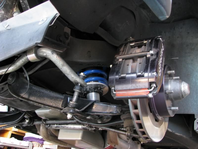

Do you happen to have any pictures of your setup?
You can use the original plate as a jig for mounting bolt holes and then you just tack up the caliper mounting nuts to get the final fit before welding the nuts in place.
