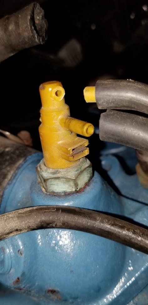

I want to clean up the engine bay by removing all the pollution crap. The cats have already been removed and it has a dual exhaust. An entire engine rebuild is planned for next year which will include headers, heads, cam, intake, new carb. My car has antique plates so no inspection of any kind is required in Pa.
While taking off the carb for a rebuild, I broke the switch pictured below. I guess I can use a plug when I remove that switch completely.
I am not sure what else I need to remove or how to remove it.
Any suggestions with pics or a good description would be appreciated.
Thank you.

you remove it by turning the nut on the bottom

LOL yes that's obvious even to me. LOL
I was wondering what else to take off besides this.

You can replace the water neck with one that doesn't have any ports. The vacuum switches are used to warm up the car a bit faster.
Figure out what to keep, and the rest can be removed.

You might already know this, but one of those two vacuum lines is the 'source', and the other goes to a vacuum activated device (probably either the air cleaner or a valve in the right side exhaust manifold). The device side hose can just be removed, but the source line needs to be plugged in some way - cleanest way is to trace the hose back and cap it with a rubber vacuum line plug (available in the Dorman/HELP product line at most parts houses).
If you have an AIR pump (I think it was only on California cars in 79), that can be removed (probably easiest to remove when you install headers, as the holes in the exhaust manifold would need to be plugged).
When you replace the intake manifold, you can choose whether you want to eliminate the EGR valve stuff.

Thanks I bought a bunch of caps and there is no AIR pump.

I didn't mean to be glib in my previous post, just brief.
A lot of the vacuum hoses under the hood are used for "emissions" systems that do nothing more than help the car warm up faster. This includes the valve on the passenger exhaust manifold, valve(s) on the air cleaner, and elsewhere. When figuring out what I needed to keep and what I could eliminate, I removed EVERYTHING, and put back fresh hoses only to the systems that I knew were needed.
My list:
PCV
Fuel vapor canister (two hoses, one a ported "signal", one Tee'd to the PCV)
Vacuum advance on distributor (manifold)
Power brakes
Headlight actuators
You may also want to preserve the vacuum controls on the HVAC system, but I blocked those off on my car.
Autozone of all places has some good images:
https://www.autozone.com/repairguide...00c15280083688
as does your shop manual. Search here, or elsewhere on the internet, figure out what you do and do not need, and make an informed decision as you pull sfuff off.
Good luck!
