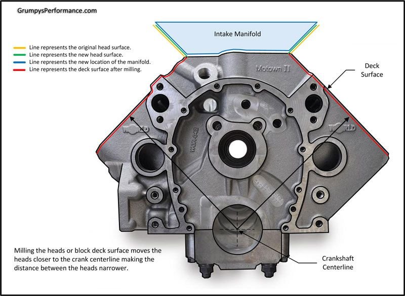

In addition to above suggestions ...
You mention fresh rebuild with "full motor machining"
if block was decked ( and depending on how much)
and
if heads were resurfaced/milled (depending on how much)
it can & does change the fit relationship between intake and head
if only a little difference, some RTV will usually solve it & seal it.
but depending on how much that angle has changed, the intake must be milled to fit (or the intake gasket cannot seal & will leak)
see the table
https://www.crankshaftcoalition.com/...cylinder_heads
if the heads were "angle-milled" that further compounds the bad fit.
all that depends on how much was milled off decks/heads.
