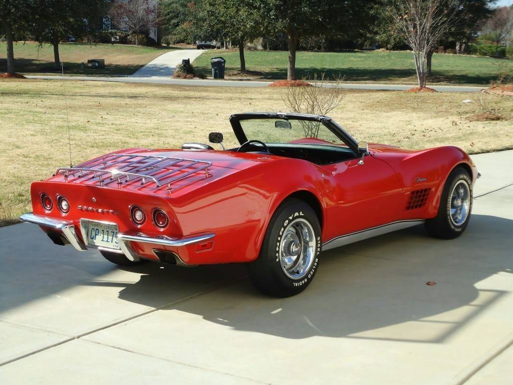

Yep....don't think the wife will hold the tire for me. This might be a good reason to put that chrome luggage rack on I have been thinking about. I can also use it for the car run chairs and a small easy-up.
Redvette2
Example only...not my car.

That does look nice.
