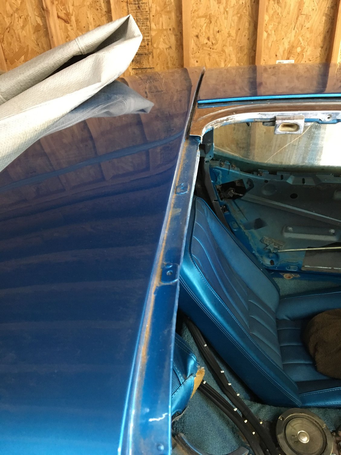

Help, do these go on a 1969?
Old May 27, 2019 | 03:50 PM
1969 for 50 years's Avatar
1969 for 50 years
Joined: May 2018
Posts: 93
Default Help, do these go on a 1969?
Old May 27, 2019 | 04:11 PM
62corvette's Avatar
62corvette
Joined: Nov 2004
Posts: 5,253
Likes: 768
From: Waterford WI
They do. Top of each door,inside the upper outer lip. The “whiskers” press through these into the door top openings.
Old May 27, 2019 | 04:36 PM
1969 for 50 years
Joined: May 2018
Posts: 93
Thank you very much! Checked and fit perfectly. I feel something is missing here.

On a 69 ? Yes there is a heavy duty cast alloy piece that's chrome plated and sits under the centre piece and goes out and down the side curve. It's high enough to form a seal on the Targa top.Also creates a water drain gutter that steers it away from falling inside the cockpit !

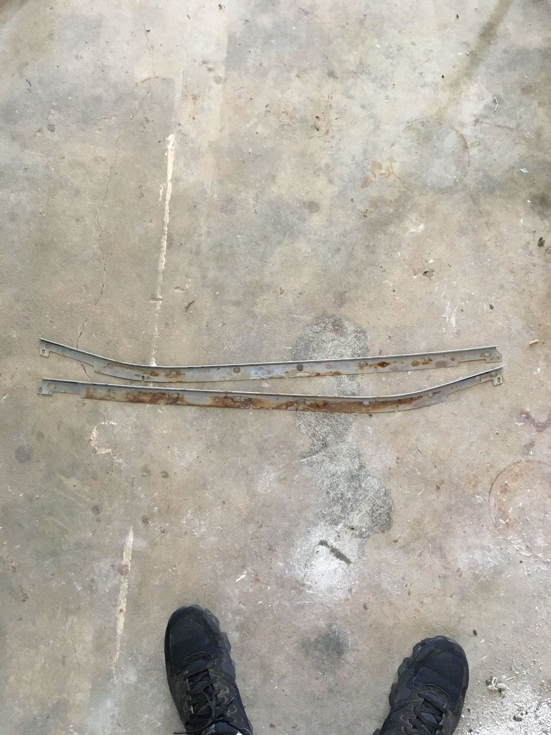

I am afraid I am missing those pieces. I will look some more. Would you have a picture?

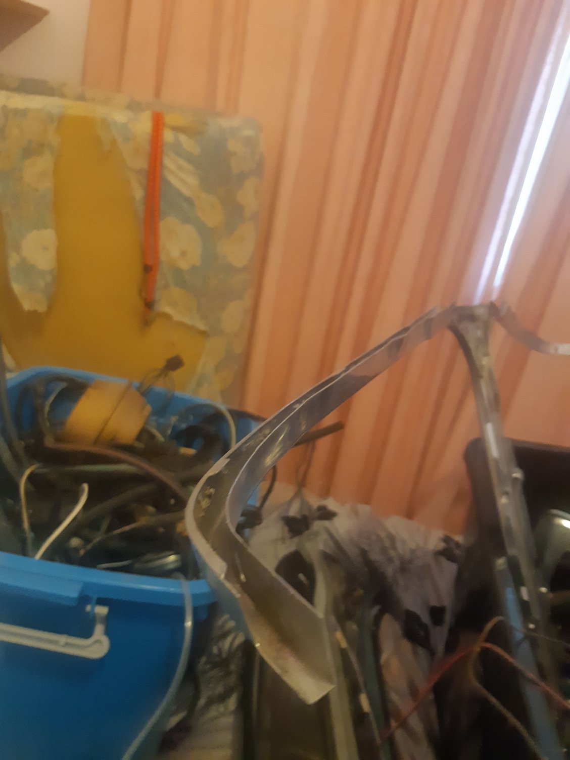

Ok the Wilcox diagram is for 1970 onwards , the 69 had a stainless steel trim pressed in to a shape but with the back end open.
Here's a bad picture of mine off the car
they are still rivetted onto the centre section .

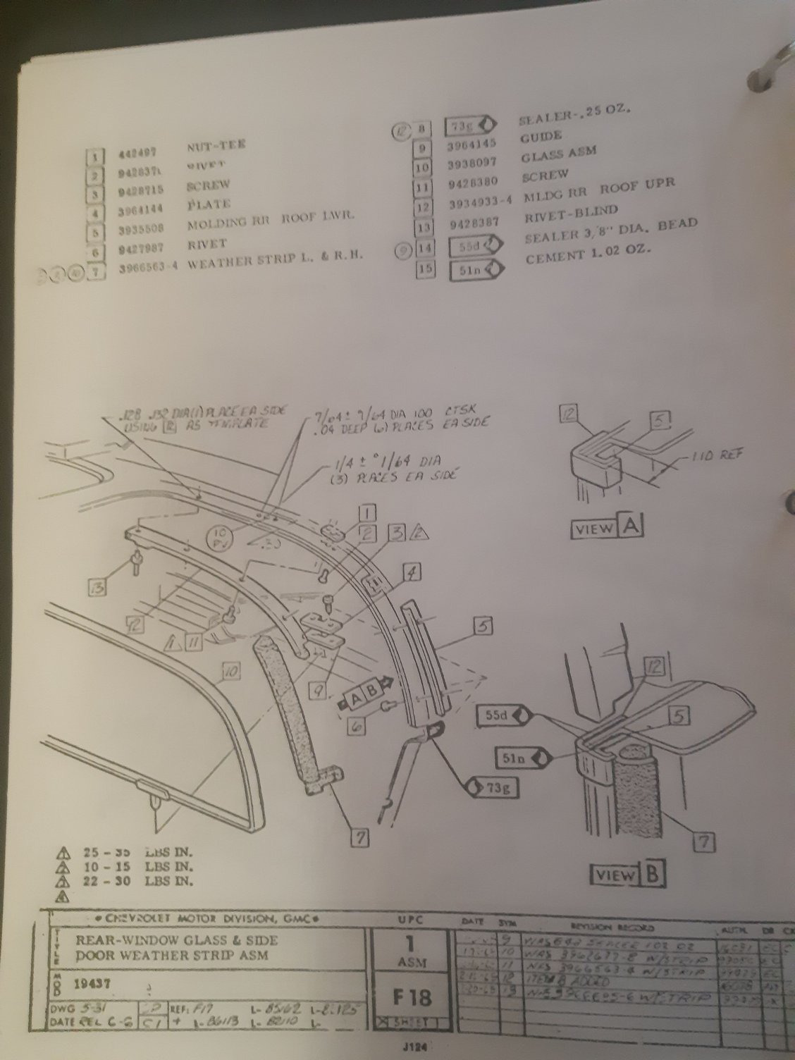

Ok I found the 69 page in its AIM.
It's got the correct part number to help you id it.

have you got the targa lock down pieces that go up along that edge ?

I will have to look. Do you have a picture of those?
