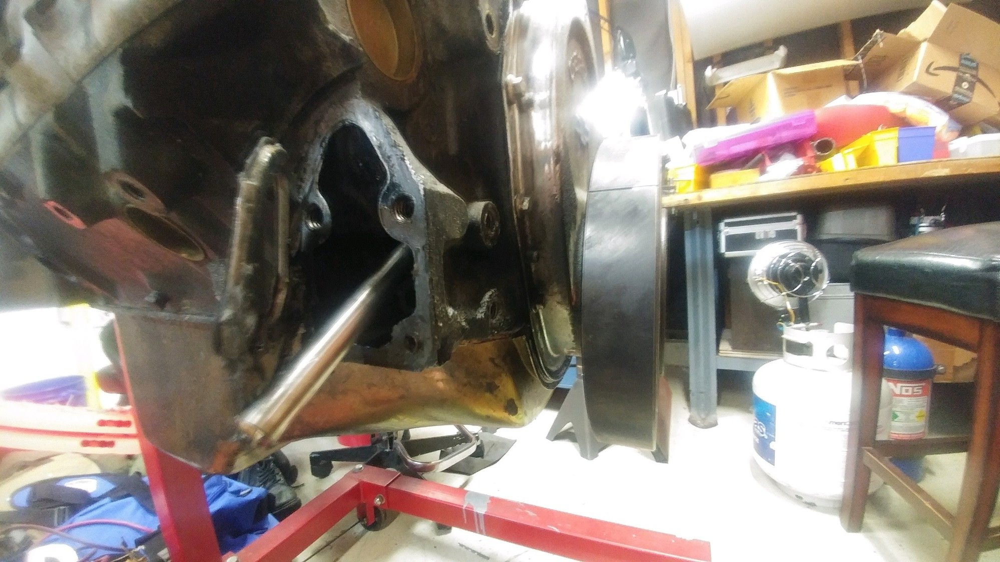

Let's switch gears here and talk about the installation. When putting in the fuel pump into the block, you've got to make sure the push rod is going to come back down right on top of the fuel arm. Because the push rod can lay down at an angle in that area (if some of you out there think I'm wrong on this, please chime in!). I've used heavy grease to hold it in it's highest position and I've also done a quick 'hold the rod end with your finger, shove it up and stab the pump in' method, hoping that I did it right (I did and it worked, but there were doubts... A good suggestion from someone here was to use the dipstick to hold it in the correct, all the way up position, because it's so thin. Then letting the rod come down on the arm. It could be that the pump you have is defective.
Here's a pretty good description that I wasn't aware of, on installing a fuel pump and keeping the rod in the upper position
REMOVAL & INSTALLATION
  • Disconnect the fuel intake and outlet lines at the pump and plug the pump intake line.
  • On small block V8 engines, remove the upper bolt from the right front mounting boss. Insert a long bolt (3/8 in.-16 x 2 in.) in this hole to hold the fuel pump pushrod.
  • Remove the two pump mounting bolts and lockwashers; remove the pump and its gasket.
  • If the fuel pump pushrod is to be removed from V8s, remove the two adapter bolts and lockwashers and remove the adapter and its gasket from small blocks and remove the pipe plug and pushrod from 454 cu. in. engines.
  • Install the fuel pump with a new gasket reversing the removal procedure. Coat the mating surfaces with sealer.
  • Connect the fuel lines and check for leaks.
I just went out and took a picture of the block that I pulled that ran the old mechanical fuel pump. The long bolt method bolded above seems to do the trick. I used a drill bit to push against the fuel pump pushrod and indeed, it did hold it in it's upward position. Gently tightening that bolt against it, as described above would do the same thing.
Forgive the blurry pic, but the natural tendency of this pushrod is to drop down to it's lowest position and most of us, don't want that to happen when putting in the fuel pump (not sure if you had considered that or not, but let's cover this anyway, because the bolt method is pretty neat, versus the dipstick or finger-stab method.
Fuel Pump Pushrod dropping by itself.
Fuel Pump Pushrod, held in upper position with pressure through the front boss hole on engine block.
To Erratic fuel pressure
