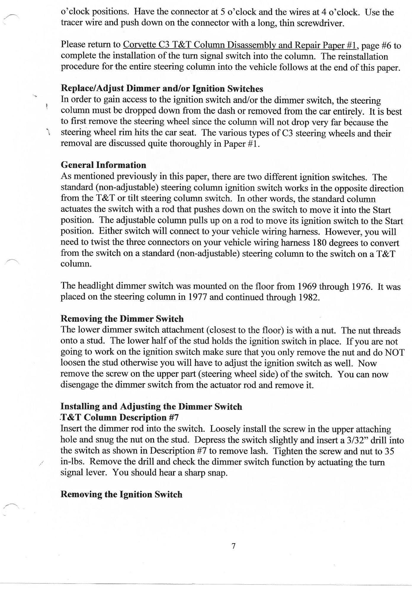

The answer might be in Mr. Jim Shea's papers.
http://jimshea.corvettefaq.com/?p=1017
'80 schematic:https://docs.google.com/viewer?a=v&p...DQ1MmZlYzIwNDI

Thanks for the reply. Jim's papers is actually where I discovered the fact the standard and T&T steering columns had different ignition wiring to the same connectors. Unfortunately the papers don't say or show which is which respectively. And the vehicle wiring diagram which I also have shows one switch wiring scheme but not the other. I could maybe assume that the diagram would be for a standard non-T&T steering column but I didn't wanna start plucking out wires before knowing for sure.

Time to get your test light working-- key off, where is the power? Key on, where is the power? T&T or standard column, the power goes in and the power comes out. And 99% of the time, the connectors will not plug in incorrectly. Compare the colors on the wires to the wiring diagram.

Let me ask:
You have an '80
Do you have a T & T steering column?
When you turn the key does the rod move in the correct direction?
What makes you think that the wires for the switch connectors are not in the right place?
